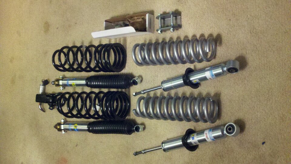

research more!!!! all kinds of lifts but looks like u want a mall crawler, i dont have a big boy lift myself but i just ordered this!!!!
