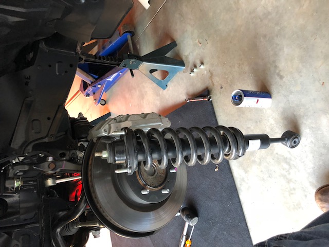

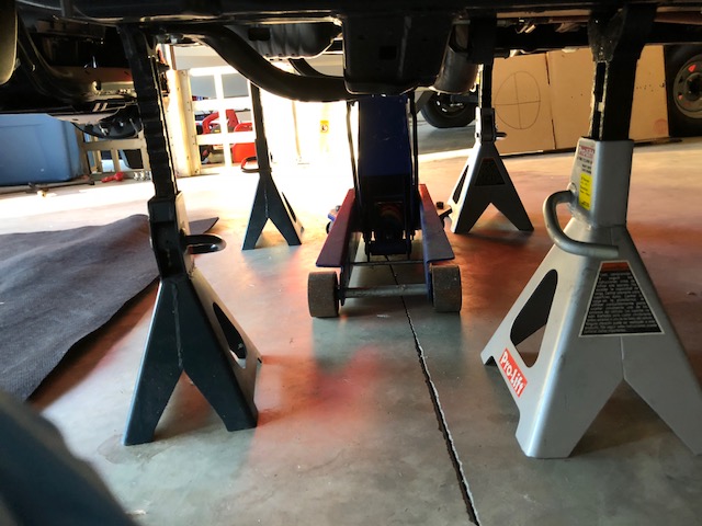

Just installed the 1" leveling kit on my 2016 TE (non-KDSS):
Did this by myself in 1 hour and 45 minutes from the time I took the tools out of the box to the time I put them back.
Hardest part was removing the 3rd coil-over mounting bolt closest to the engine. Just had to use an open-ended wrench with very short throws.
I unbolted the sway bar from both the frame and the bar link from the upper control arm.
Removing the coil-over by myself was tricky, but I rested my torso over the wheel hub and bounced a little and was able to get it free.
Very easy kit to install!

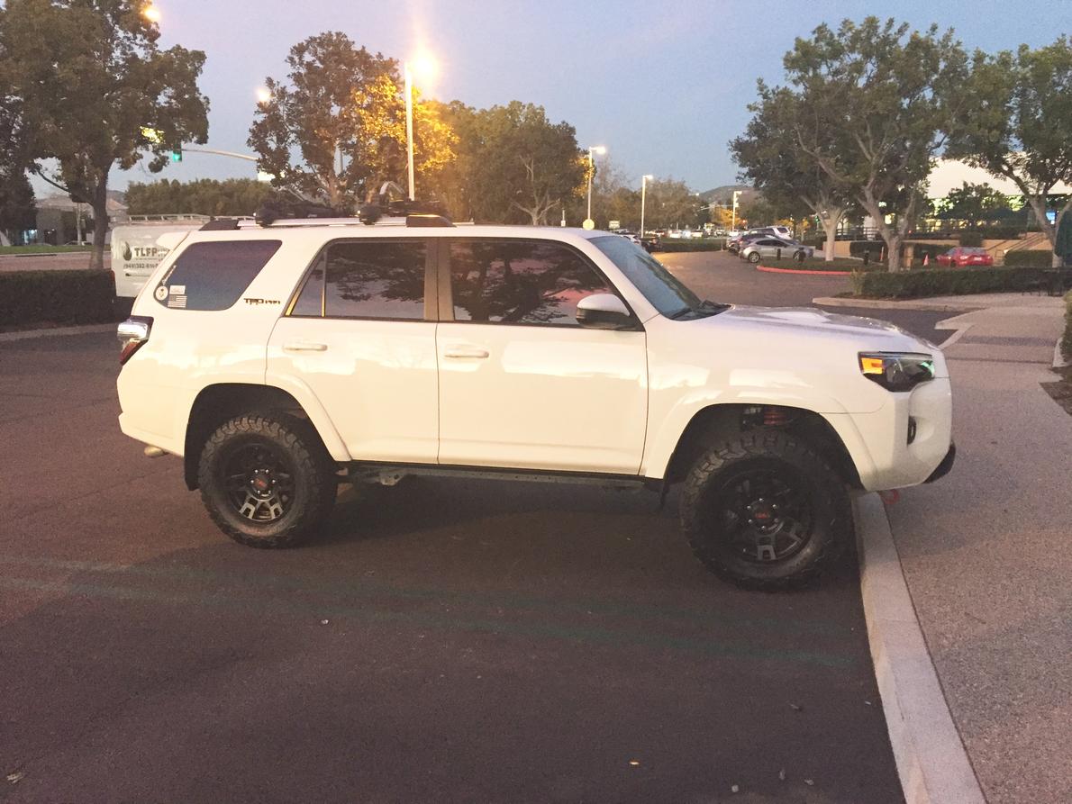

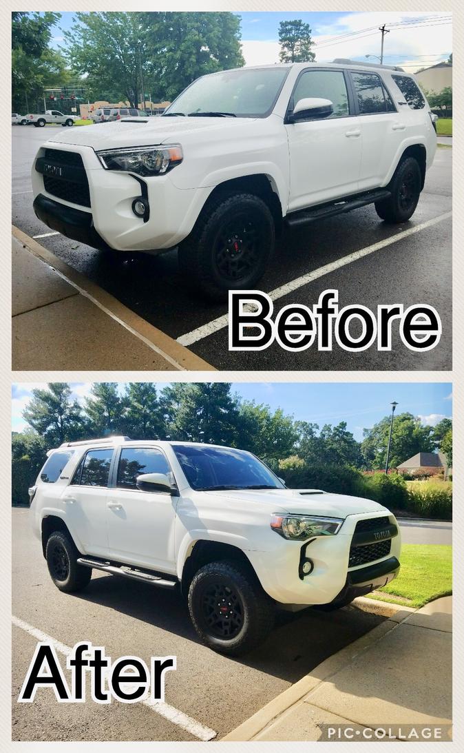

Just got my 1" leveling installed. Super stoked on the out come...
before and after:
MUCH much better.

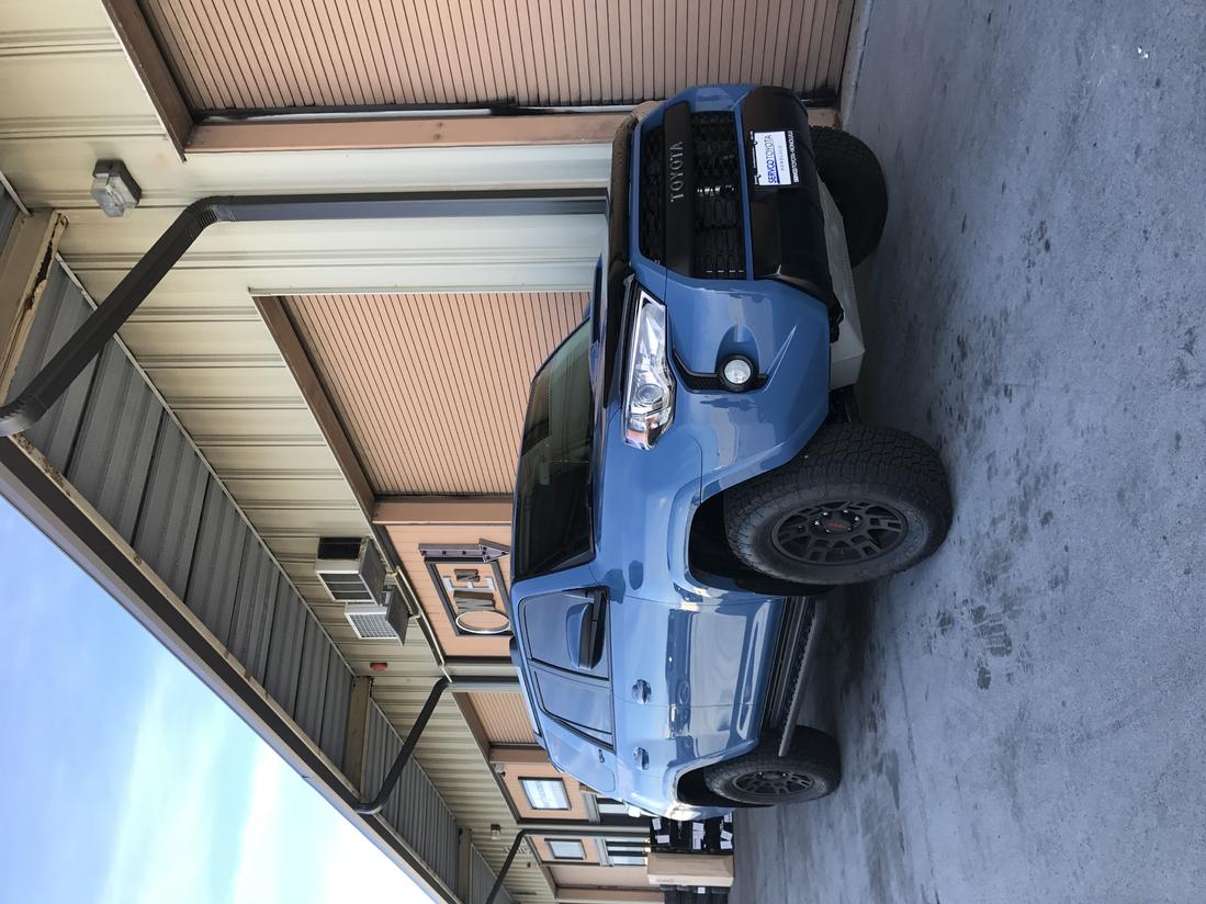

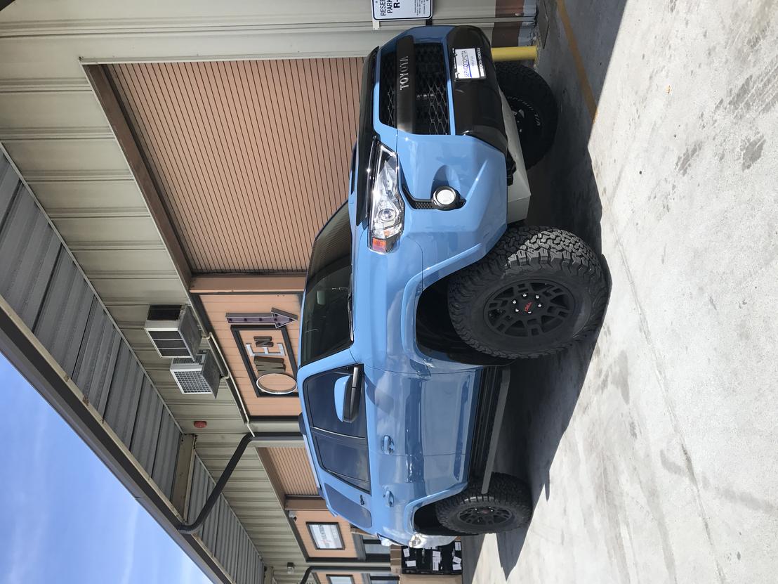

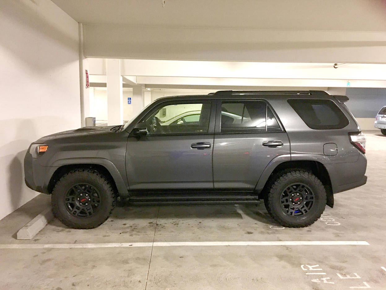

First two pictures are before stock TRD Pro. Last two is with 2.25/2 spacer with BFG KO2 285/7/17.
Stock:
35 3/4" Front
36 3/4" Rear
72 1/2" Top of roof rack
With Lift + Tires
38 3/4" Front
39 1/2" Rear
75 1/4" Top of roof rack

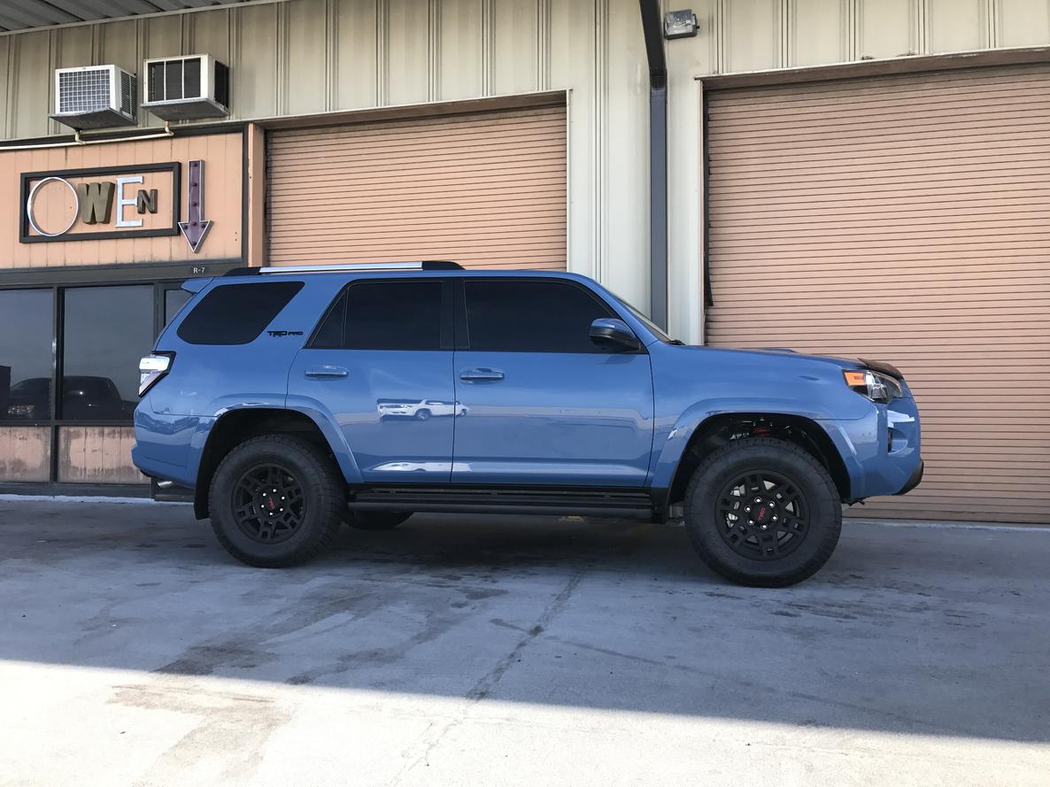

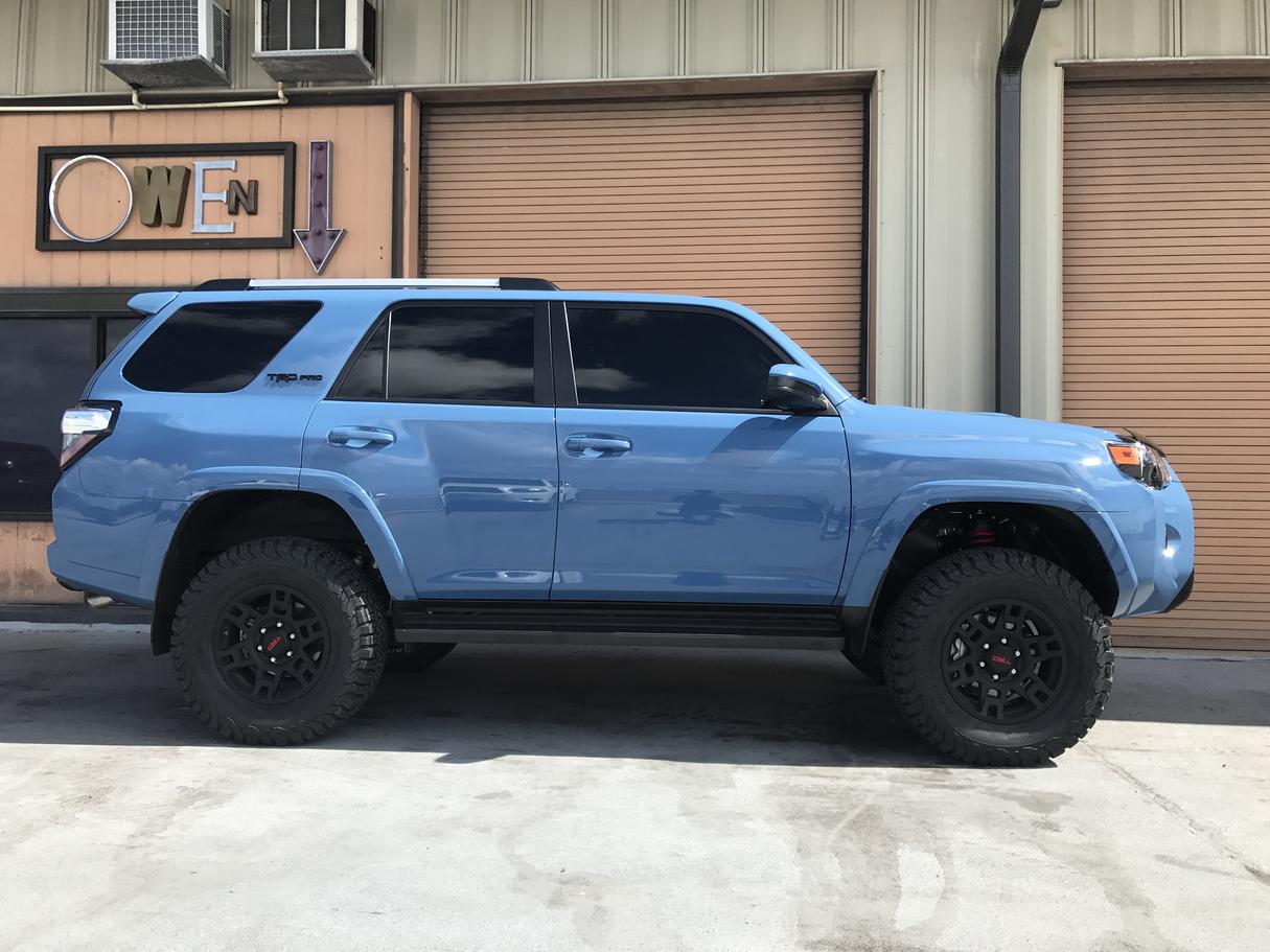

Here is my before and after with the 2"/1" level kit. 2016 TE, non KDSS. I like the look and should be plenty to clear with the Falken Wildpeaks 285/70 on the FN f(x) Pro wheels.
Black Out 4runner 2017

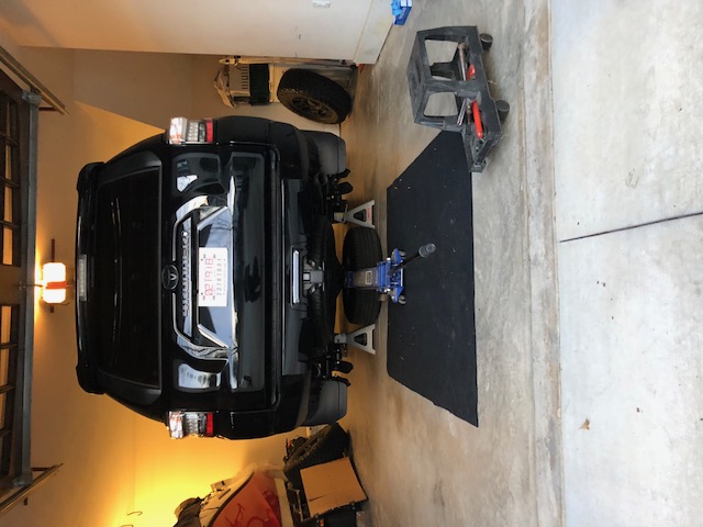

I purchased and installed the 2/1 leveling kit from https://www.burtmanindustries.com/zo..._03_up_liftkit.
I was able to perform a self install in my garage with ease. The first thing I did after install was to take a test drive and check the ride quality. Honestly, I am not able to tell any difference from the stock ride. Very glad I chose the 2/1 and super pleased with the install and ride.

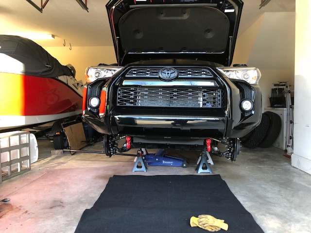

Install and completion pics
A few pictures from the install.
