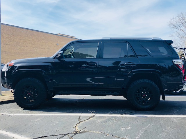

I purchased and installed the 2/1 leveling kit from https://www.burtmanindustries.com/zo..._03_up_liftkit.
I was able to perform a self install in my garage with ease. The first thing I did after install was to take a test drive and check the ride quality. Honestly, I am not able to tell any difference from the stock ride. Very glad I chose the 2/1 and super pleased with the install and ride.
Great pics and glad you like it. Other kits can give a rough ride from what I've heard, but this does not and ride just like stock.

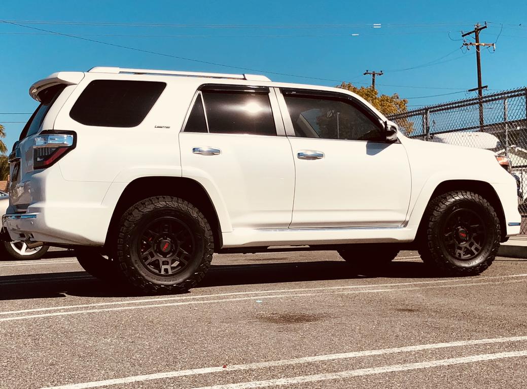

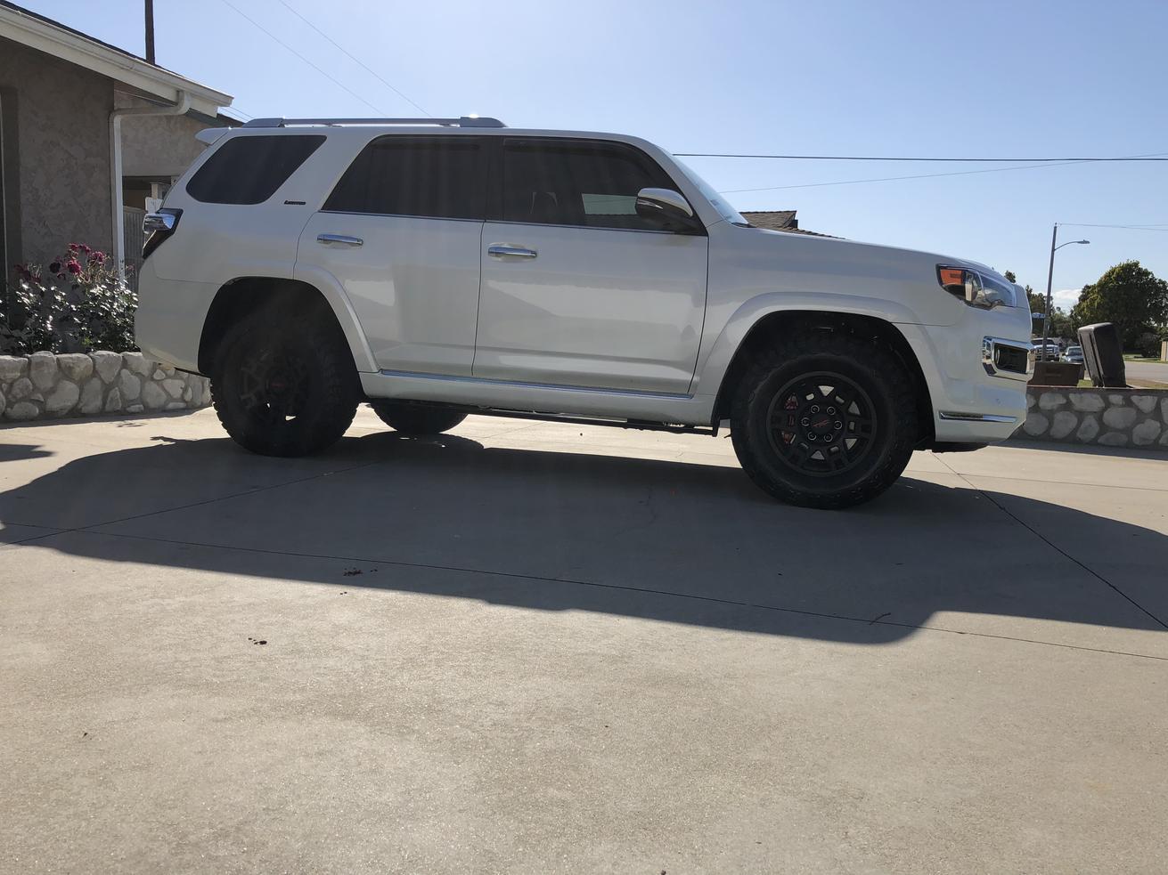

Would the 1” spacer for front level my Limited out? Equipped with XREAS.heres some pics. Rake drives me crazy!

From your pics, a 1.5" on your limited would level it. The way these kits are designed it to still have some factory rake, so when you have passengers, or have the back loaded, you would then be "riding level". If you just can't stand having any rake, then yea, the 1.5. Just keep in mind anything over a 1" leveling requires spring compressors for install. SO the 1" front's are the most popular, since they don't require spring compressor, but again, can make any size you want.

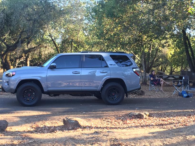

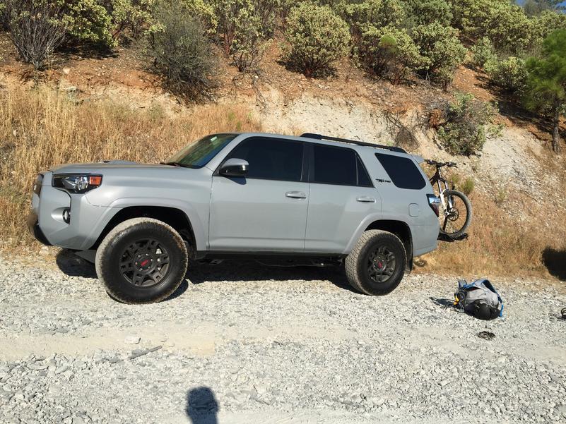

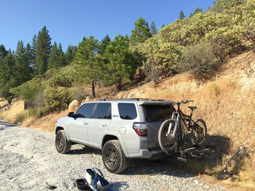

Love my 1” front spacer. A couple of pics. Will likely go with a 1.5/1 kit from Jason and 275’s when my stock tires need replacing
