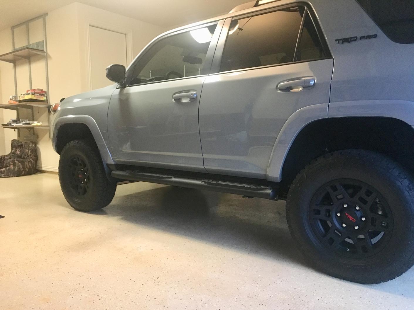

I installed Jason,s lift on my 17 pro due to the suspension, I’m not going to do major off roading so I didn’t want to get rid of what I had.
It was difficult to install it by myself but it took me two days after I got off work both days. The only thing I had to have help on was compressing the front springs.
I am running 285/70/17 Nitto Ridge Grapplers. I love the lift/ tire size. To me it’s a perfect combination.

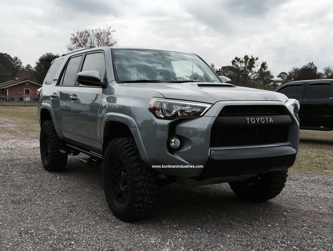

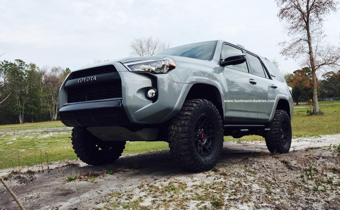

Here is another 2/1.5. Before is stock pic. Also, can make ANY CUSTOM SIZE you want.
