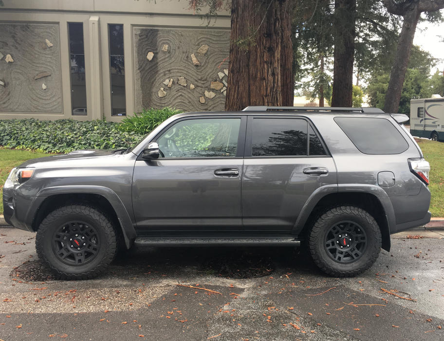

My wife(CoARunner15 on the board) and I installed the 2/1 kit on her '16 Limited. Absolutely love the look! After two days driving and getting an alignment, the ride is great and measuring from ground to fender we got 2.5" of lift up front. Anyway, here's some before and after pics. If anyone needs more, just let me know.
Those are great photos!!!
I would love to see more pics. Man, looks good! Nice camera too.

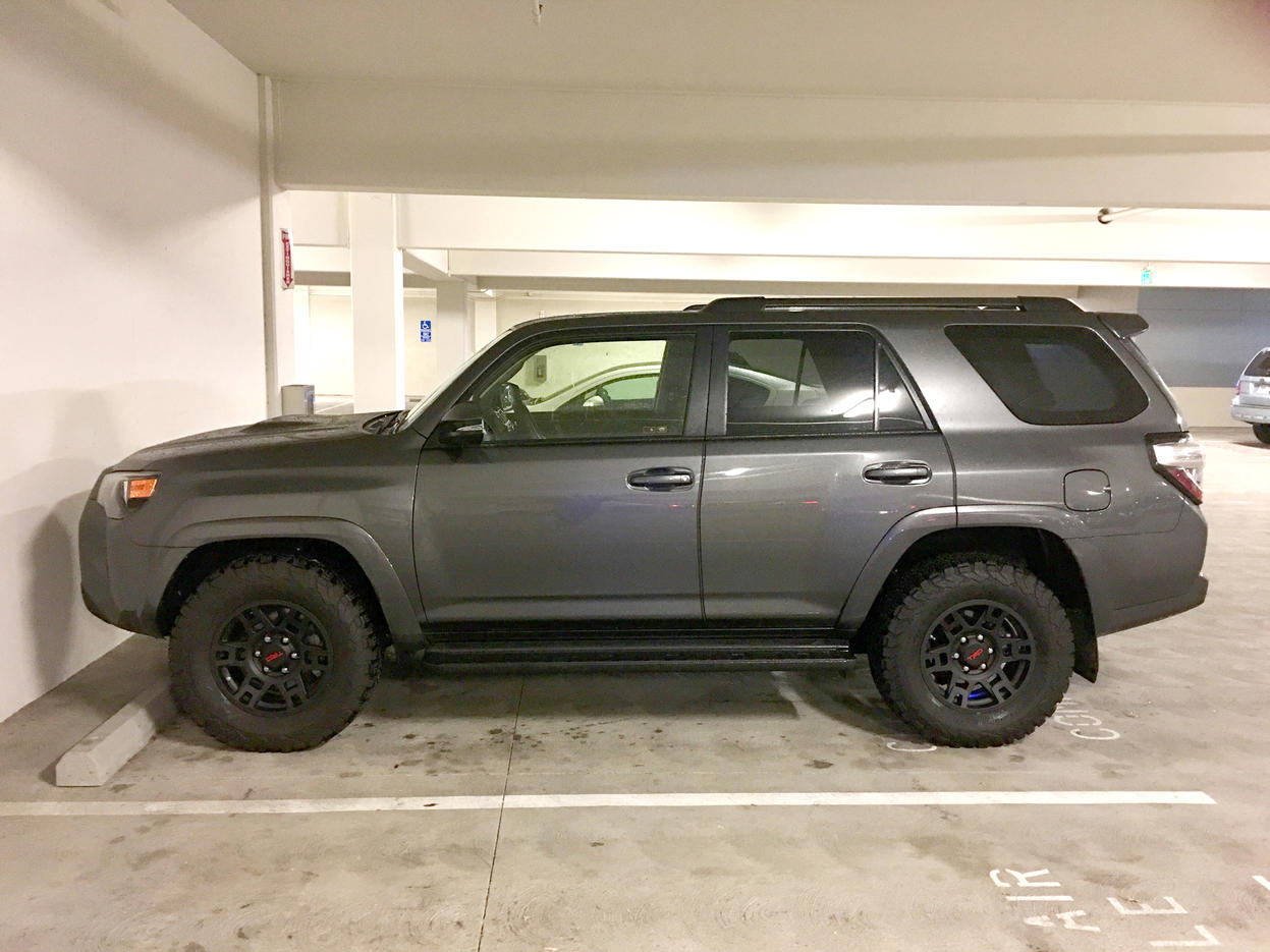

Anyone with a TRD Pro and 2/2 or 2/1 use wheel spacers w/ 285/70/17? wondering if they'll be any rubbing. I jus ordered the 2/2 for my pro and 285 KO2s and was thinking about spidertraxx

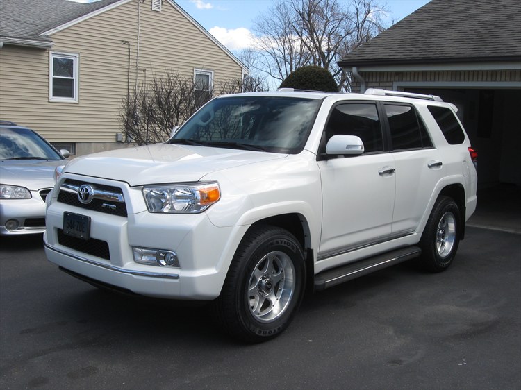

So are you saying that the 1" front leveling lift and 1.25" spacers can NOT be used with aftermarket wheels. Kind of confused as I would think it would not make a difference.
I currently have my stock 17" wheels with 1.25" spacers all around and going to install the 1" front leveling kit. But for the summer I have aftermarket 18" wheels that I would still want to run the spacers?
Aftermarket wheels are already pushed out 1" to 1.25" at least, so if you use spidertrax ontop of those aftermarket wheels, it's will be will have two sets of spidertrax and will rub on outside.
