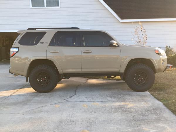

Here's my Pro with the CornFed 2"/1" kit and 285 17s. It came with all needed hardware. It looks like negative rake to me, so David at cornfed said I can swap the 1" rears for 2" for $30. Great customer service.

I hate to ask this, but do you have a picture that is more centered on the side of the vehicle (that one seems more up by the front quarter panel), and from the sunny side?
I have the 2/1 kit for my TRDP also (not yet installed). After lookinv at that pic, the wife and I also think it would look better with the 2" rear also!

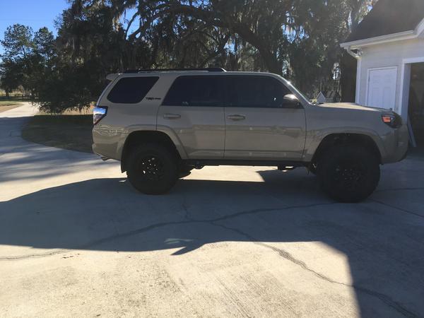

Here's a little better pic:

Sorry, I don't know what I'm doing wrong. You should be able to see it in my garage.
Found it!

Below is a pic of ResqPink's truck with a 2/1 kit. My eyeball says the rear fender still has slightly more space above the tire than the front. But, he still identified that truck still just appears on the whole to be slightly leaned back.
A 1.5" rear lift should offset that look, and going 2" should maintain the factory rake.
When I look at a vehicle, I think my eyes go to the rocker. As you can see in my pic, the wheel openings look pretty level, but the rocker looks slightly negative. I guess different people just key in on different areas.
I see what you mean about the rocker but overall it looks pretty level to me, especially if you look at the wheel wells and the bottom of the windows. Parked on level ground, I wonder what a level would look like on top of your roof rail...
Looks awesome BTW thanks for adding the pic.
I'd never really looked at the roof rack, but it does look just about perfectly level there. As I said, though, this thing is going to be loaded down for much of it's life, I don't want it looking "squatted" when I put a couple of people, dogs or gear in it.
