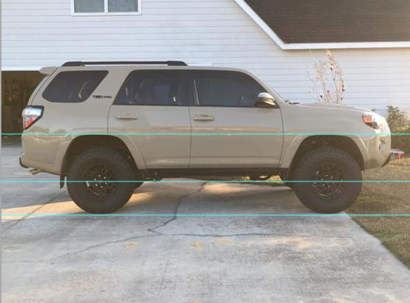

Leveling the picture and adding straight lines can help...
looks pretty level to me. Although looking at the rocker I do see a variation, higher towards the front than the rear.
Your driveway angle and such maybe making the offset look exaggerated.
When I look at a vehicle, I think my eyes go to the rocker. As you can see in my pic, the wheel openings look pretty level, but the rocker looks slightly negative. I guess different people just key in on different areas.
Great job on the photo. Thanks. I see the reverse rake on the rocker panel. Didn't stand out as much until the lines were drawn. I'm going to find a perfectly level spot and take some measurements, not just of ground to fender, but ground to rocker panel. I may even put a level on the frame... With all of that said, I don't mind a regular rake since I will have bikes, kayaks and gear putting greater load in the rear and I want it at least level after that is done. My initial measurements from ground to fender shows the rear 2 1/8" higher. In theory, after a 1" front lift (1/2" spacer) it should still have a 1 1/8" standard rake. I think that should work if my loads don't pull it down more than an inch...
