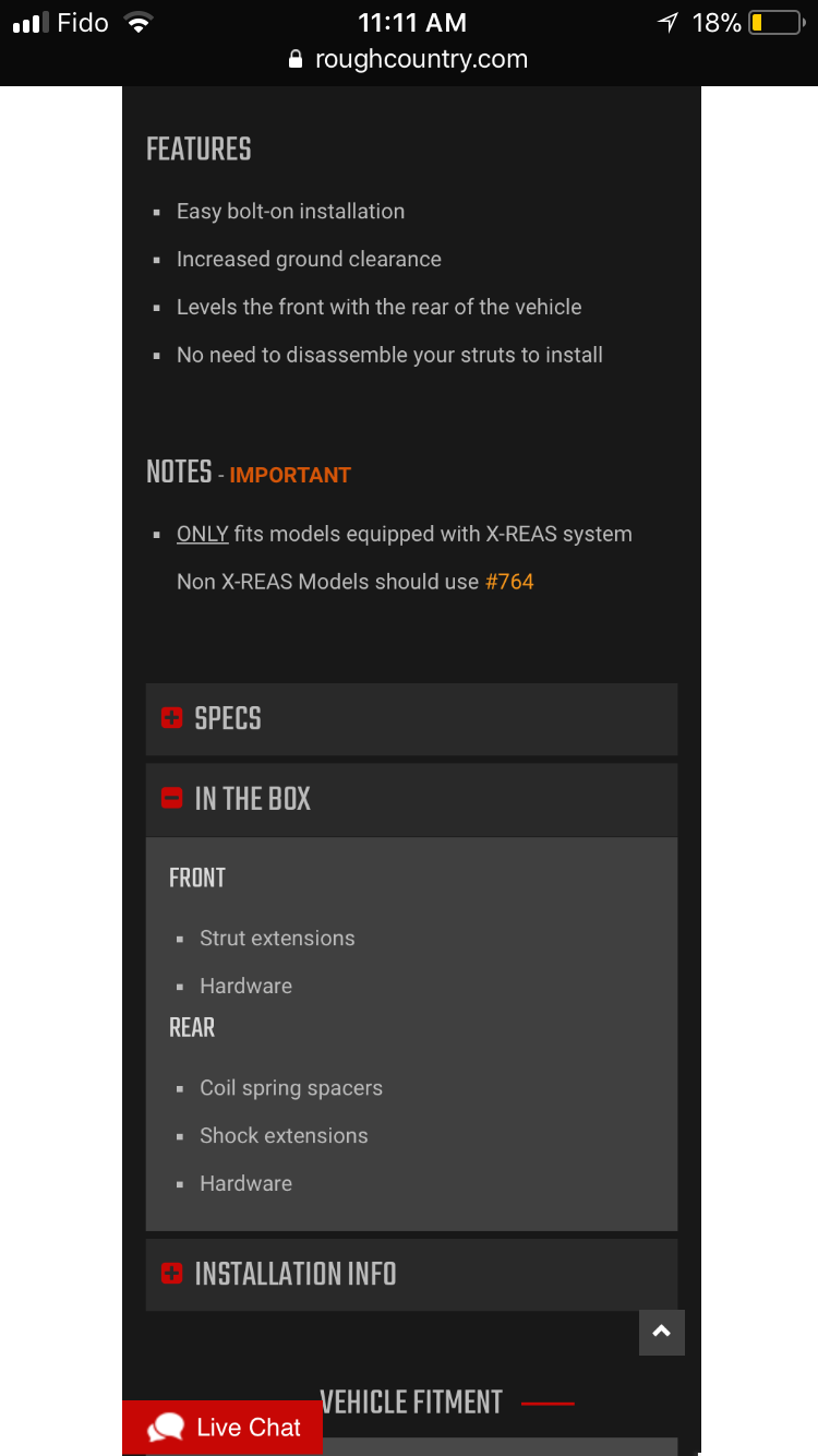

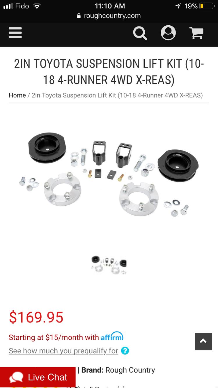

Hi!! I read this thread and help me a little bit to figure out my problem but i cannot make my mind. I dont know suspension and lift kit very well. (If u want full explanations, go read my thread and answer me if possible and if you can help me.)
So a shop install a X-Reas leveling kit on my KDSS 4runner and I wanted to know if its ok to run with it? Did it damage something on kdss or my suspension? What are the consequences of running with this kit?
The shop installed it without any problem (at least,thats what they told me) and the 4R seems to run normally... but it is ok to run with it? Thank you!!
