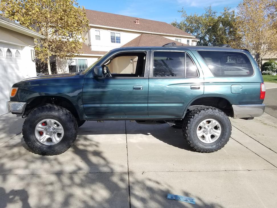

I'm probably going to go the OME springs w/ OME shocks with an upgraded upper control arm to address the camber. My goal is similar to yours... mostly on road but I like to go off road periodically.
4runner Bilstein 5100 front shocks.
FJ Bilstein 5100 rear shocks.
ToyTec 3" rear coils.
OME 2881 front coils.
Front 5100 are on the bottom(no added lift) perch.
17x8.5" Et-6 Fuel Recoil and 285/70R17 BFG KO2.

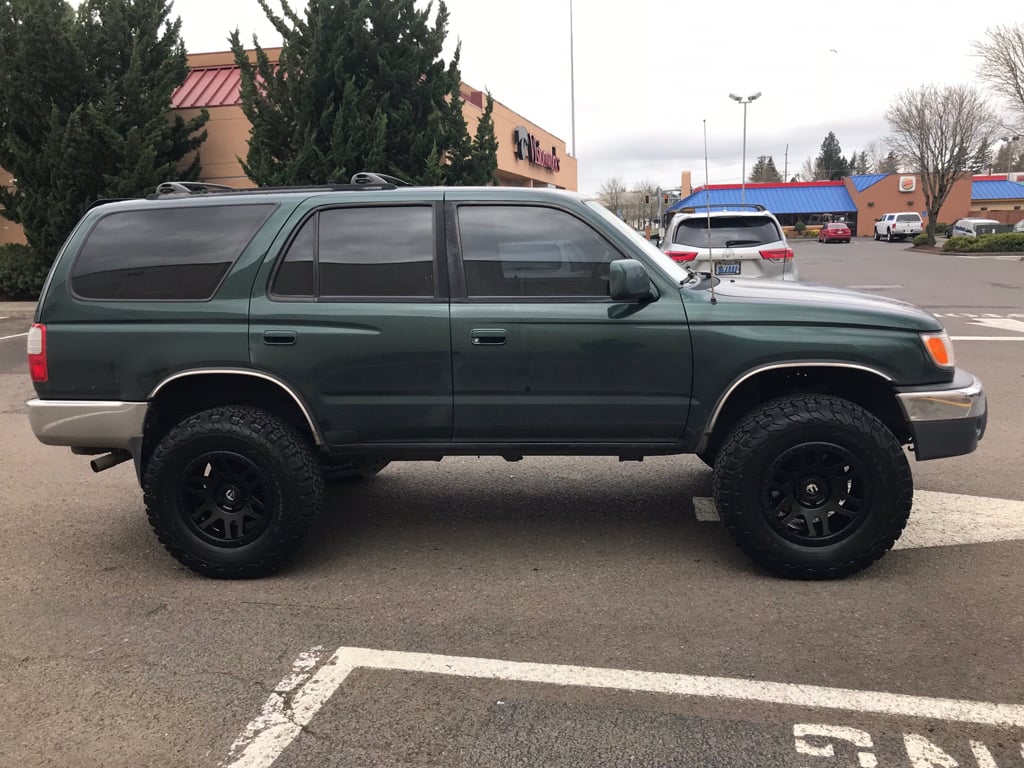

Front-
Tundra 5100 on perch 4 of 5.
Stock '99 4Runner Highlander coils.
About 2.25" lift.
Rear-
ToyTec Superflex(3.75" lift) coils with center bumps removed. About 3.5" lift.
FJ 5100 rear shocks.
315/70R17 BFG KO2 on 17x9" et0(5" BS) Level 8 MK6.

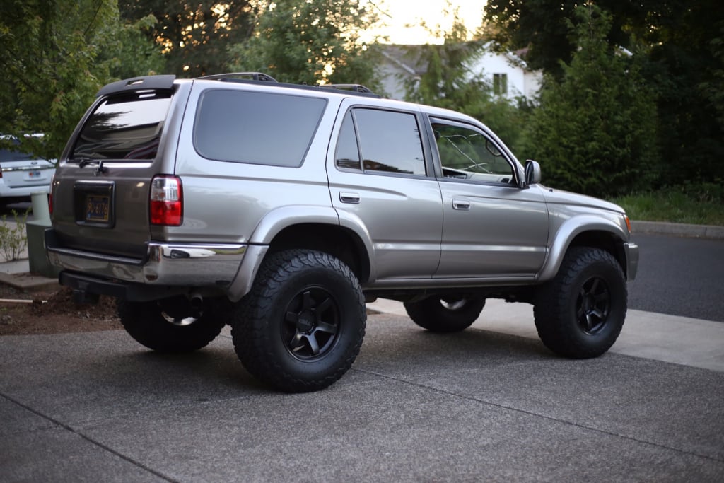

I pieced mine together with springs and shocks from Wheelers instead of buying a "kit". I have 285s and needed wheel adapters to run them. They rubbed horribly. I think I have less than $1K in my lift and the ride is great for what it is.

did they rub horribly before or after adding the adapters. thinking of going 285/70/17
