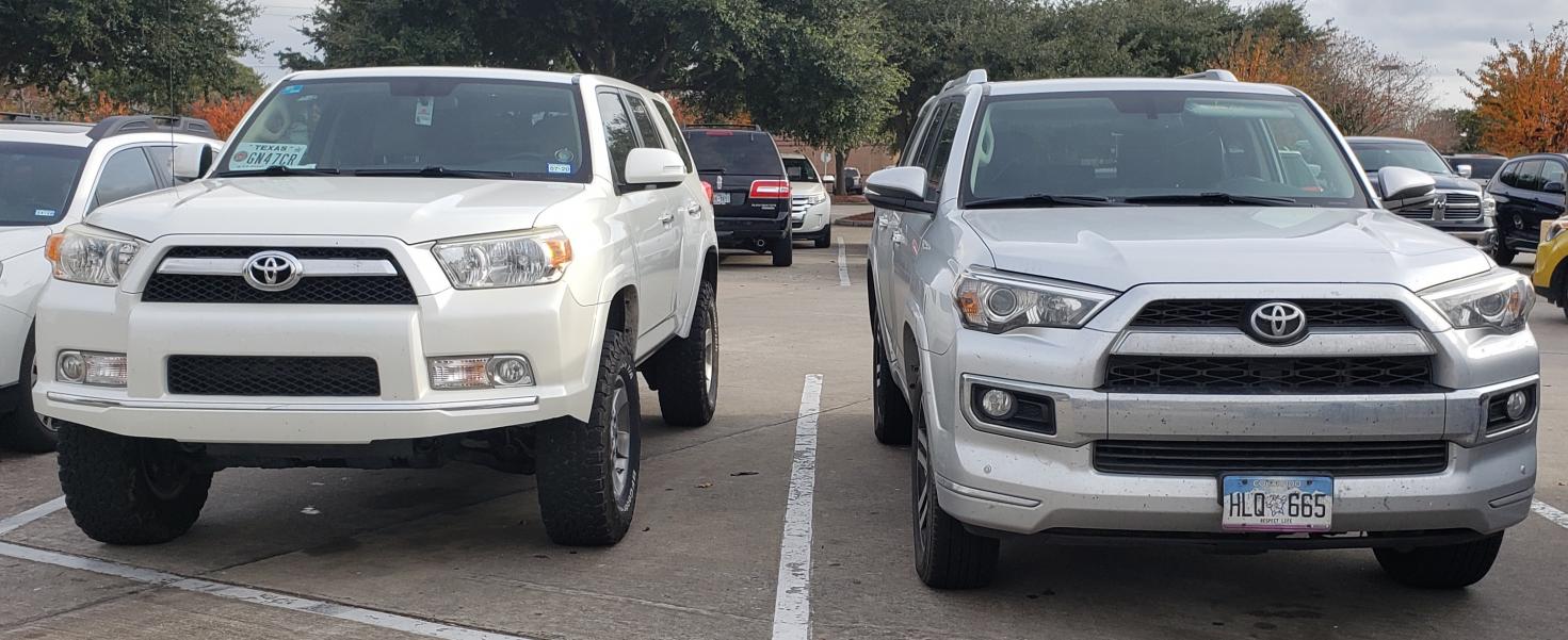

-Bilstein 5100 all the way around (set the front to 2.5") w/ 1.5" spacers in the back.
-275/70/17 BFG K02 A/Ts
-1" Hubcentric spacers (bought from eBay, working great had them for about 10k)
I attached a picture next to another T4R. It's not the best pic.
I experienced rubbing in the front and pushed the plastic wheel wells away from the tires. I eventually ended up trimming the front bumper to improve the approach angle. OE UCA/LCA with no problems. Drives great.
