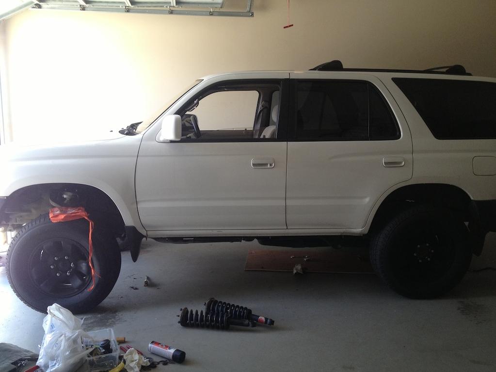

And this is what a t4r looks like with the front lifted with 3in first.
