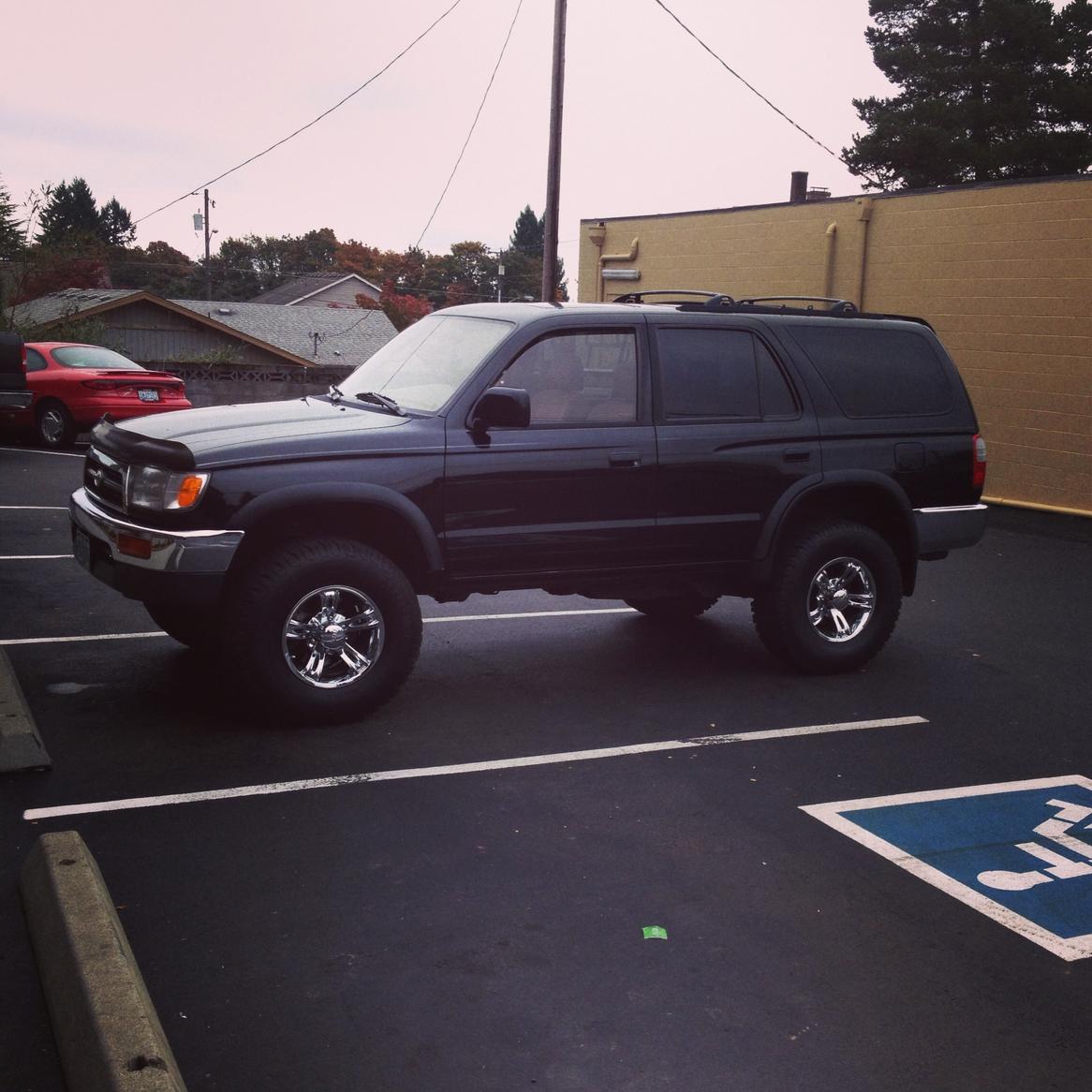

Does this like outrageously lifted? That's my 3"-4" lift fitting 285/75's
No, not really. Looks pretty nice!! :)
