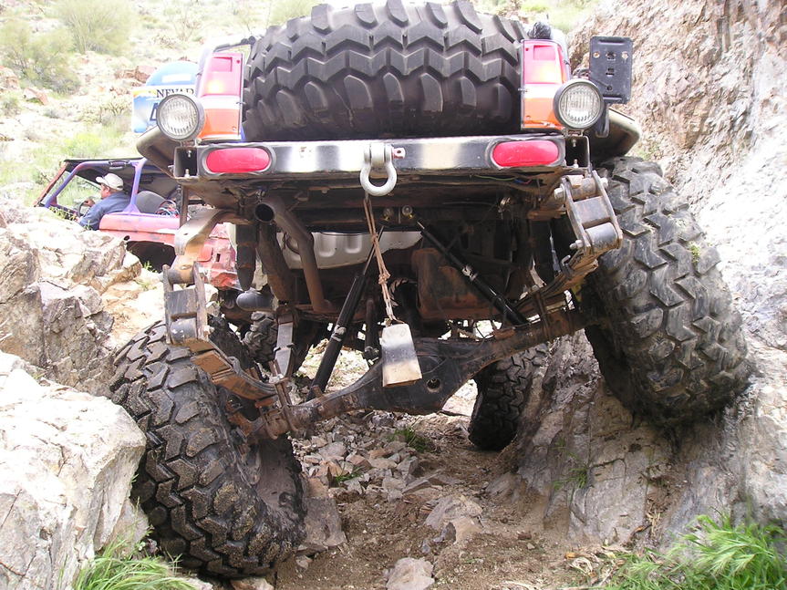

My old crawler didn't have any anti-roll bars, but I had Rancho 9000 shocks up front and I'd dial them up to max damping when on the road, (short trips only).
