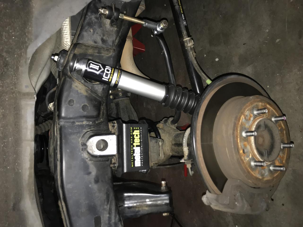

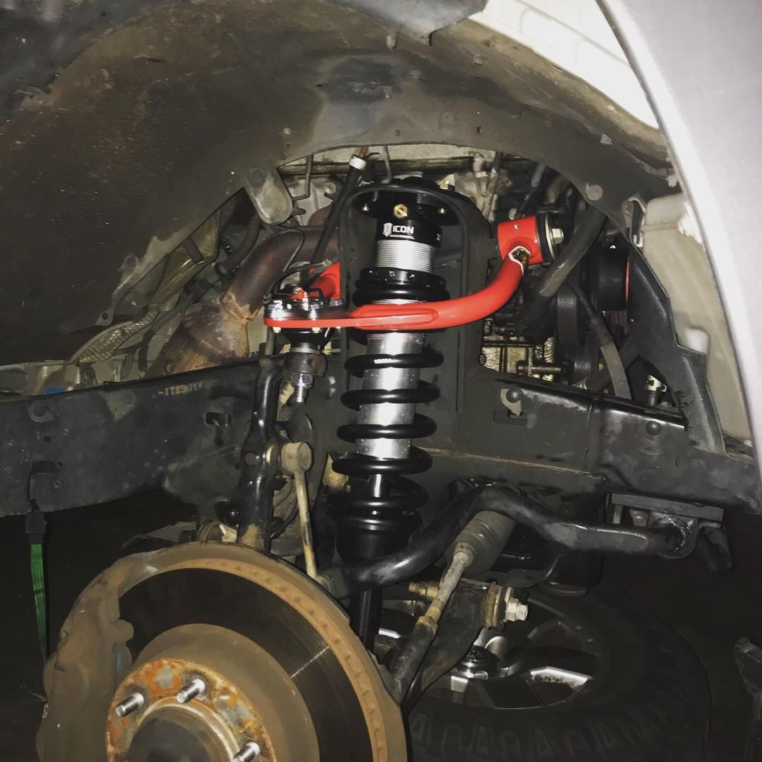

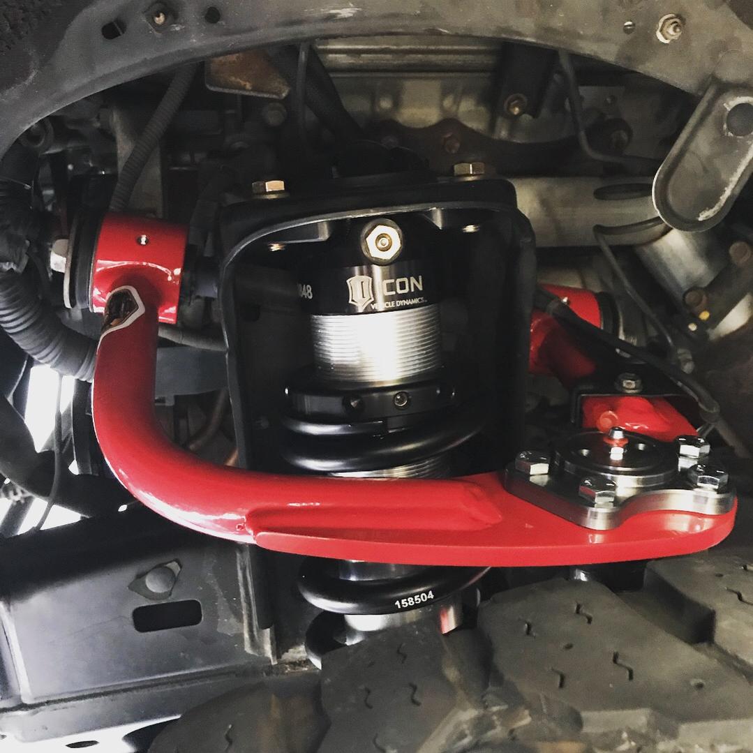

Some pictures of the hardware. Couldn’t adjust rideheight due to the defective coilover so there’s no pics

Good to see another local! Have you had an alignment yet? That may help the UCA rubbing as well. I would get the new Coil and do alignment before doing too much. The FJ wheels should provide a little more clearance than stock anyway.
I rubbed on the JBA arms as well, I went with the Trail Gear spacers and the et lugs from All Pro Off Road on the front. I will be putting in longer lug studs this spring when I do my brakes for safety reasons. You can also use a set of 5th gen wheels, they have a better off set.

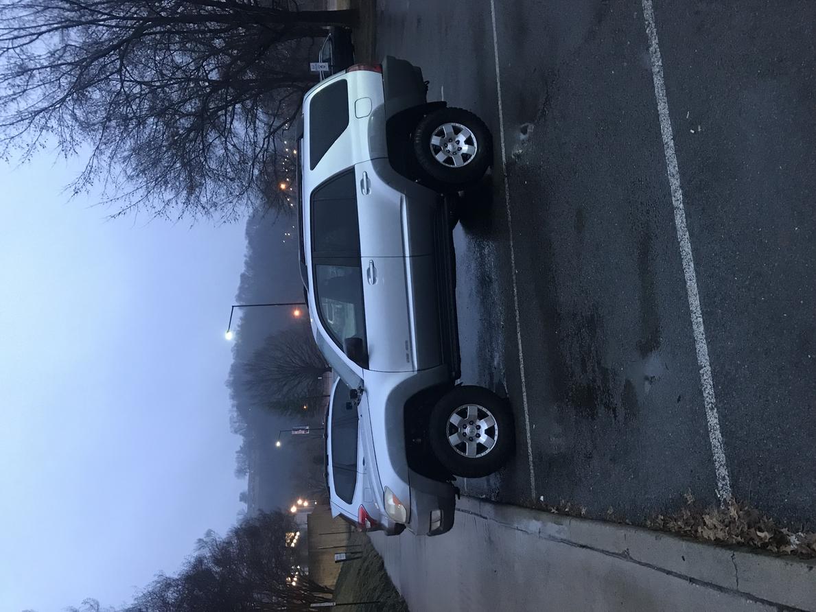

Here’s the way thing are sitting now. Not a glamorous photo, just snapped it this am. Wanted another inch or so up in the front
Not sure why picture is rotated

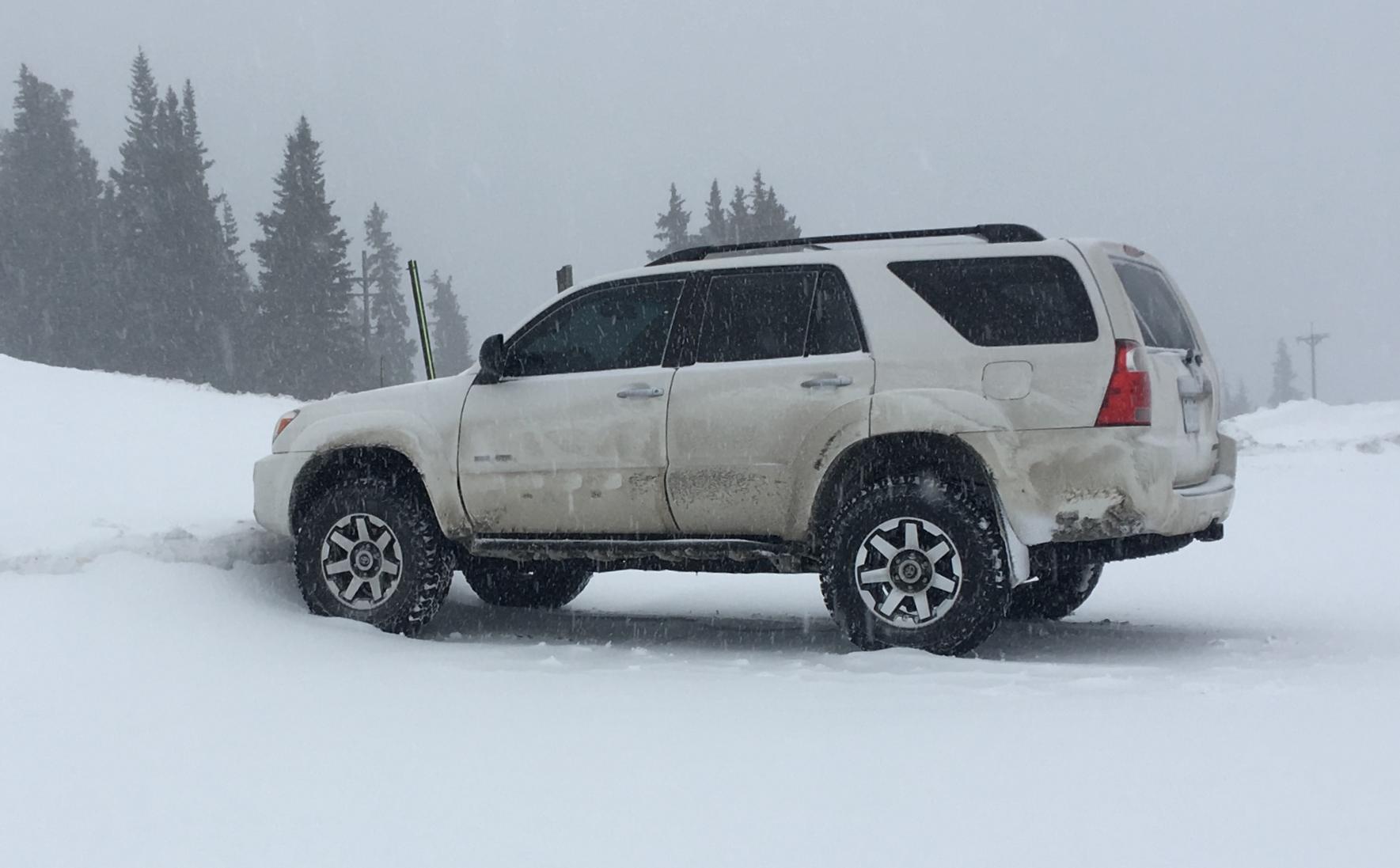

No wheels spacers, the trail edition/FJ wheels sit out about .6” compared to stock
