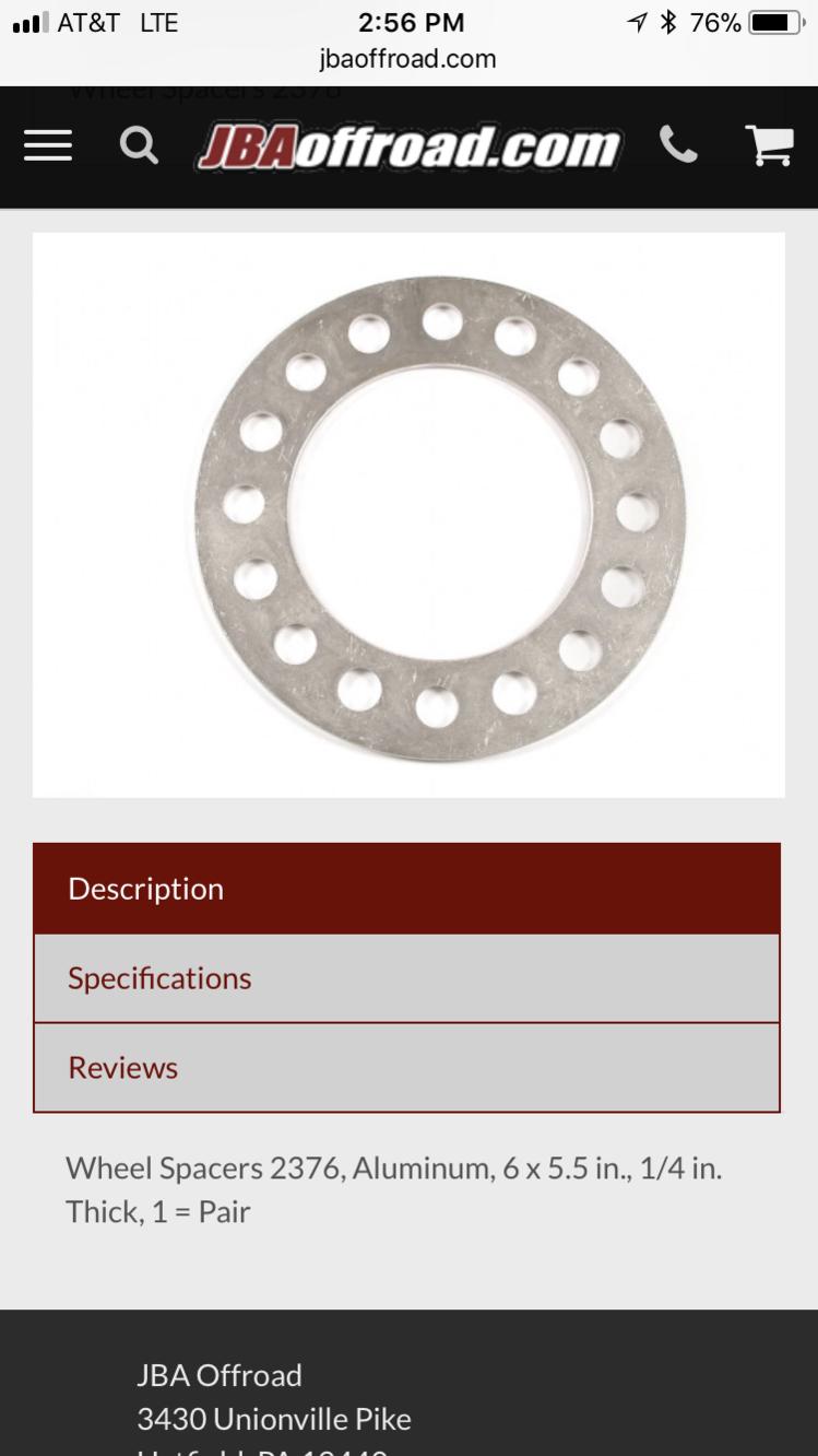

Saw these on jba site. Wonder if 1/4” spacer with 255/80’s on the fj wheels would clear the uca and still keep the wheel hub centric?
