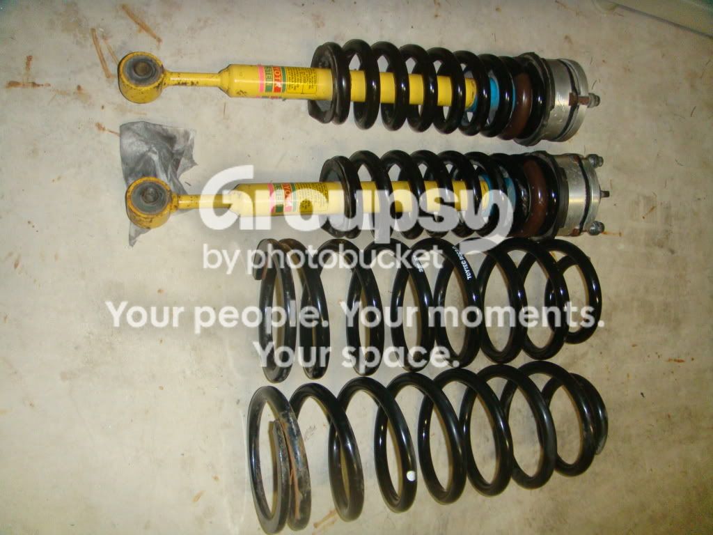

I'm selling my spacer lift that comes fully assembled which I ran with 275s.
045.jpg~original
PM me if interested
