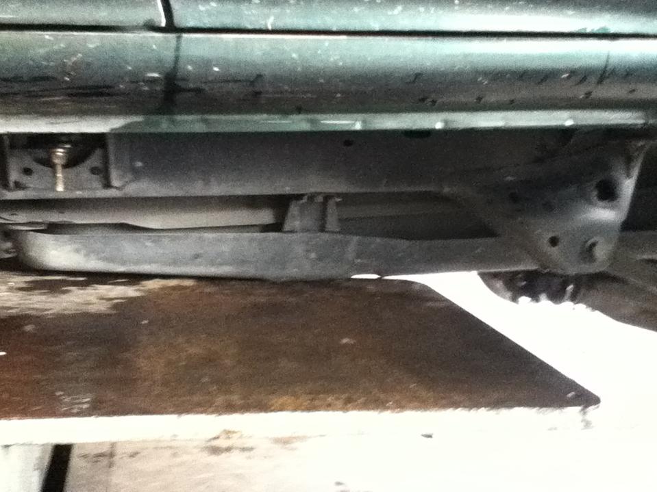

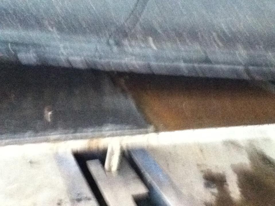

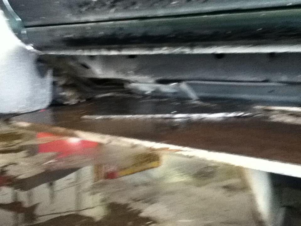

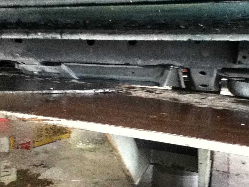

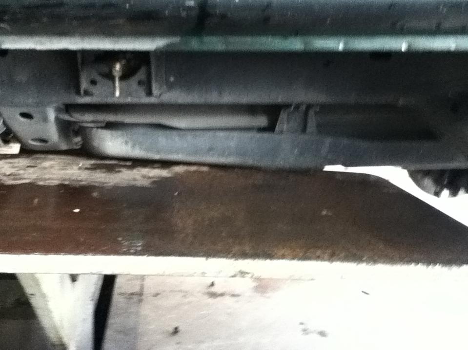

ok guys, need your thoughts here. i took my ride to les schwabb tires to have them mount my winter tires. When they pulled it in to the bay, they didnt use floor jacks but a lift with a big plate that didnt really work for the mfgr lift points. They ended up lifting it by the fuel tank skid plate on one side and about 2 inches of the frame on the other side, because it was uneven the whole truck sat crooked tilting to the side by what looked like 4-6". I knew this would not be a good place to lift by and the manager i complained to had a bit of a short and bothered attitude and said they do it like that all the time. we went back and forth for a few minutes and he kept saying its ok, they do it all the time, i shouldnt be concerned. He told me there was nothing they could doat that point cuz it was already in the air and the wheels were off and asked me what i wanted them to do. i told the guy i didnt see that i had any choice and began to walk away and the guy says with attitude that the ball's in my court. Unbelievable (to me) I watched them lower it and when they did it looked like the skid plate flexed back to normal position on the front end by about 1/4" in or so but i didnt take measurements or anything so i suppose i could have just imagined it. So please tell me guys, am i being unreasonable here? is there any damage now or going forward that i should be concerned about? at the end of the day im pretty sure the skid plate isnt designed to bear the weight of the whole vehicle but i dont know if i have unreasonable expectations and maybe im just making something out of nothing. Here are a couple pics, the last pic didnt really come out but you could kind of see how off it was on the other side. the lift plate barely touched the frame but the angle was so off that it almost touched the body outside the frame if that makes sense. i appreciate anybodys feedback they might have to offer, even if its to tell me to chill. oh yeah, before i left i asked the guy since he looked at it after i complained, "since you stand by your assertion that its ok, you would do it that way again?" he replied that yes he would.

thanks for the reply boo. Yeah i hear what you're saying. Basically Im pretty sure it was a 3 point lift. Because the fuel skid was the lowest contact point on the rear left quadrant, the whole car tilted forward and towards the passenger side. The contact i could see on the front was the crossmember you pointed out on the left and the right front had a couple inches contact along the side frame rail. in the back it looked like the entire weight of the vehicle rear was on the front part of the fuel skid. while they lowered it it looked like the front part of the skid from that mount bracket forward flexed back down by about 1/4". I had a quick look and it didnt appear that the skid gave way into the tank at all and the bracket there didnt seem to give way, but obviously i need a closer inspection. infact im nearly inclined to tackle removing the skid so i can understand the structure of it and inspect the tank. that blurry picture is the passenger side front/rear door seam. its a bad photo but gives you an idea of how the the car is pitching front right. even though the body looks close to the plate, its actually touching the bottom of the side frame rail which is several inches below the bottom of the body. another customer even asked me if that was my ride sitting all crooked on that rack. they didnt think that looked right either. Im guessing everythings prob ok but i swear if anybody tried to hurt my baby... i mean i would step in front of a bus for her you know what i mean?
and so i guess what im kinda lookin for here is that beyond any major catastrophic failure that obviously did not occur, should i be concerned about or look for anything in particular, Im not at this point familiar with the structure of how the skid mounts and whats underneath it, and second, confirmation or otherwise that these guys were out of line lifting it like that?

Lifting on the stock tank skid is a bad idea and should not be done. While I don't think you have to worry about a catastrophic failure, I think your fuel capacity just got smaller. Pull the skid plate off. If the tank is dented in ask them to replace it. If they don't, drag their @$$ through the mud on every occassion and on every internet forum you frequent. Businesses with stupid "mechanics" and crooked managers need to be starved into extinction.

Yeah, I would pull the skid off (5 bolts) like Leary said and see if the tank is dented. Les Schwabb Jr. is a jackass.

My first concern would be the fuel pump / fuel level sending unit which sits at the front of the tank. If the front of the tank was pushed up into the floor pan of the truck, those items may have been damaged.
The access door is under the carpet. I think you can access it by removing the drivers side rear seat bottom, and pulling the carpet up. You might be able to see if the connnectors are damaged there.
I would def. pull the skid, and maybe the whole tank.

Take lots of CLEAR pictures to document the damage.

update: because of inclement weather here business is real slow so i had a chance to give her a good look over. Doesnt appear any damage was done. Ill consider myself lucky on that. Never knew about the access door under the rear driver seat (thank you topdown) I was able have a good look inbetween the tank and the body pan, no compression there. So here is what i learned from this:
