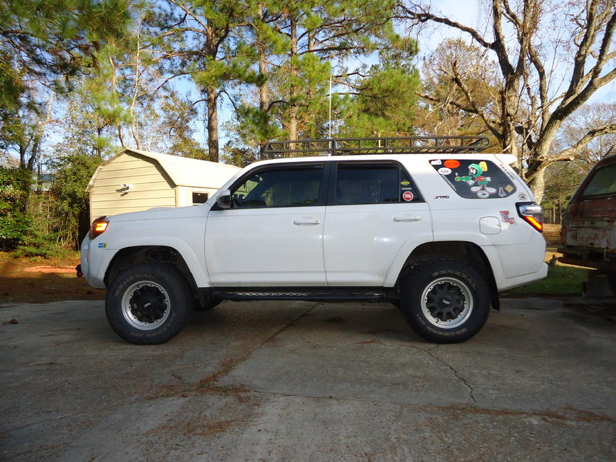

2" all around with Bilstein 5100's. On my second set of 265/70-17 General Grabber AT2's. Perfectly content to remain so. This is a 3 year old picture, but best angle right after changes. I am running 8" wheels and Spidertrax spacers.

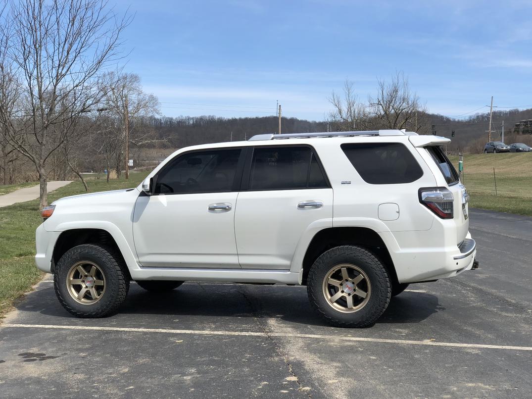

Mine is a Toytec at about 2 1/2" with stock 265's. This pic shows the factory tires and I now have 265 Toyo's. I am happy with the tire size and the fact that the speedometer didn't change and the mileage didn't change.
I did not get the lift to impress with looks, but to get better approach and departure angles when 4 wheeling. I like the looks okay, but am more concerned with function. If others don't like the look, I don't care. They are not driving it or paying for it and my build is to get the job done, not impress someone at the mall.
As far as handling, the lift stopped the front dive and cornering seems to be better, but the ride is stiffer.

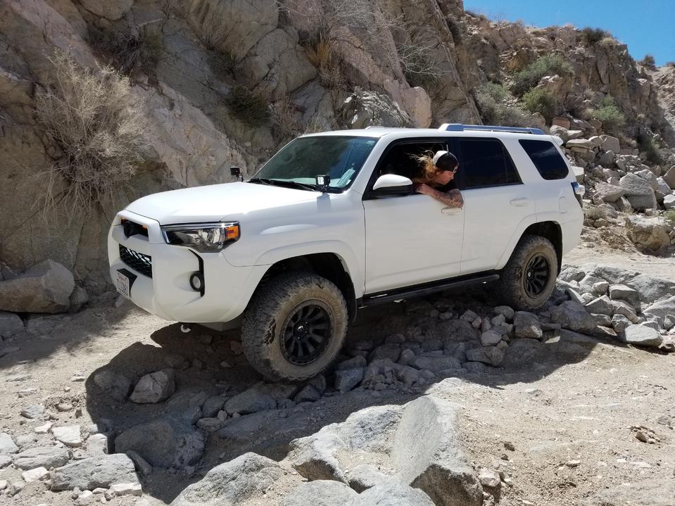

Here's some pics of my setup. 3 inch lift all around. Still rocking 265's. I'm happy with it.
May go to a 275 for a tiny bit more ground clearance when this set wears out but I'll cross that bridge when I get there.

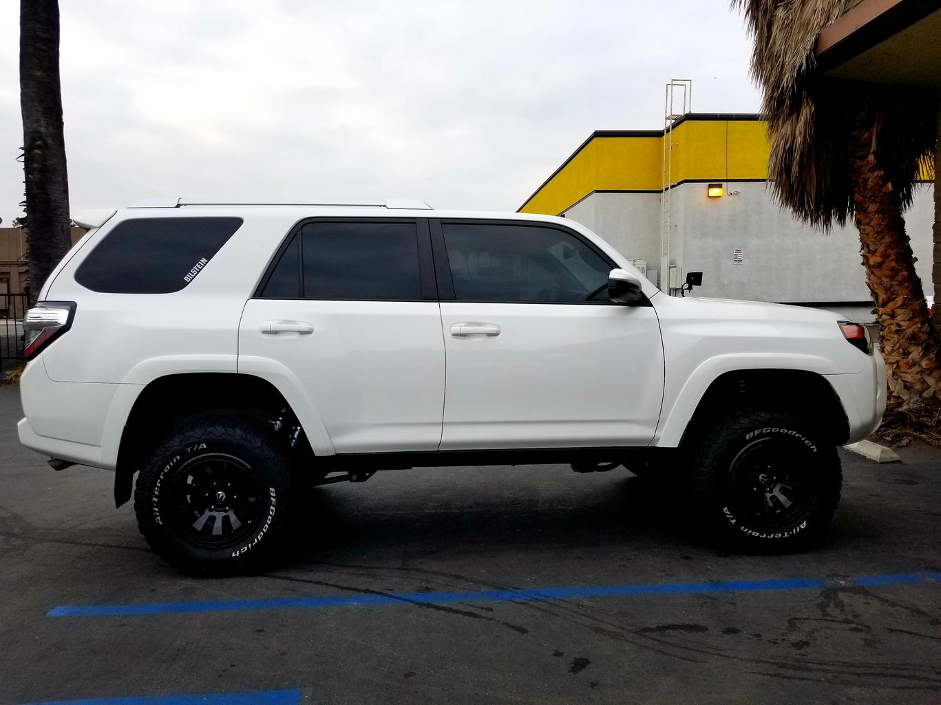

I had no issues with my 2013. Toytec 3" lift (5100's, front/rear springs, 1/2" front spacer). I had a Budbuilt hidden winch mount and Engo SR10S on the front.
Stock size Falken AT3 tires.

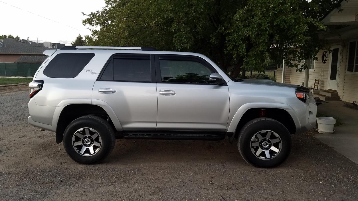

265/70/17 KO2's on 17x9 -12
Def skipped leg day...

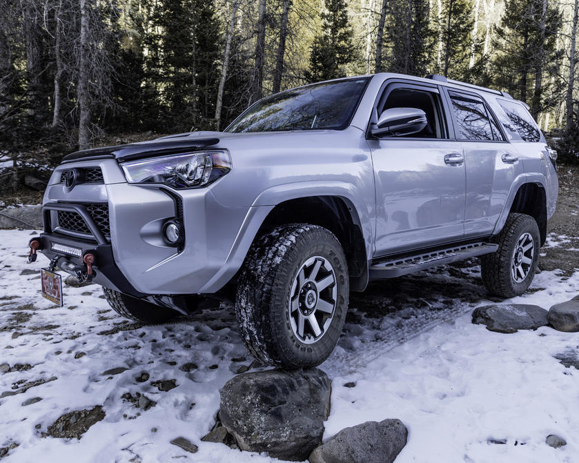

Roughly 2.5" of lift up front w/ 5100's & Toytec HD coils & 2" in the rear w/ Toytec SuperFlex coils & 5160's.
Because of the -12 offset wheels I do have slight rub at the rear of the front wheel wells (at mud flap plastic). Nothing that'll damage anything because its at extremely slow speed at reverse full lock. I did have rub at the front of the front wheel wells but the fender liner mod took care of that with about 1.5" of plastic pulled up/removed.
I will be moving on up to 285 KM2's after these KO2's wear out though. The 265's just look slightly out of place with this lift, but nothing I can't stand until it's time for new tires.
