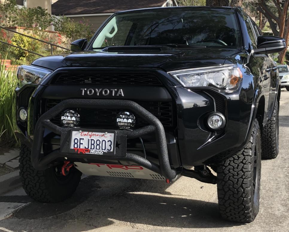

2” lift with 265s
I am plenty happy with my set up. Dobinsons 2” lift with stock size Nitto G2.
Hey man, sweet ride!
I’m about to switch to the same tire as you. Would you recommend it?
Also, I like the combination lift / tires you choose. Any pics from the side?
Thanks!

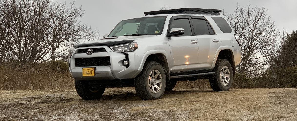

No problem. Here's a side pic:
<a href="https://imgur.com/8eK6Xar"><img src="https://i.imgur.com/8eK6Xar.jpg" title="source: imgur.com" /></a>
Yes. I'd definitely recommend these tires. Aggressive looks and smooth quiet ride.

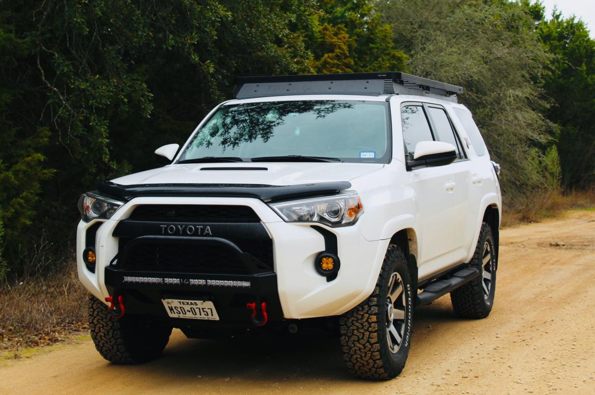

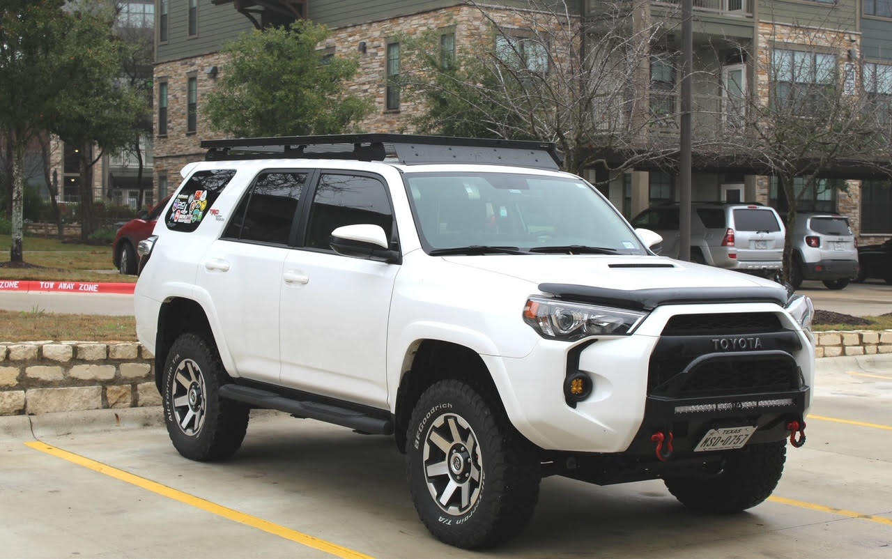

I have a 2.5”/1” lift on my Pro with 275 E rated KO2’s. A C rated or even an SL tire would be a better overall choice, which, a few manufacturers make in a 275. I think a 275 is a perfect size with a small lift as I like my mud flaps and not modifying anything else. Also, I had only a 1mpg drop in mileage and power loss was negligible.

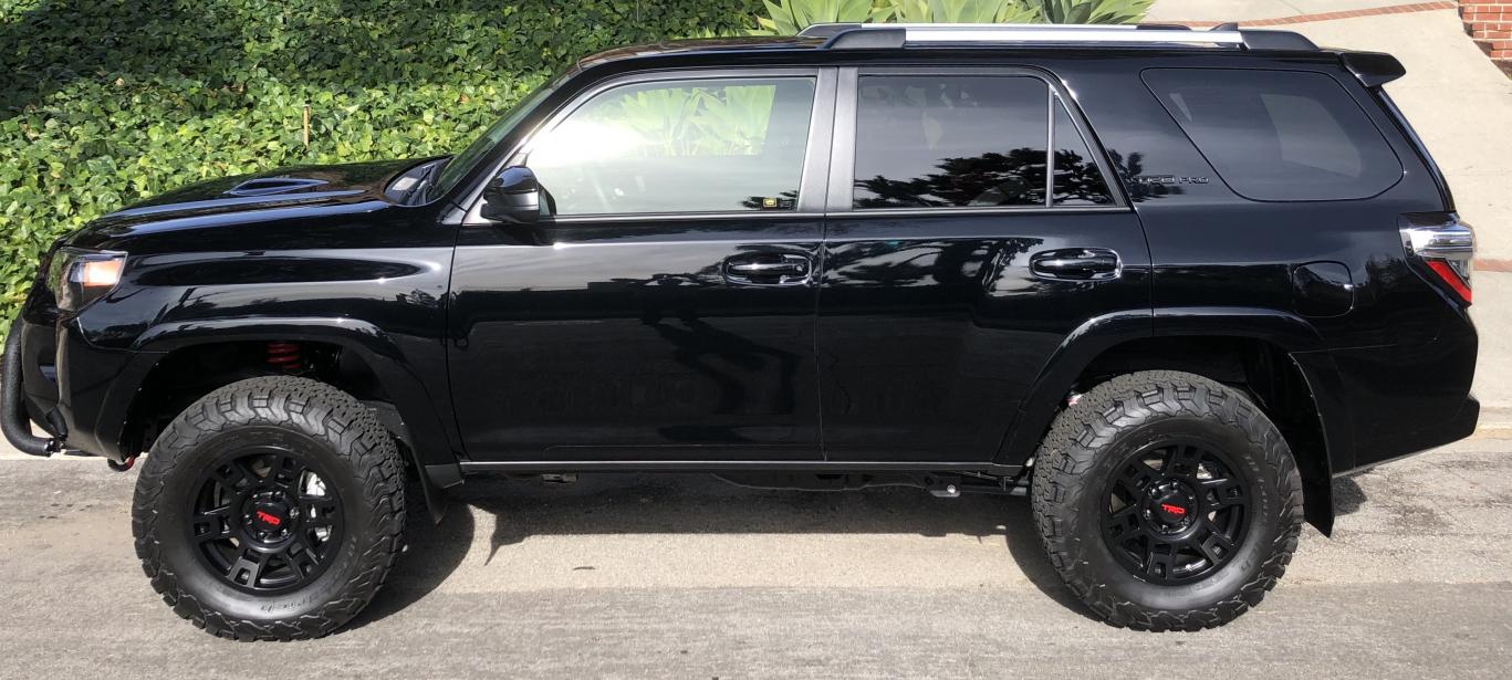

I've put roughly 13K miles on stock size KO2's with a 2+ inch Dobinson lift for about half of the time. They've performed well on and off road and I've been able to take them on a few off road trails. Everyone's need is different so If you don't feel like you need the additional clearance this is a great size given the load rating choices and weight. I'm looking to move up to 285/70/17s for both slightly more clearance given some of the other mods I'm doing to the rig and set up (improving clearance and towing a trailer). For reference, here are two images of my rig, one without the lift (stock size tires) and the other with it.

I see you have 505 springs in the back. Did you end up with 2” of lift out of those? On ExitOffroads site, it says it’s 1.5” but seems everyone is getting 2” unless you have a 200lbs in the back... thanks...

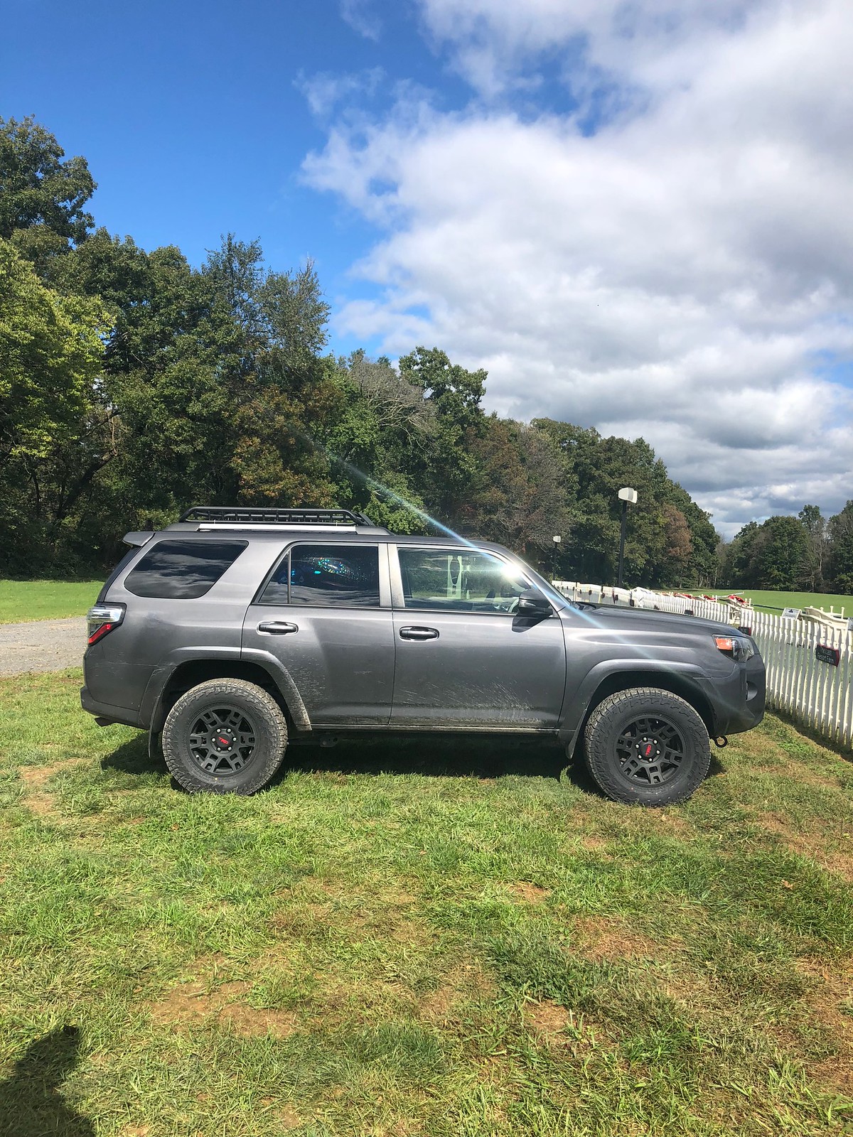

1.75" Bilstein lift in Front, 1.5" Cornfed spacers in the rear. 265/70 BFG KO2s
This is the one angle I'm not the biggest fan of. I'm afraid spacers will make it look too weird though so I just ignore it.
I do like the stock size tires though. Great grip, mpgs (relative), handling, etc. My jeep has bigger tires and there are obvious drawbacks, especially when making 6000+ mile road trips.
I don't think I quite got 2" but it was definitely more than 1.5" empty. I've since added a Goose Gear drawer system, and carry tools etc all the time so constant weight is probably well over 100 lb now. With the fridge I'm probably down to or below 1.5". I'll be upgrading to 400-600 lb springs when i add a rear bumper.
