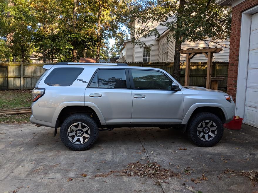

Mine is a Toytec at about 2 1/2" with stock 265's. This pic shows the factory tires and I now have 265 Toyo's. I am happy with the tire size and the fact that the speedometer didn't change and the mileage didn't change.
I did not get the lift to impress with looks, but to get better approach and departure angles when 4 wheeling. I like the looks okay, but am more concerned with function. If others don't like the look, I don't care. They are not driving it or paying for it and my build is to get the job done, not impress someone at the mall.
As far as handling, the lift stopped the front dive and cornering seems to be better, but the ride is stiffer.

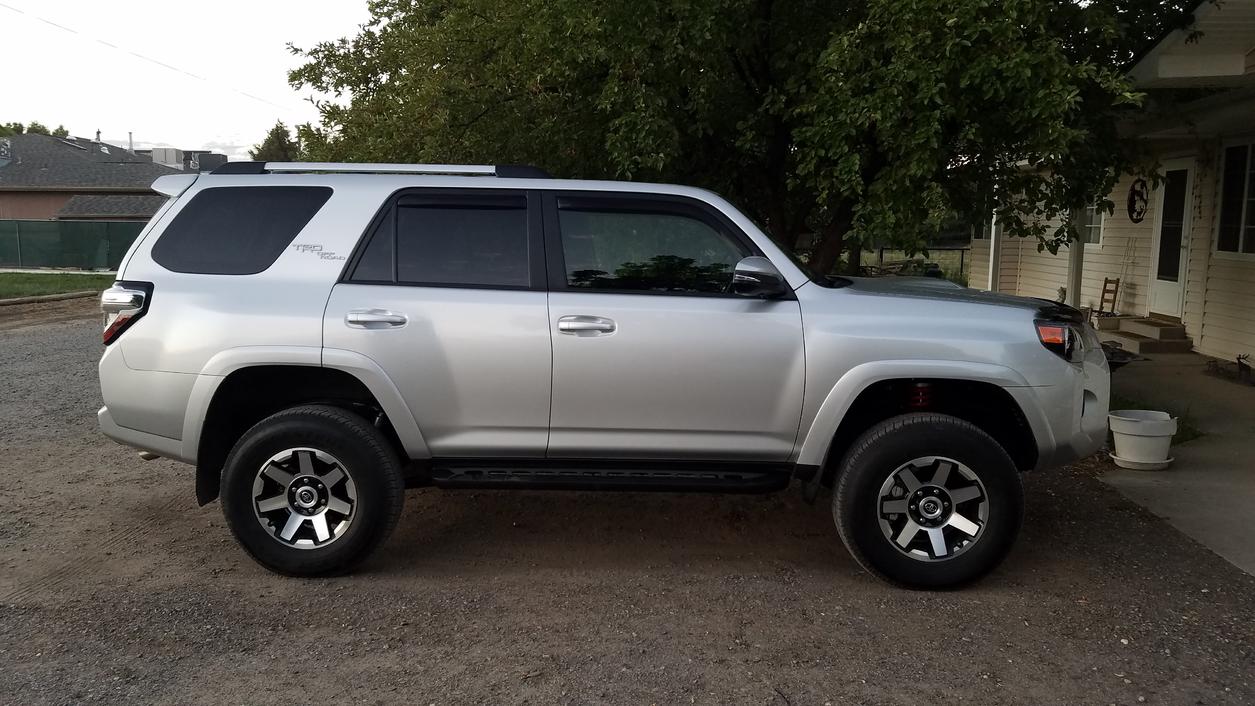

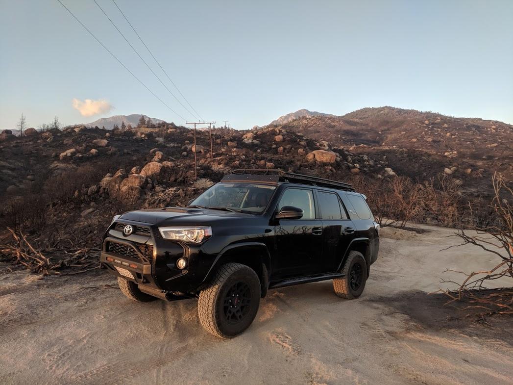

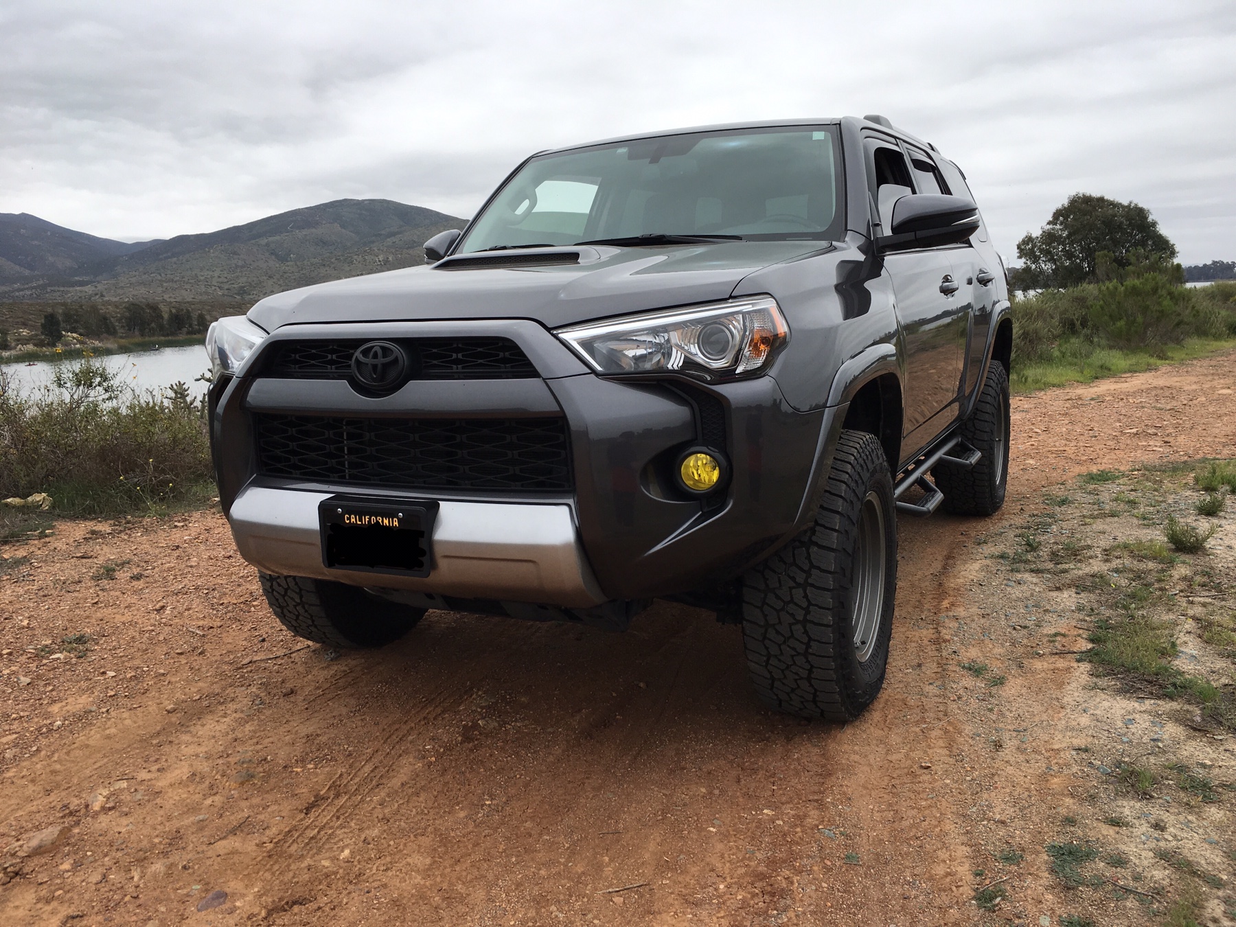

2" Bilstein 6112 up front, 1.5" 5100's w/OME coils in rear.
17x8.5", -6 offset wheels wrapped in 265's Falken AT3W. Had to remove front mud flaps and cut the inner front bumper as these were rubbing on full lock.
Truck now rides better than stock (feels more planted), however, my mpg's did take a hit. Overall, I'm satisfied with the outcome!

Edit: To stay on topic here are two more photos from the side showing my 265's and lift.

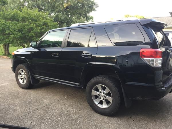

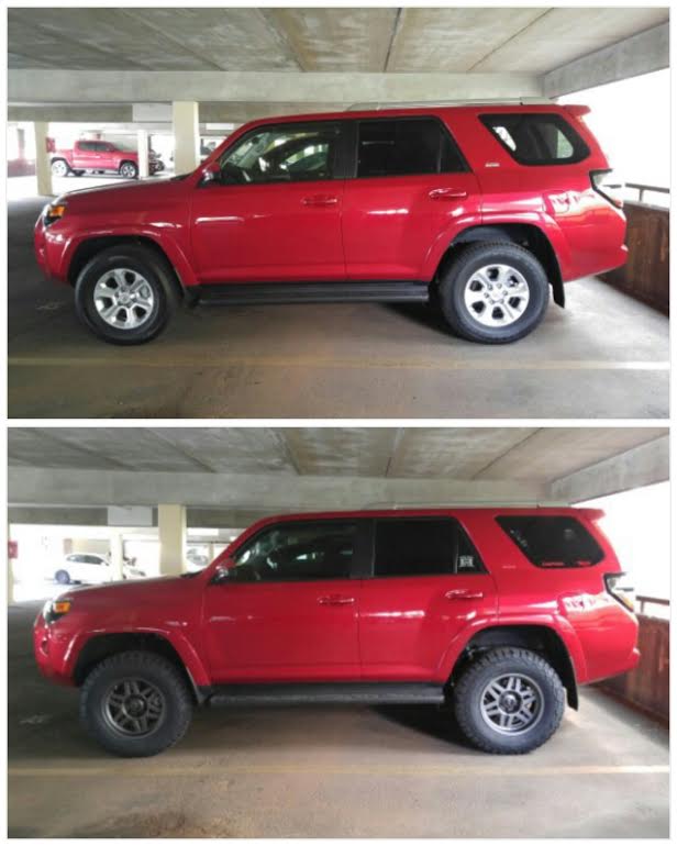

Top picture is totally stock...bottom picture is with new wheels, tires, and lift. Just changing the type of tire also makes a big difference...wheel offset also improves the look

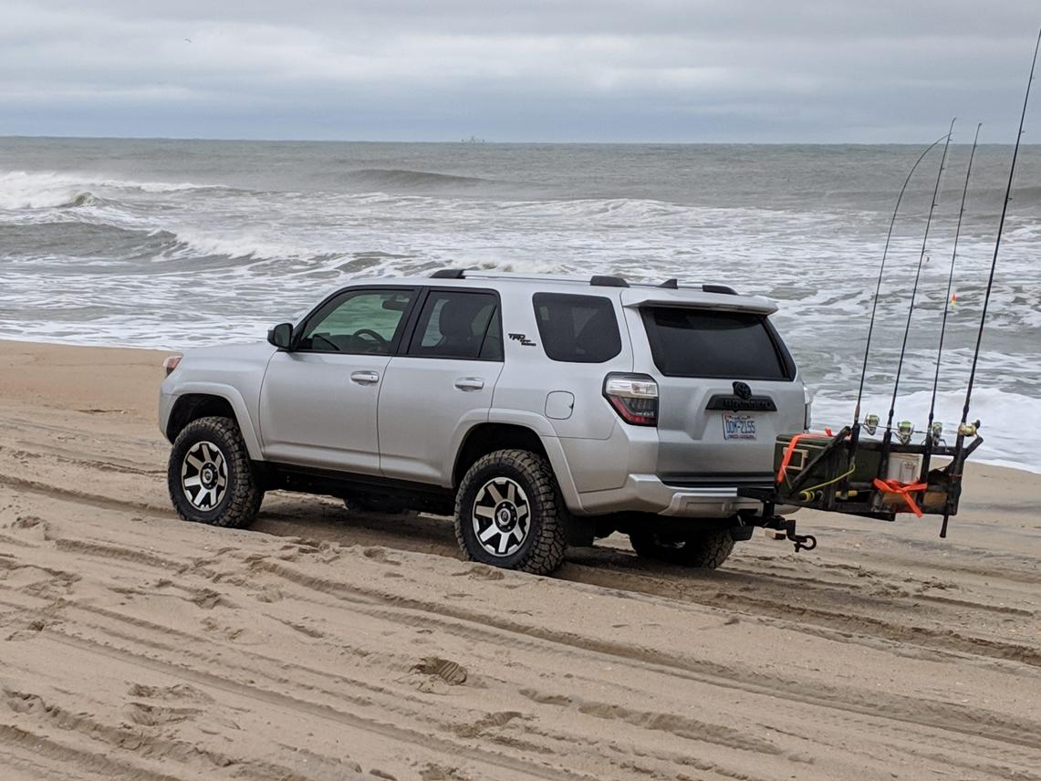

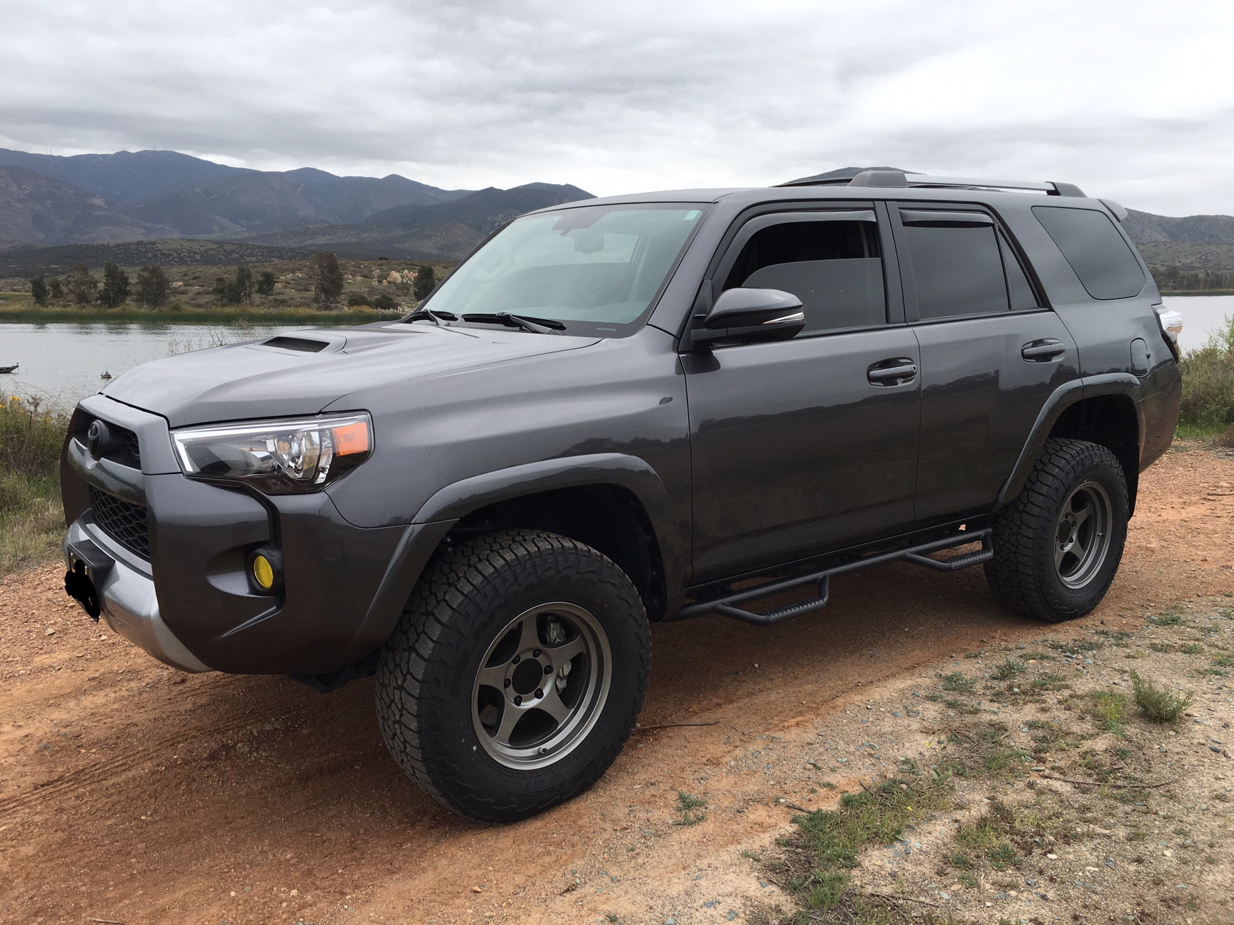

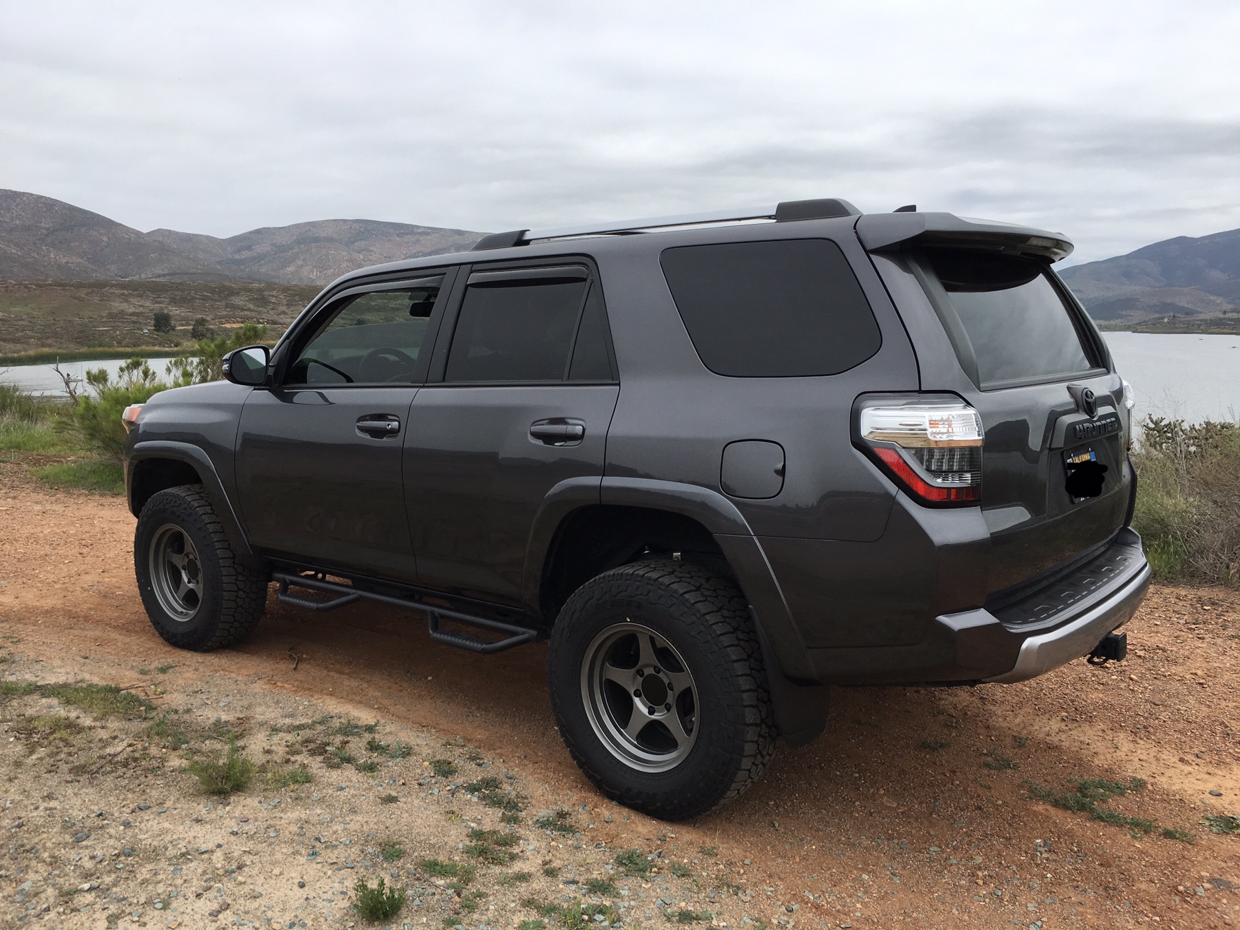

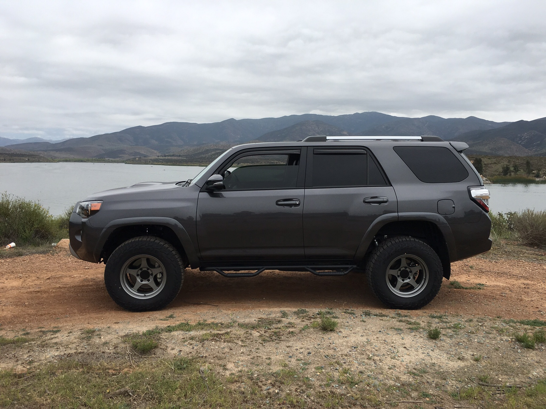

Love mine. 2.5 front 1.5 rear, 265 Falkens,

Running wheel spacers?

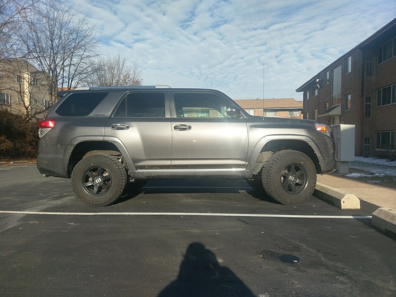

highest setting with 6112s in the front and 5100s in the rear with OME 2895 springs.
