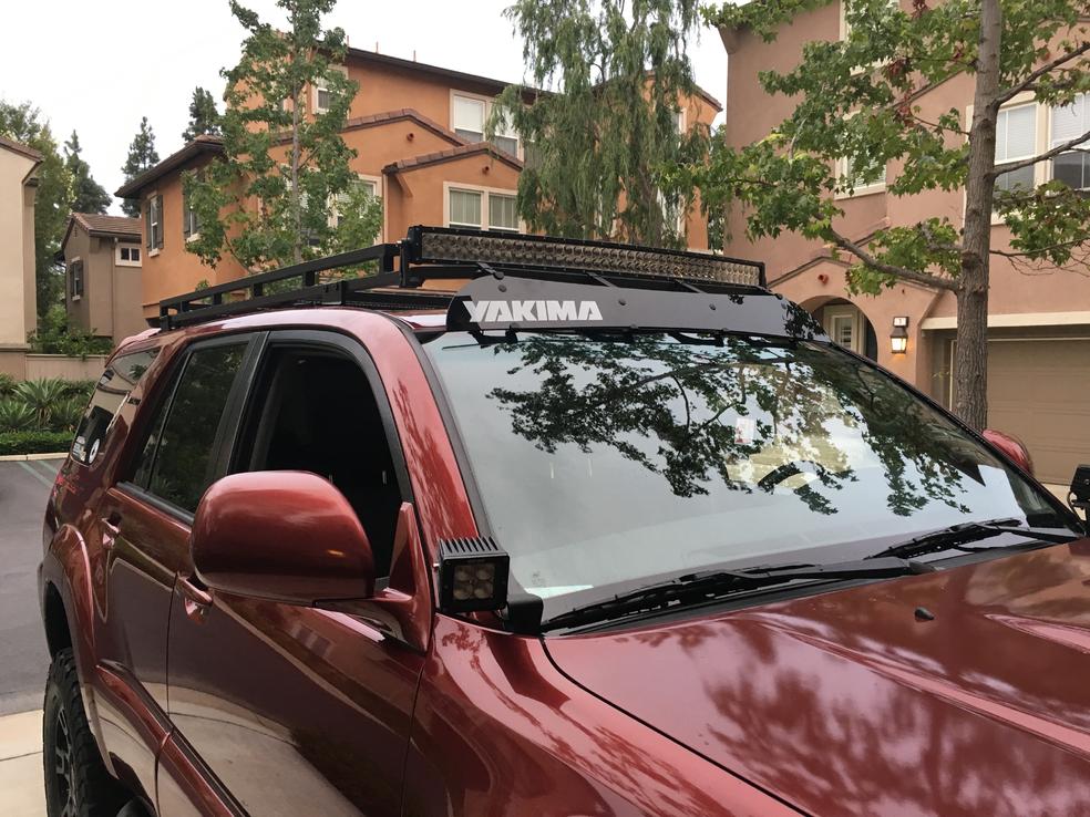

I have a 42 curved mounted above the windshield. There really isn't much glare coming off the hood. Where most of the glare comes from is the actual windshield. You get dust on the windshield and then the light reflects off of the dust.
I have downpours mounts and a 40.5" light bar.
No wind noise. No HOOD glare, but windshield glare is annoying. Not much one can really do about it.

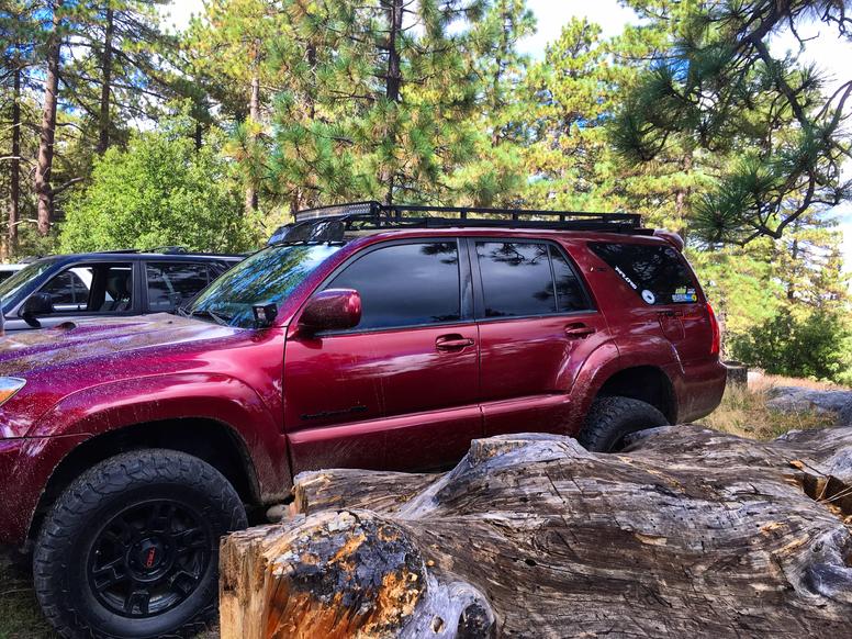

I have a 42" curved bar mounted on my roof rack and I barely get any hood glare. I think its set back far enough and I am sure the wind diffuser helps block the light from hitting the windshield. I like having it that high because it lights up everything. As for wind noise I believe the diffuser helps with that too and I don't have any whistling just a light turbulence sound. Nothing major, with the sunroof shade closed I barely hear it or not at all.
Hope this helps!

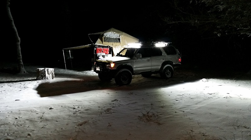

Roof Mounted Lights are Great!
So I guess I am a dork times four, since I have roof mount lights on all sides. They are great for adding light when needed at camp -- mine are wired "hot" so I don't even need the ignition to be powered on. I also added a battery tender to the engine bay, so I can use my generator as shore power to prevent battery drain. Finally I had 20" side lights wired into my alarm so that I can hit the panic button and they will come, and stay on, great for getting rid of that pesky bear that keeps visiting my camp! :)
I also find them useful on the trail for seeing the "hidden" side trails, and navigating tight spots. Night trail rides are awesome, and make the trail you rode all day seem brand new! The rear lights are especially helpful when connecting my trailer at night.
P.S. -- I've never been bothered by glare...might be all the dirt on the hood that dulls the shine?!?! :)

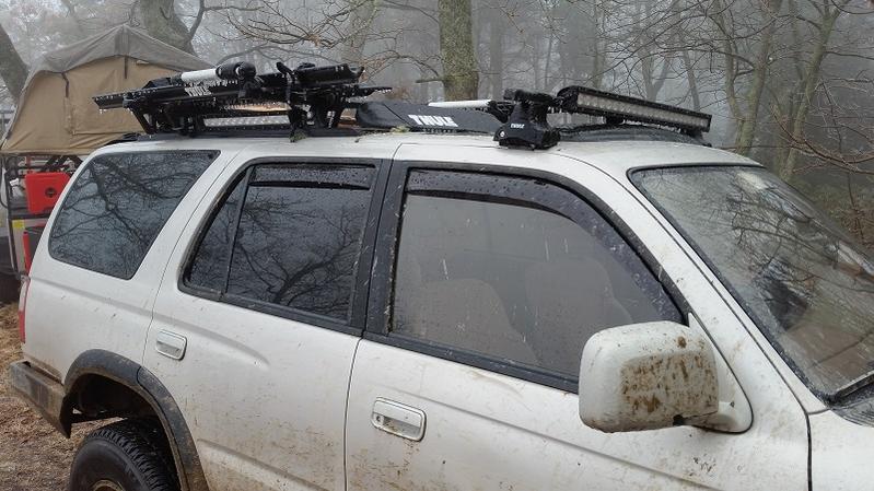

I used a Thule load bar to mount my front 40" -- allowing me to reposition as needed and/or replace without worrying if the the holes I could have drilled would still work.
Hope this helps! Happy Trails!
