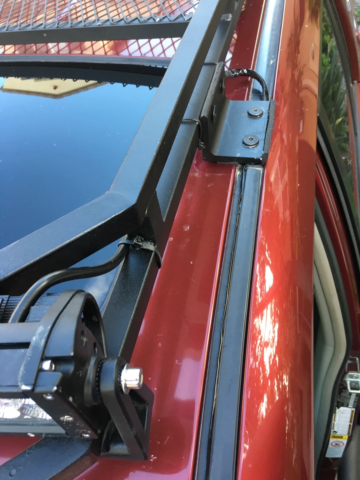

Does anybody have pics of the wire running along the windshield, mounting of the relay and running into the firewall?
Thanks a ton!
I was feeling in a good mood so I decided to go outside and take some pictures for you if my install. I would highly recommend buying a light bar harness, it makes things easier and much fast.
I just pushed the harness into the channel seal and it holds pretty tight.
Then I ran it along the windshield down into the cowel right next to my ditch light bracket.

That's great, thanks for the pics bud!
