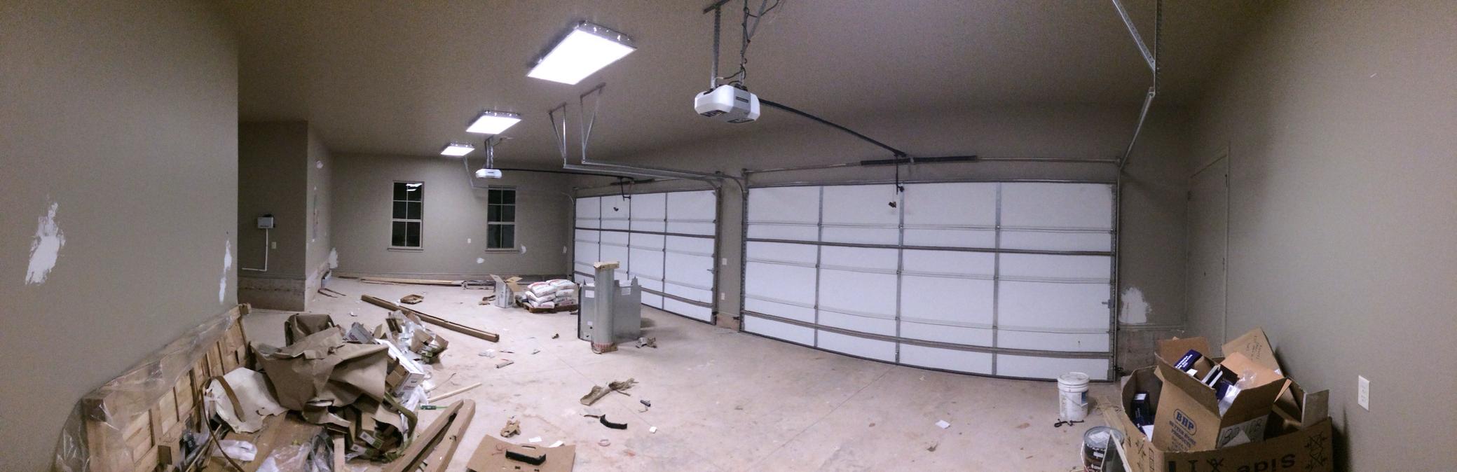

Thanks guys, it's a pretty sweet set up. 44x23x12 has a 4x12 area for workbench and 2 8x18' oversized garage doors.
We need to start a garage thread for tools and ideas!
I agree! My only requirement for our next house is that it have a large enough garage for me to actually work out there, or enough land to build a large pole barn.
Damn...I am about to embark on a new garage build and am limited to 40x20. Not small but not what I want either. I want to garage door tall too so I can get a lifted truck in there without taking crap off the rack...lol.

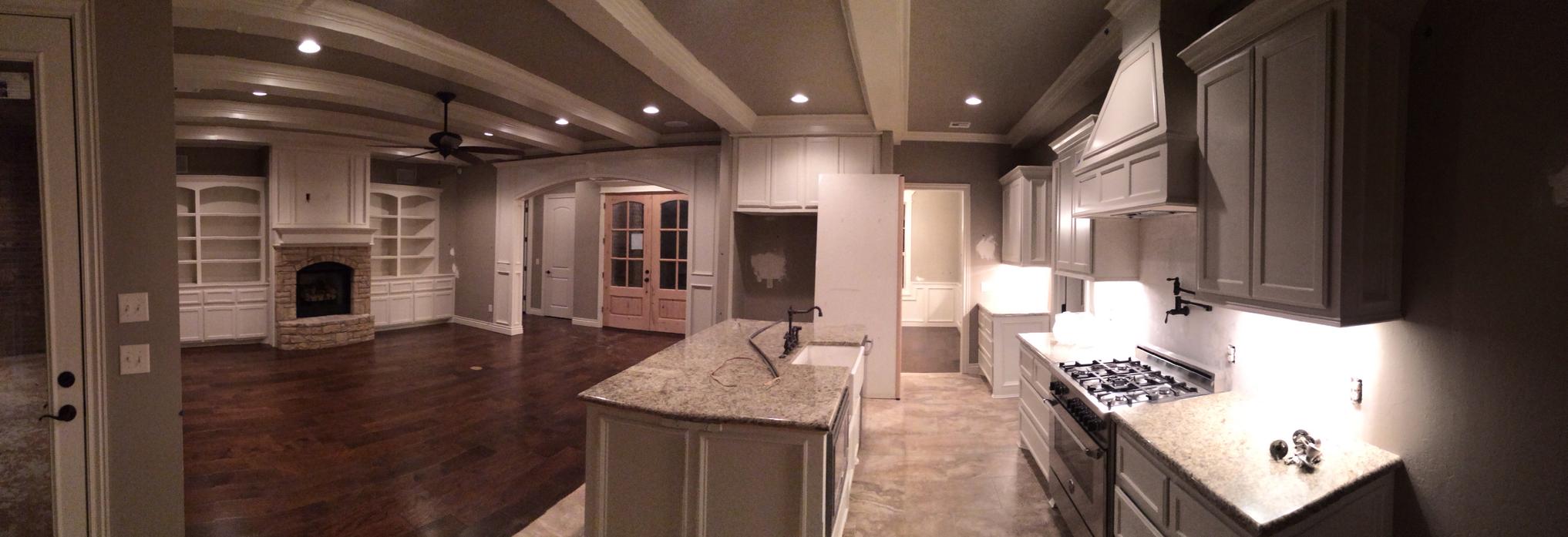

One more because you kinda asked, I'm not normally a look at my stuff type guy but I'm really proud of this house because I designed it from the bottom up, floor plan, inside, and out. Here is a pic of the inside as of yesterday.

You should be proud! That house is incredible!

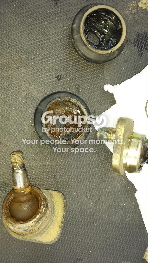

Light Racing UCA after 12k and around 10 mos.
Sorry for the long delay in getting this swap and the pics up here guys but I was dealing with a concussion for a bit so between that and weather the truck has been a bit neglected. Anyways - got the Desert Racing Uniball UCAs in today and took pics of the old Light Racing ones.
[MENTION=99235]Scott@Hightech[/MENTION] - I'll see you this week hopefully to get an alignment but it actually seems pretty close right now.
This was the passenger side ball joint after 12k and 10 months. Externally, the boots were both in perfect shape and fit snugly. Not really sure where the water infiltration occurred but the ball joint is totally shot and has excessive play.

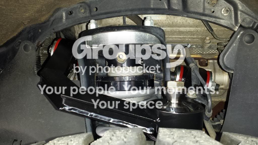

In with the new. Anyone considering Desert Racing UCAs, I highly recommend them. Really well built and hopefully they'll hold up well!
