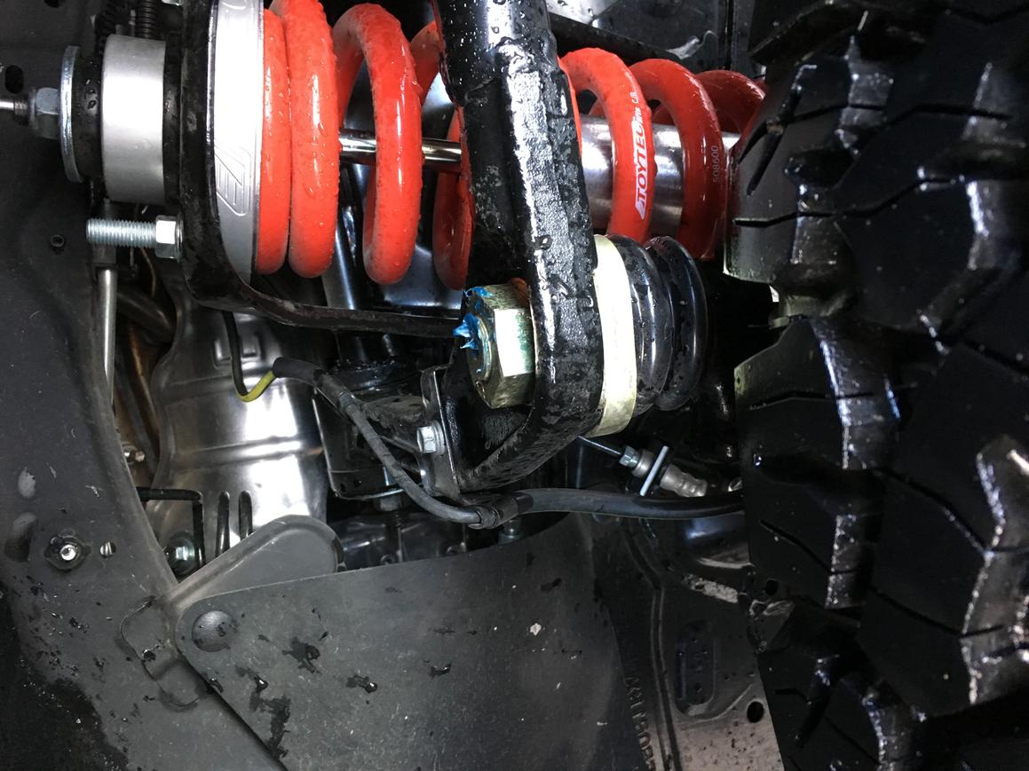

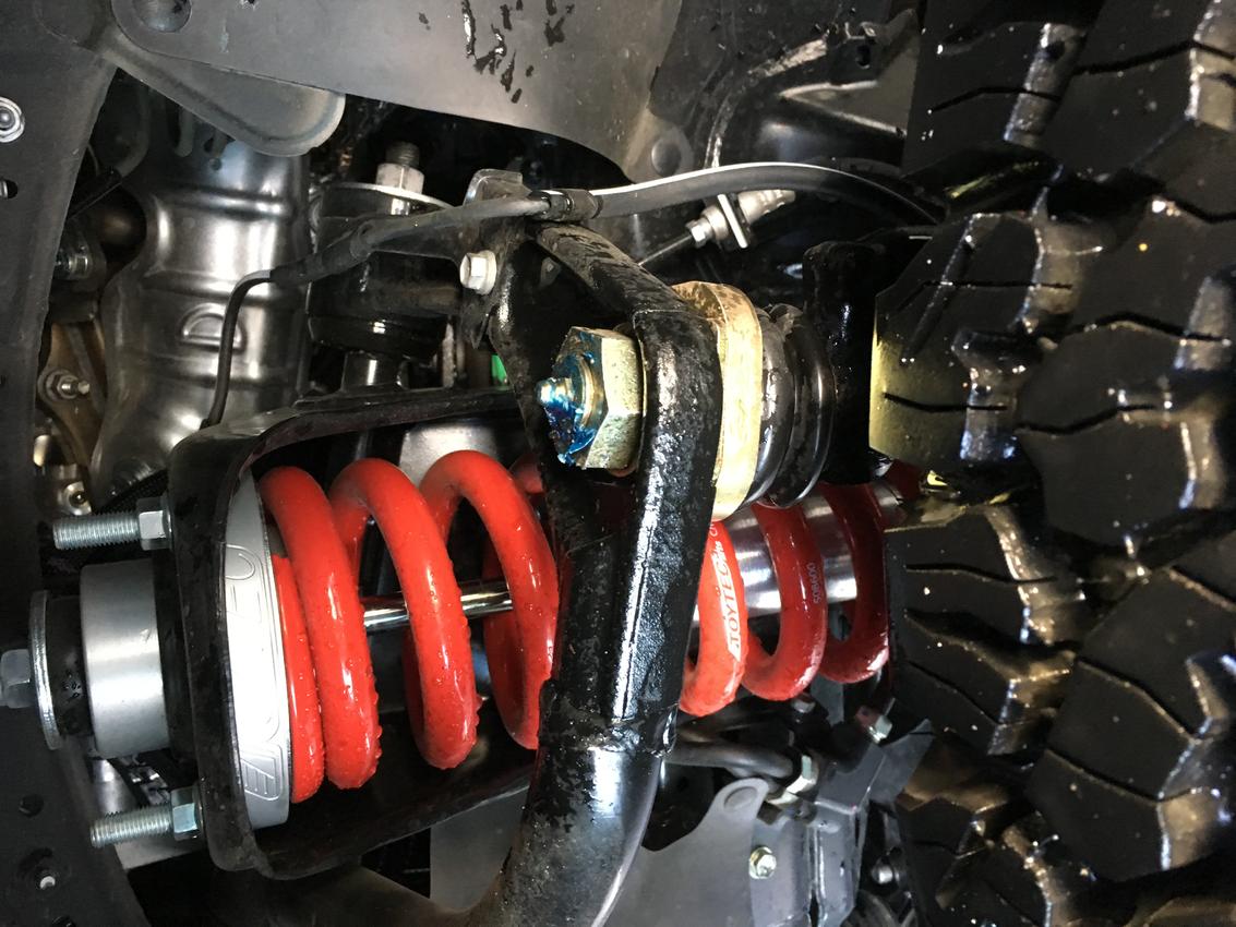

Old post resurrection but would anyone know the size or where to get the zerk fitting for the LR UCA. One of mine must have popped off somehow.
It should be a standard zerc that can be purchased at any auto parts store. I've got the older version without the zerc fitting, including a spare.
Are you sure it wasn't sheared off, leaving the threaded portion still in the hole? That's gonna be a whole other problem.
That's what I was worried about too. I'll have to double check that in the morning. What would I need to do if that's the case? (I went into autozone today and they had no idea about the getting a zerk.) I'll check somewhere else.
most zerks are not torqued to extreme values (they can break pretty easily if over tightened which has led to my experience in extracting broken ones:madgrin:) and a broken one is pretty easy to remove with an extractor tool. In a worst case, once it cas been removed, run a tap through to clean up the threads and you should be good to go
Awesome thanks for the information. Looks as it must not have been in tight or (taken off) when getting alignment. I was easily able to screw the new one in just the length of threads is longer than the original but it works for now.
dont worry about some thread showing - as long as it is secure and at the right orientation to add grease when you need to, everything is good
