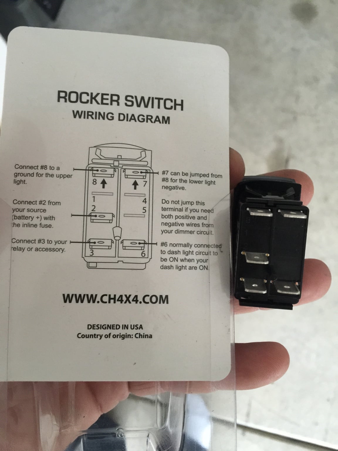

these are the light switches
This is the back part of the light switch. The top pin that has nothing booked to it, that's where if I hook the black wire. It illuminates the switch. But because it stays on always I do not have hooked up. I'm afraid that it will drain the battery if I don't use my truck for a looooong time.

I believe you're overthinking this. You probably don't need to add anything. It sounds like your only problem is the "illumination" wire. You need to figure out which wire this is (coming off the back of the switch) and tie it into an "ignition" power source, such as your cig lighter, wipers, seat heaters, etc. As of now, this wire is tied to constant power.

Have you tried inverting the white and blue wires on the switch? Seems to me one of those wires is hot and the other is the trigger to the relay, when you turn the switch "on" they are connected and turn on the lights. The terminal you connected the black wire to is permanently connected to ONE of those two terminals that do the switching, and not to the other. Just swap blue and white and see.

I believe it's your switches. They don't have a separate illuminated +/-
I think you need one like this...
I think sir you are right.
I've tried switching the blue and white. And it does the same. The reason the other switch has different colors because I needed to extend the wires all the way from the back. I think I'm just save my self a headache and buy a PROPER switch
