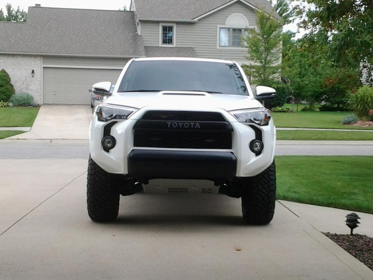

Over the past few weeks I have been working on my build and one of the last things I did was put my SPC upper contol arms on and a set of wider and larger wheels on. I have an appointment for a real alignment this coming Tuesday. I am not driving vehicle until then and I dont want to ruin my tires on the14 mile trip there. I am a rookie when it comes to alignment but i do now enough not to drive it with toe out of adjustment. So I have adjusted my camber mostly buy eyeball and used a string method that I found on line. I feel I have it dialed in enough to make the trip on Tuesday.

Yea, I had enough toe in after installing that I thought maybe an adjustment would have been wise before driving on them. Its hard to tell in pic. But it is actually now sitting pretty good. Picture can fool you. Can I just fix sensor after alignment and I do know those senser wires do run tight. Should I move them somehow to reduce strain? Light didn't seem to come on until driving down the road a 1/4 mile or so
