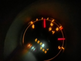

Hello everyone,
So I had to replace both of my CV axles and one of my hub assemblies. The axles were really jammed in there and I had to smack the hell out of both of them to get them out. I reassembled everything and the car drives fine but now it won’t go into 4WD and cruise control doesn’t work. I’m at a loss as to what it could be. There are two lights flashing on the dash as soon as the car starts, in park, in drive, always. They don’t go off at all. ABS sensors? Front diff actuator?

Only thing I can think of electronic in that area is wheel speed sensors. One on each spindle. Might want to check the one you removed for the bearing swap.

Awesome. I will check both of them. Do you think that beating on the axles to get them out could have affected the front diff actuator?

So it turns out it’s not the ABS sensors. I’m thinking it’s the front diff actuator. I must have damaged it when replacing the CV axles. How hard is that to replace ?
I didn't see any trac or brake lights lit, so I figured it didn't have anything to do with abs. I don't believe the abs has anything to do with the engagement of the actuator. I have read about several stuck actuators, not had to change one out yet
