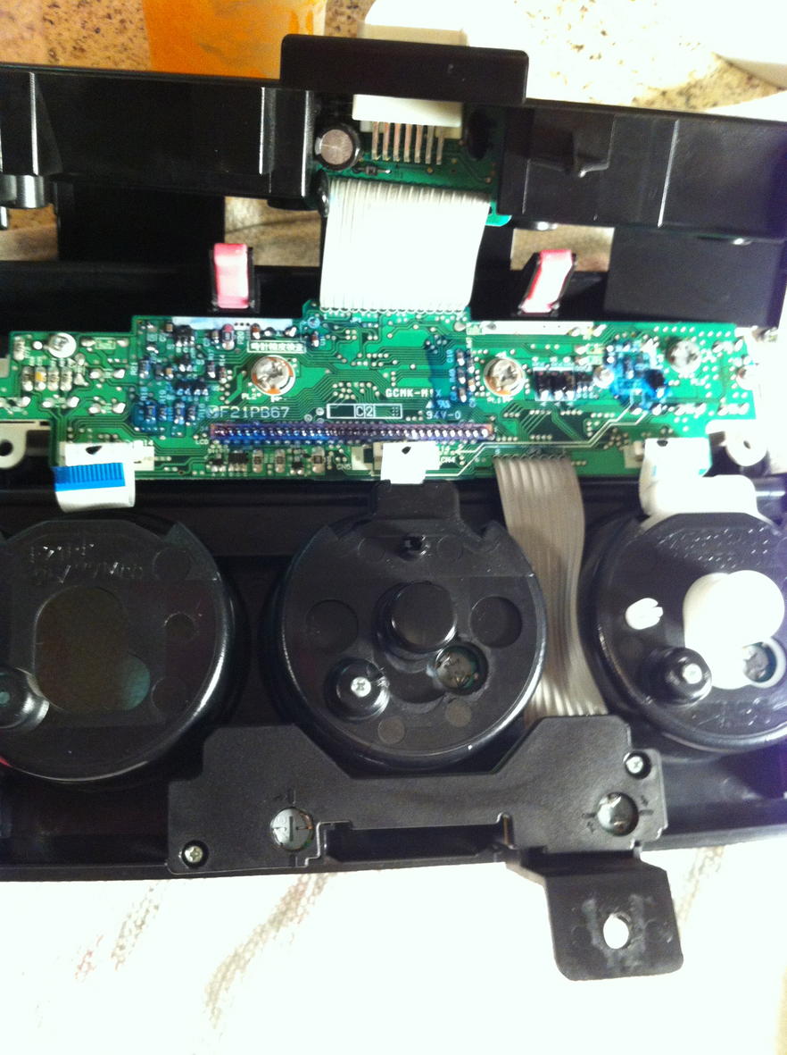

You want the NeoWedge LEDs I believe the 4mm are for the display.(click link below) You can find lots of info on this if you do a search on T4R. The high power ones may not work in the display only, but work everywhere else. The Neos are also polarized so if they don't work when installed you just turn them 180 and reinstall.
You don't need to disassemble as in pic below but you can see 2 the lights in center of the board.
