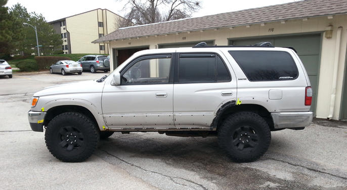

Before:

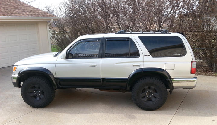

After:
Looks great! Ditto on them clips I pain $1.20 ea for the small ones and $2.50 ea for the larger rear ones. Fortunately, we didn't break too many in the removal. We didn't remove any interior paneling to get the rear cladding off, though. Also, the hard rubber molding along the tops Toyota wanted $110 for black pieces. Our solution was a $4.50 giant permanent sharpie on my silver ones. It's held up awesome. No bull though it's an expensive job -
