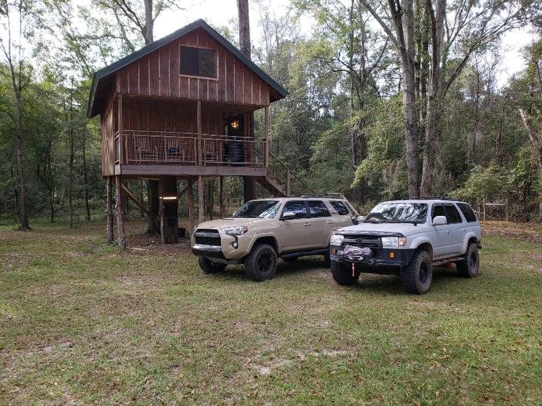

Though, we did make it! My wife found a pretty sweet deal for us. This AirBnB was about as much as hotels that would accept large dogs, except here we have more privacy, get a little taste of the outdoirs, and the dogs can run around freely!
#Evac'ation *rolleyes*
