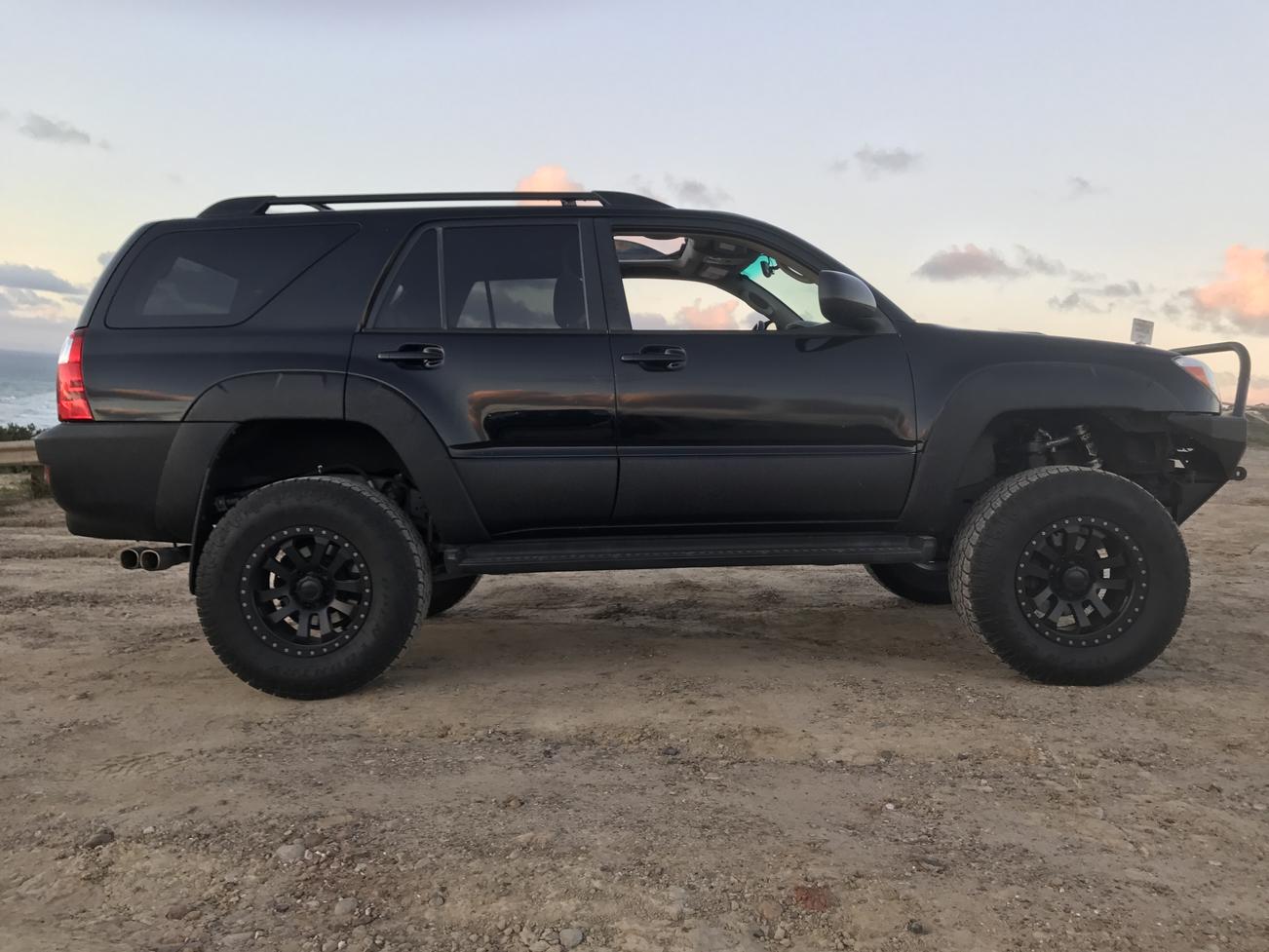

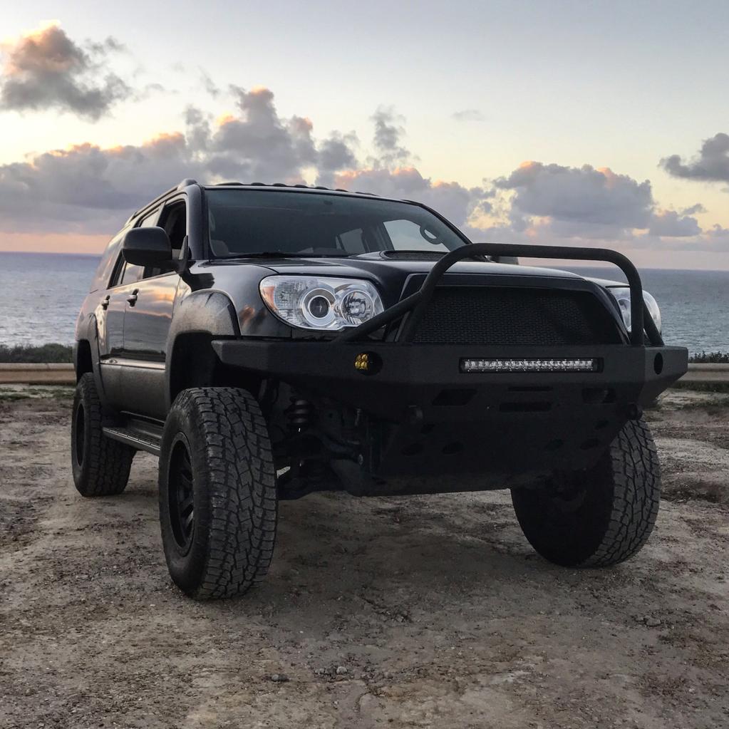

I did my cladding and my bumpers and I love it!!! just dropped off a roof rack today at line-x and will be getting my sliders done as soon as the order is finished.
i like how the line-x looks. It just has a tough, ruggedness about it that I like. It's dark black, but matte. A few buddies of mine have line-x done on their cladding, bumpers, sliders, etc similar to [MENTION=119859]grantprior13[/MENTION] did. Sick truck by the way.

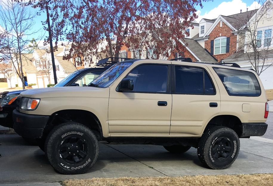

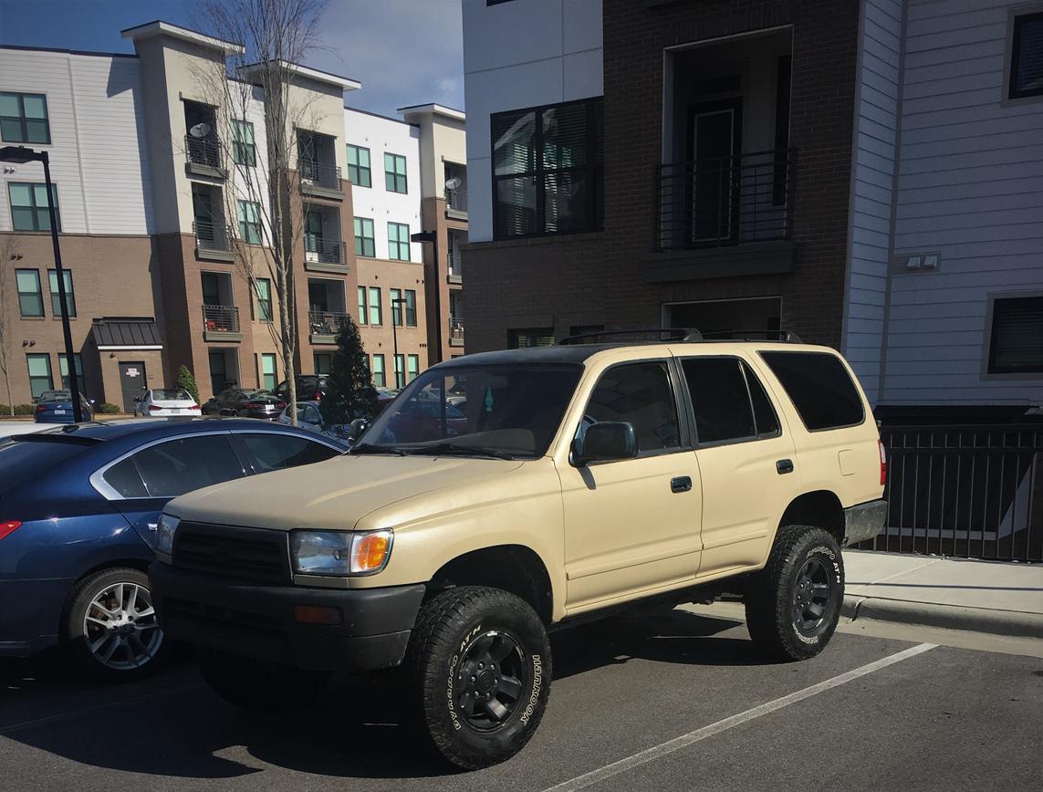

heres mine, still have a lot of touching up to do but overall I am happy with it. The Monstaliner dosen't have as rough of a texture as some of the other bed liners on the market
It all depends on how dry your roller is when you roll it on. If it starts to dry out, you will get a very rough texture.
