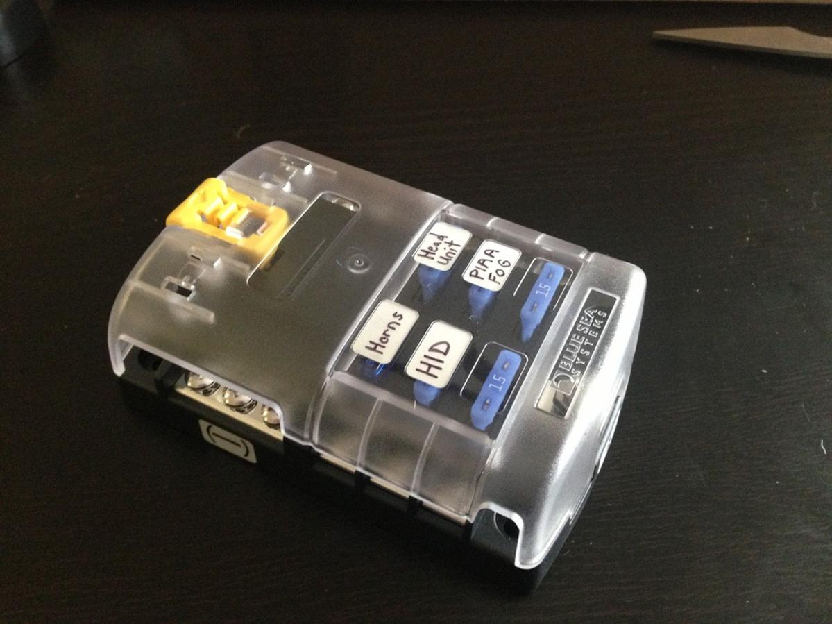

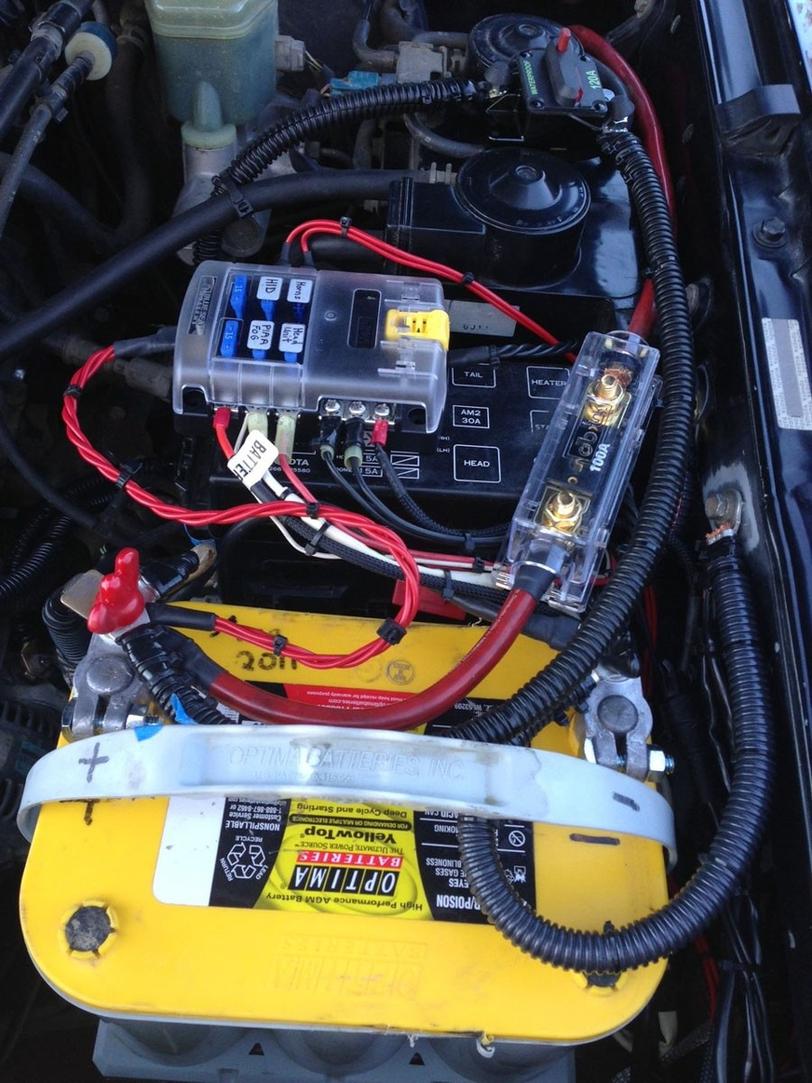

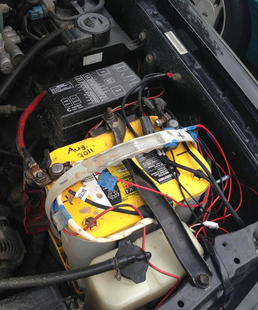

Before / After

It's a bussman waterproof with a positive bus. Makes circuits fairly easy since I can mount relays and fuses
I get all my wire accessories through waytek. Solid prices and if you want to wire stuff up right with solder and crimpers this is a great source imo.
http://www.waytekwire.com
The model number is 15303-5. You can see it in the pictures. You need special plugs for the back and special connectors for inside the back of the terminal block.
