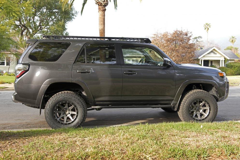

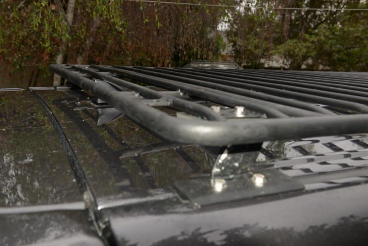

Baja Racks roof rack
I really like my Baja Racks Flat Utility Rack with cross bars (not the mesh). It sits very low without a cage or a front bar sticking up. If I'd bought a taller basket rack it would not have fit in my garage once I installed the lift. Because it's flat with no cage or front bar it's very easy to load on a canoe, lumber and other long gear.
You still have to tie things down, like you would with any rack and it's easy with the cross bars.
I had Baja Racks custom make my rack to eliminate the rear cut-out loop for the shark fin antenna and it fit very close without touching. It's easier to load lumber that way. I often have house projects on this old house that require bringing lumber home. I once had 7 sheets of 1/2" plywood on top (~280#). I added some 1/4" neoprene rubber shims at the 6 mounting points to protect the roof and add more area around the OEM plastic roof strip to the front bearing points. I found the 1/4" neoprene sheets on Amazon. I also used it for lining my wheel wells to close the gap between the body pinch welds and the frame.
The ladder is by Baja Racks too.
Baja Racks is just south of you in San Diego near the Mexico border. It would be easy for you to pick it up and save on shipping. It's completely bolt on at the OEM mounting points so there's no drilling of the roof.

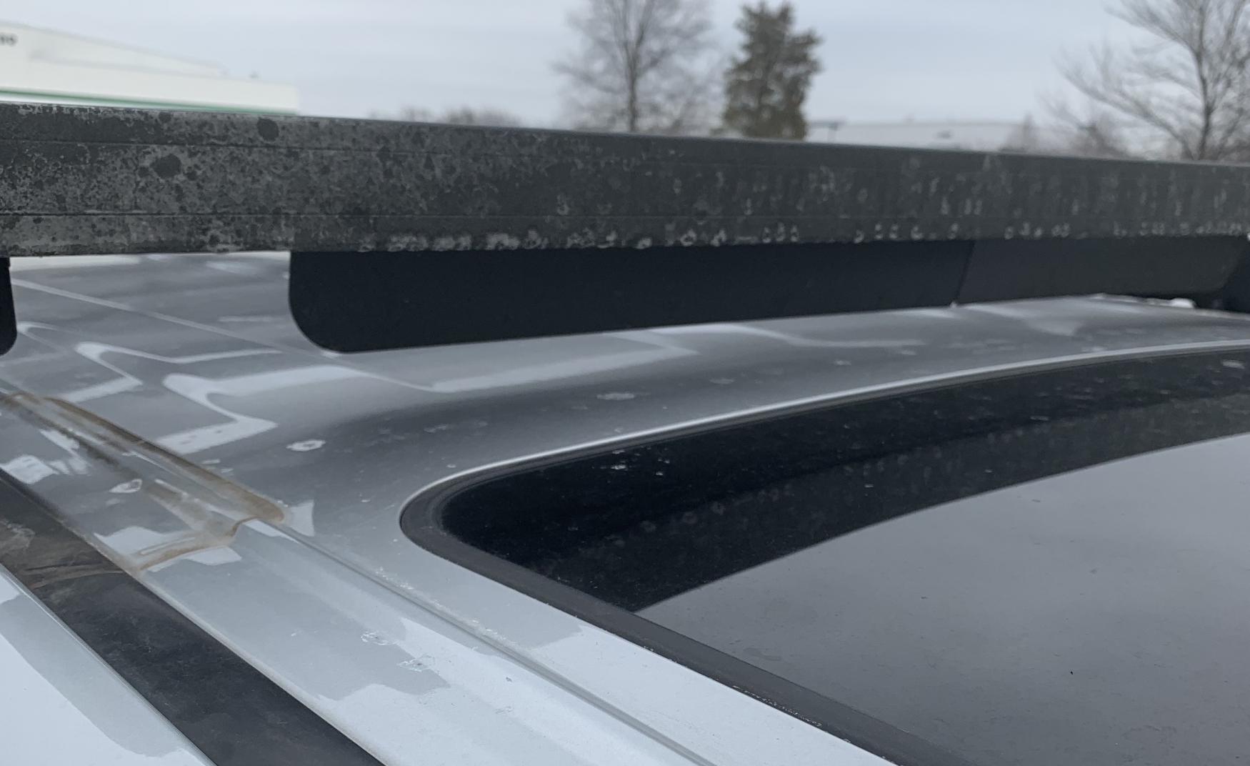

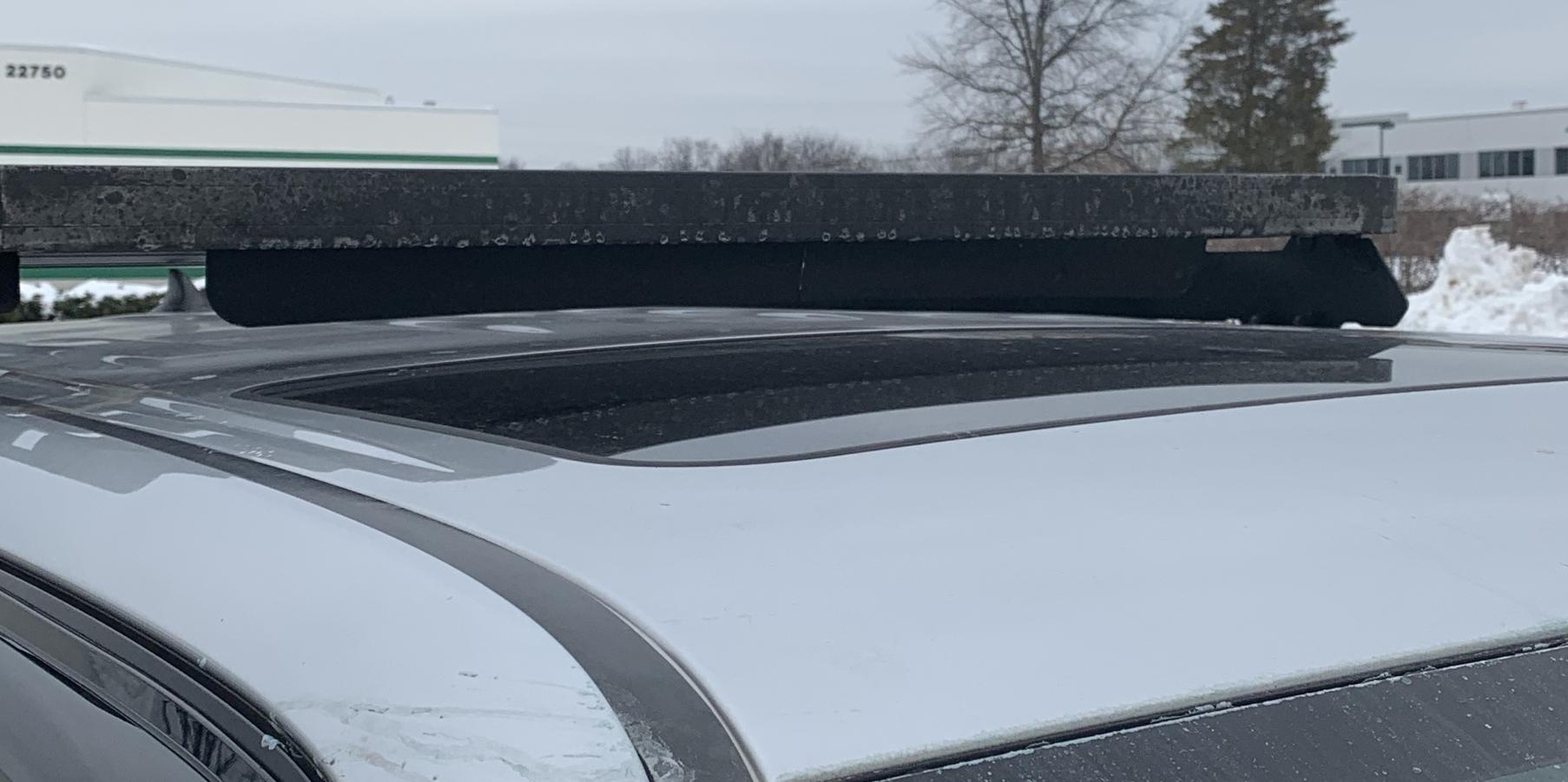

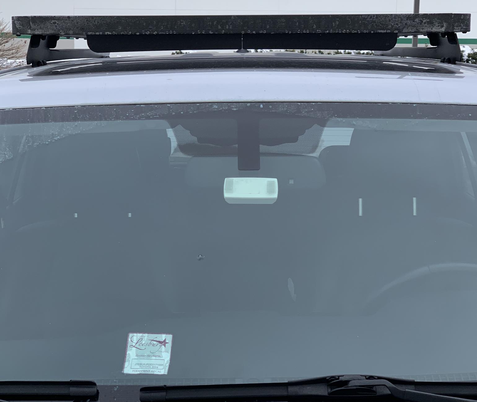

ok, I have the WIND FAIRING FOR SLIMLINE II RACK / 1165MM/1255MM(W) - BY FRONT RUNNER Product Code RRAC143
I though about getting the bigger one, the 1345-1425mm, but there are only 2 inches on either side, about 100mm total, and the fairing would cover the outside rails and stick out.
I have more wind noise at times but my mpg has risen 2-4 mpg. I have a trip tomorrow and I'll get a better idea how different the mpg's are now.
Also, don't mind the corrosion, the first picture, on the footrail...it's being taken care of by FrontRunner.

Didn’t go in the trip so I couldn’t get any trip data. I have noticed that I get around 18.5 mpg currently, 3 tanks. Without the fairing I averaged 16.9 mpg. It may be that I haven’t been using the skinny pedal as much or as aggressively.
I’m having a lift installed Monday, and my numbers will definitely change. As much as I like to save money, I didn’t buy the T4R for the fuel economy.

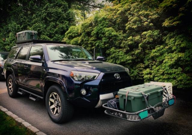

I'm a new member so I can't start a new thread, but I recently installed a frontrunner slimline 3/4 and wanted to provide my thoughts.
I am using the rack with several Plano 1919 containers, lashing each down with rollercam straps. I use frontrunner stainless steel tie down rings, bought some hardware to make more, and use the rollercam straps with the "loop" ends.
I have found this system to be very stable on a couple of 1+ hour long trips. Before I got the rollercam straps I was using paracord and found that one tie down ring was loose at the end of a trip. It was a a non-issue as I had the rings close to the box so the ring could not walk away, but it is good practice to keep the rings close to whatever you tie down. Since using straps instead of paracord no rings have become loose after a trip.
Note that I thought that the Plano 1919s came with an o-ring, but they did not. I plan to install some weatherstripping in the channel of the lids at some point.
I have attached a picture with one box installed so you can see the size. As you can see, I also have a cargo tray installed on a front hitch. I only use the rear hitch when I don't have my dog with me.
I'm very happy with the set up. Particularly how easy it is to lash things down with the rings and rollercam straps.
