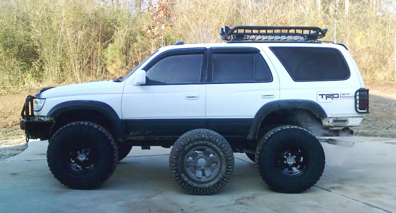

Haddix, now that I have my 35's on I need to upgrade the gearing...
Did you pull the front and rear diffs yourself? If so, where'd you get the how-to... I can't seem to find anything on the interwebs... And you have 4.88s and the auto right? And were you shocked to see how much bigger the 35 was? I was like whoa...

Well today I got the piece I needed for the snorkel. The skids are painted! I also ended up getting a 1st gen roll bar today! Oh and the new spacers came in. Hopefully the skids and the snorkel will go on tomorrow? Im just hoping. Kregg ill pm you..
