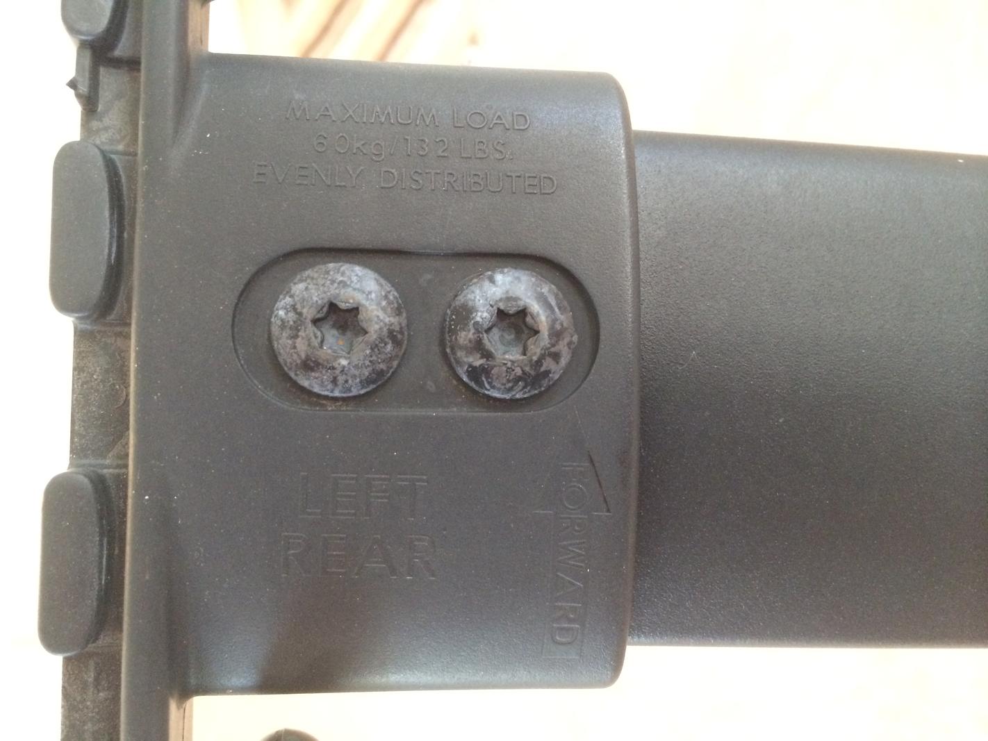

The stock cross bars (that run side to side) are rated at 132 pounds. Here is a picture I took off of mine a few weeks ago.
It seems like the stock rails (that run the long way of the truck) are fairly strong.
