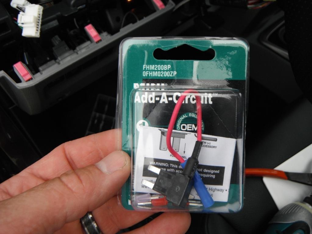

Just get a fuse tap for the "P-OUTLET" circuit in the drivers footwell and run the wire through the factory grommet under the hood.
Now you reference the P-OUTLET as being in the footwell. Is this the entry point for the wire that carries power to the center console power outlet or is it something else? You wouldn't happen to have a picture of what you're talking about would you?

It's in the fusebox. Here's a pic of the fusebox cover and a fuse tap you can use to access the circuit without cutting/splicing.
