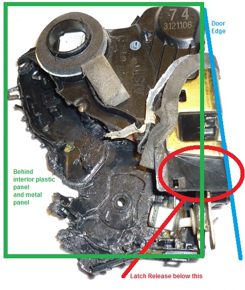

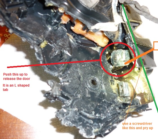

It was a huge pain to get the door open. In fact, I just finished up today because I was away for a few weeks on vacation.
Basically what I did was peel the top of the door panel back, and used a big screw driver, hammer, diagonal cutters and pliers to rip apart the lock housing until I could expose the latch mechanism (see photos) and turn it (press it up) to open the door. The whole thing was a pain from start to finish, even after I got the door ‘open’ it still wouldn’t open because the door panel was stuck on the pillar. So I had to put the door panel back just to open the door fully.
If I was doing it again, I would get a right angle drill and use a hole cutter on the metal door panel beneath the interior plastic and expose the lock. Then drill into the lock’s plastic housing right where the latch mechanism is. Once exposed, you can stick a screw driver into it and lever up the tab that controls the latch.
I attached some pictures of the lock I took out. I bought a rebuilt lock from this guy on ebay. He didn’t have a listing for our lock but when I emailed him, he put up a listing up for me. It looks like he does a good job with the rebuild and he was helpful with questions on the inner workings of the lock when I explained my problem.
Be careful with the tools. I ended up dinging up the top of the door panel with the claw of the hammer. I put a piece of cardboard on the window to protect it.
Hope this helps. Let me know if you have more questions. If you get the lock without destroying it, please open it and post some pictures. Maybe we can figure out what is failing.

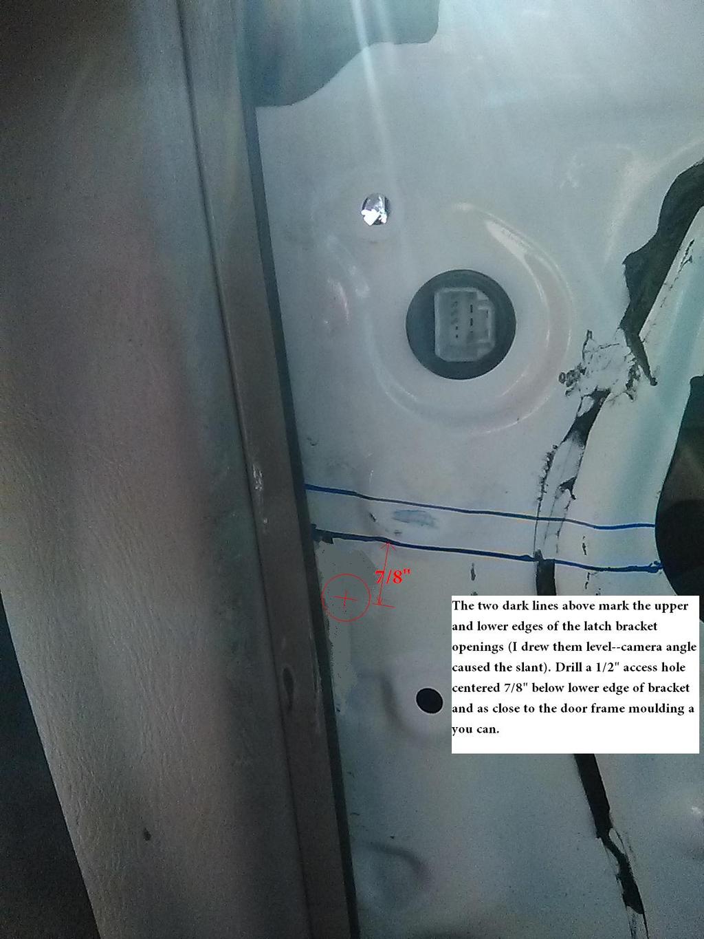

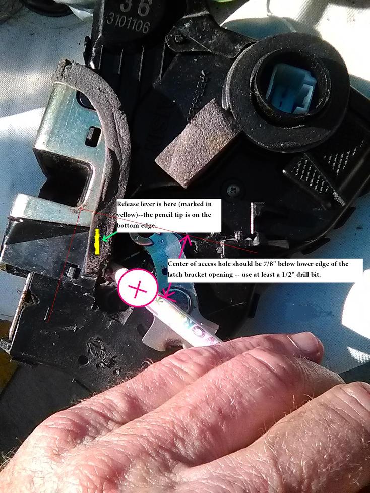

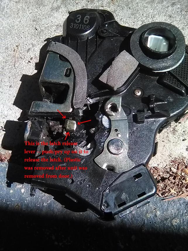

EZ fix for opening the door to remove actuator unit
OK, so I had the driver's door actuator go out on my 2004 4runner. Of course, it failed with the door closed and NONE of the yanking cables type attempts would allow me to open the door latch.
So....
1. Removed the lower back seat (optional but makes it easier to take out the front seat and sit on the floor) and then the driver seat.
2. Removed the screws from the interior door panel, pried and propped it open as far as I could.
3. Unhooked the cables from the handle unit.
4. Drilled a 1/2" access hole centered 7/8" below the lower edge of the latch opening bracket (you can see it between the door and the door post) and as close as I could to the door post moulding. This hole goes through the sheet metal and into the plastic case ~1/4". See attached pictures.
5. Stuck a flat tip screw-driver in the access hole and pushed/pried up the release lever while pushing on the door.
QED (a mathematician's version of "got 'er dun")
BTW-I deviated from the typical replacement procedures by:
1. I left the rod that is connected to the exterior handle attached at top and just slid it back into the new actuator.
2. I did not remove the window track. Instead I just unbolted it then held it in position while a wiggled the old unit out and the new unit back in.

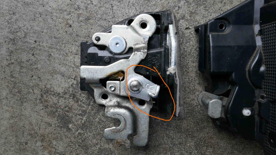

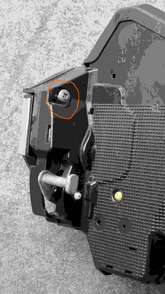

Stuck Door Fix
Instructions and photo were very helpful. I did some experimenting. I found that there is a single screw outboard and above the lever connecting to the outside handle that once removed allows the plastic casing to slide outward and off and pulled out of the door. Once the plastic body is off, the lever that unlatches the door is easily accessed (marked R in one of the pictures, lift up) . The case only has to slide a bit and you may not have to drill that hole to push it off. Accessing (and seeing) the screw though the door is tough. It is up high on the assembly facing toward the front of the car. Pictures are for a right rear door.
Bet this applies to a lot of Toyota door actuators where the door is stuck closed. There was an existing hole on the inside covered by tape that would have allowed pushing outward on the case.
