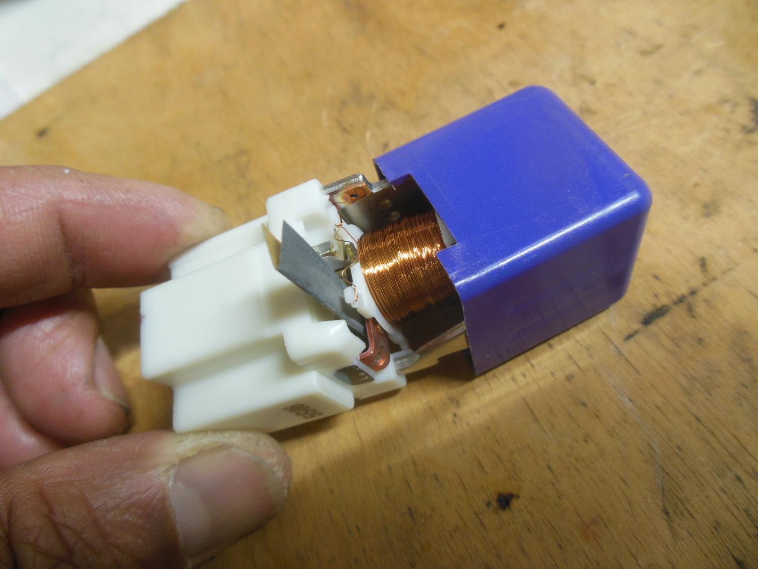

I pulled the car's starter relay and gave a good clean to its contact points by using a sand paper. I also cleaned the connector pins and installed all together and since then I DID NOT experienced the click in my corolla.

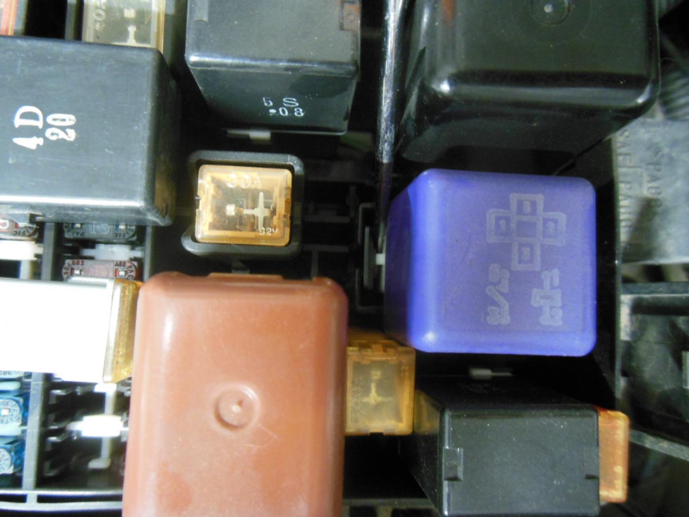

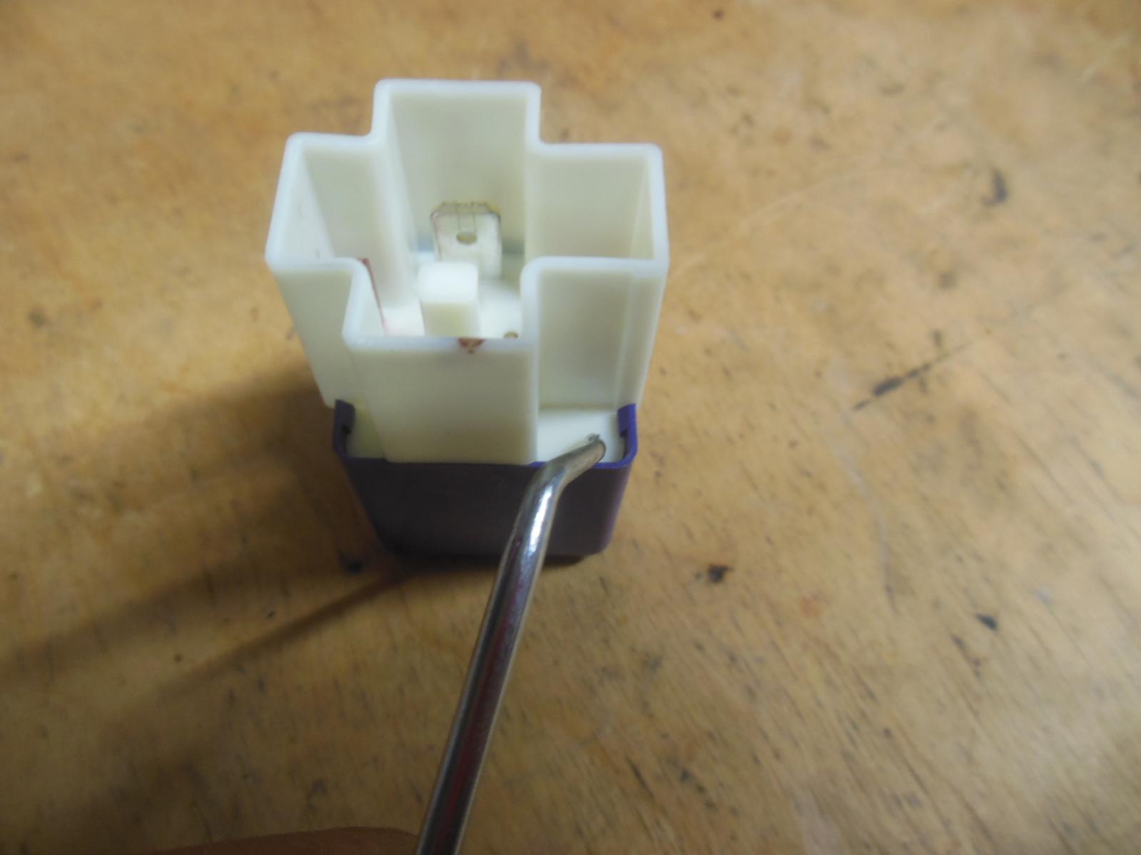

Now to 4RUNNER: (images are from 4runner: 2nd image use a pick to move the tab to pull the relay out)
I pulled and cleaned the contact points in STARTER, EFI and HEADLIGHT relays and their connector pins.
Results: No more long cranking!
This might work for you, try it as it costs nothing.
