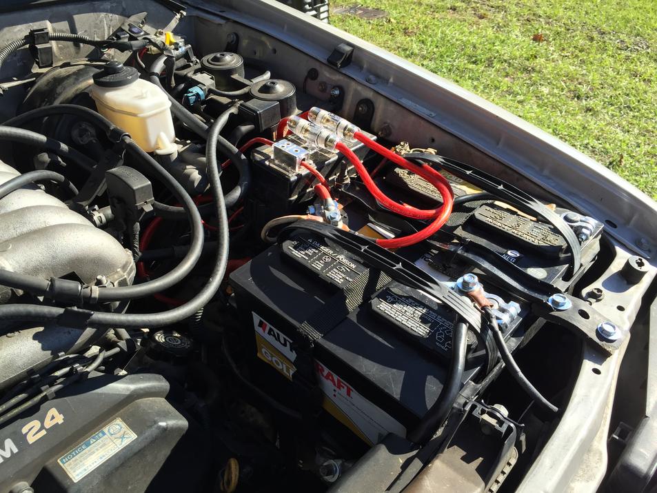

Had my set up for about 8 months and I flattened the top of the fender well a bit then added a Marine plastic dual battery tray. No issue at all. I have driven about 7000-8000 miles.
