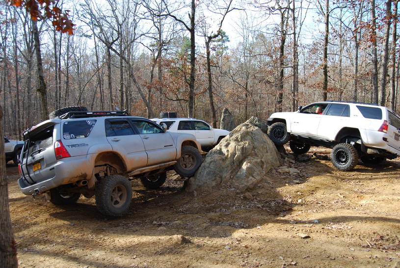

I think the Metal Tech rear long travel is the best bang for your buck when it come's to rear long travel. I've been more than impressed by this kit on the trail.I feel like i'm getting the same amount of travel as this set above if not more and i've only disconnected one side of my sway bar so far and don't have my lower links on yet which are still limiting my full travel.

Very true. I wish I had the money or skill to build one. Apparently they cant quite keep up with a setup that has a longer shock through the bed or cab, since the shock is smaller and is much harder to tune. No doubt its cool though.
Yeah the metaltech is a good option for crawling over stuff, and does give a lot of droop. The advantage to the other one is the ability to use bypass shocks, which cant fit in between the tire and frame. Im impressed with what Ive seen from the metaltech, just because they got so much out of stock mounting points.
