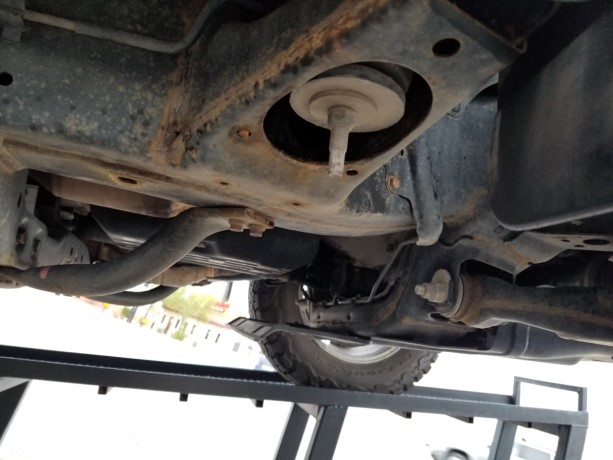

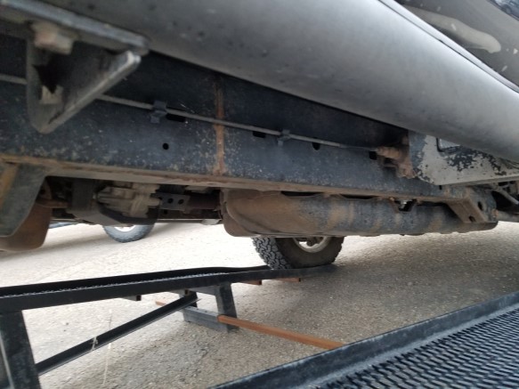

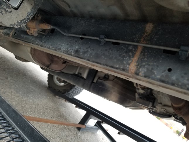

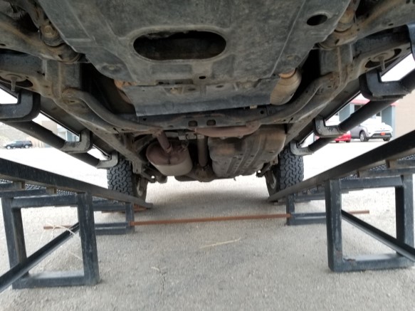

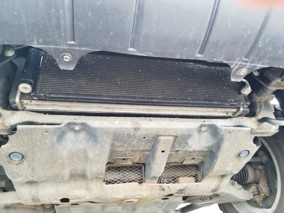

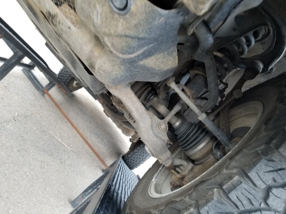

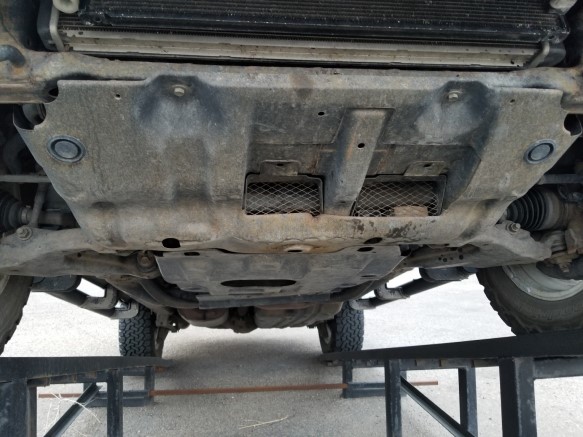

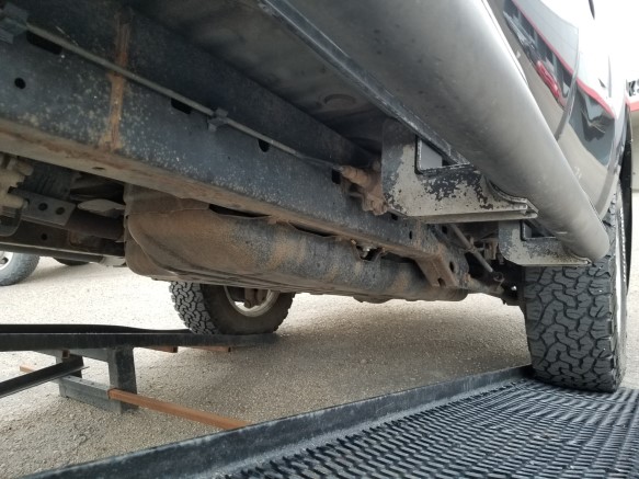

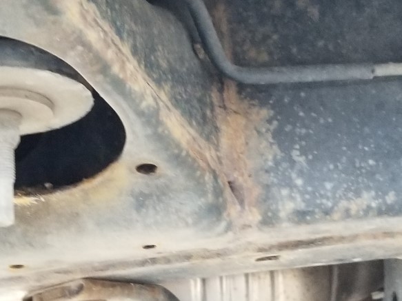

With the 2006 4 runner what should I look for? It has a 143,000 miles. How may miles should I expect out of the transmission and engine? This doesn't look like it spent much time off road. Initially, I will be using it as a commuting vehicle for 80 miles of interstate and highway, then it I will be used as a back up winter vehicle for my commute, a day trip vehicle to the mountains, and pulling a light weight atv trailer for other trips to the mountains. It has the v6. For being 14 years old it's in good shape. So far visually i saw a torn cv boot on the front. Also any recommendations on making the frame last longer? I have pictures of the frame the dealer was so kind to display it on their lifted rack. Just trying how to reduce the file size and yet make them viewable.

Does not look bad. What state are you in? Do they salt the roads? I bought my 2006 SE in February, it had 119,000 miles on it. No rust because I'm in California but the transmission had been changed at some point in its past. The vin on the trans did not match the vin on the body. So who knows? Torn boot yep. Worn out Xreas shocks yep. Clear coat on the paint coming off yep. I'm just going to fix things as they come up and have some fun with it. How much are they asking? I paid 8k for mine.
Since it's a V6 and a 2006, the one thing I would check is the "build date", it would be on the driver's door jamb VIN sticker, the early V6s are prone to head gasket failure, Toyota redesigned the head gaskets because of this issue, any build date with and after 12/05 will have the new designed head gaskets.
The frame looks good just minor surface rust, should be easily cleaned up and a rust preventive applied to prevent further rust.
You should easily get up too and possibly beyond 300,000 miles with these T4Rs if you take care of it!

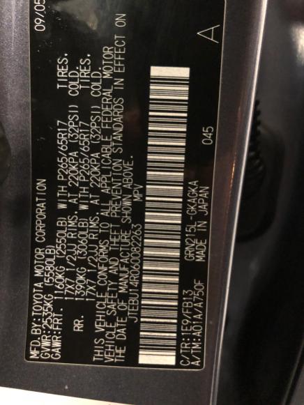

Here's a picture of the vin plate off of the door. If it has the older head gaskets how long will they last, if a person spends the money and gets them replaced will they get the new style? You would think with something like that they would have done a recall.

Top right it says 9/05, so its before the redesign. FWIW I have 210k on the original head gasket of my 05 build date 6/05. If you get it replaced at Toyota, I believe the old design was superseded, meaning you will get the redesigned gasket.
For rust, looks pretty good underneath. If you want to treat it, wire wheel or needle scale all of the crusty spots down to bare metal. Then prep for POR15 and paint it over the frame. Use paint on top of POR15 because it doesn't like uv. There are also rust converter paints available from rustoleum or eastwood. Eastwood internal frame coating is good for the inside. I'm currently working on POR15 the outside and going to eastwood internal on the inside.

That frame looks great, you shouldn't have to worry about it rusting out from what I can see. The ones up here look nothing like that. As mentioned it looks like you have the shock setup that will eventually need to be replaced with something more conventional. As for head gaskets, I'd like to see some numbers on how many fail. I'm over 200k on my originals, hopefully this doesn't jinx me. :D

The build date was almost out of the photo but as mentioned it's says 09/05 which means it has the older designed gaskets...but not all of the older designed head gaskets fail, not sure of what the percentage is....but if you get it drive it and if they do fail then replace them, no use replacing them unless they fail, that being said...yes all replacement head gaskets now sold by Toyota for the V6 ARE the newer design.

Looks great underneath..my 08 has quite a bit more rust(Canadian winters). Just make sure the 4wd works smooth. Ur golden.
1. Going to need new CV axels.
2. Going to need to remove Xreas suspension and replace shocks either now or in the near future.
