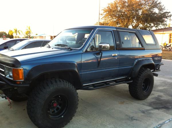

I searched all over for a 1st/2nd Gen T4R, and ended up buying mine off of eBay from a local seller. That was eight years ago, and she just keeps getting better with age.
Good luck on your search!
The above picture is of my 93 4Runner SR5 at Rausch Creek PA.
