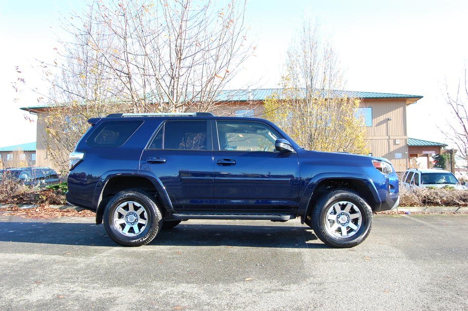

No, I have 5100 adjustable front set @ 1.75. Stock spring and everyting else in front, no front spacer. My rear has 5100's with conrfed 1" rear coil spring spacers on stock springs, the rear driver spacer is 0.200" taller to compensate for driver sidelean. Its works prefect, no drivers side lean.
Do you mind posting a pic?
Here you go.
