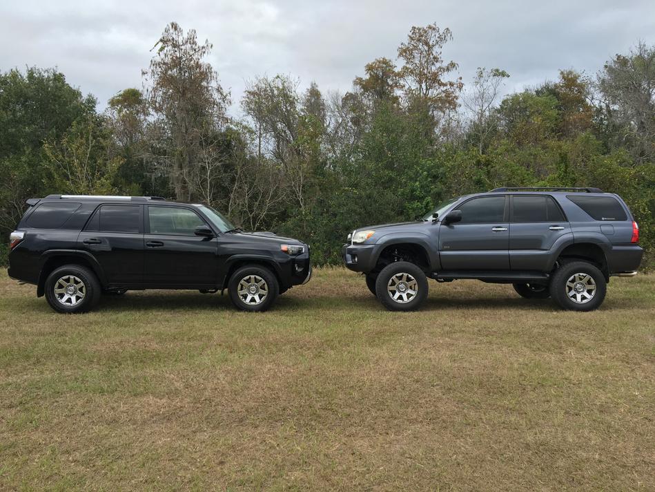

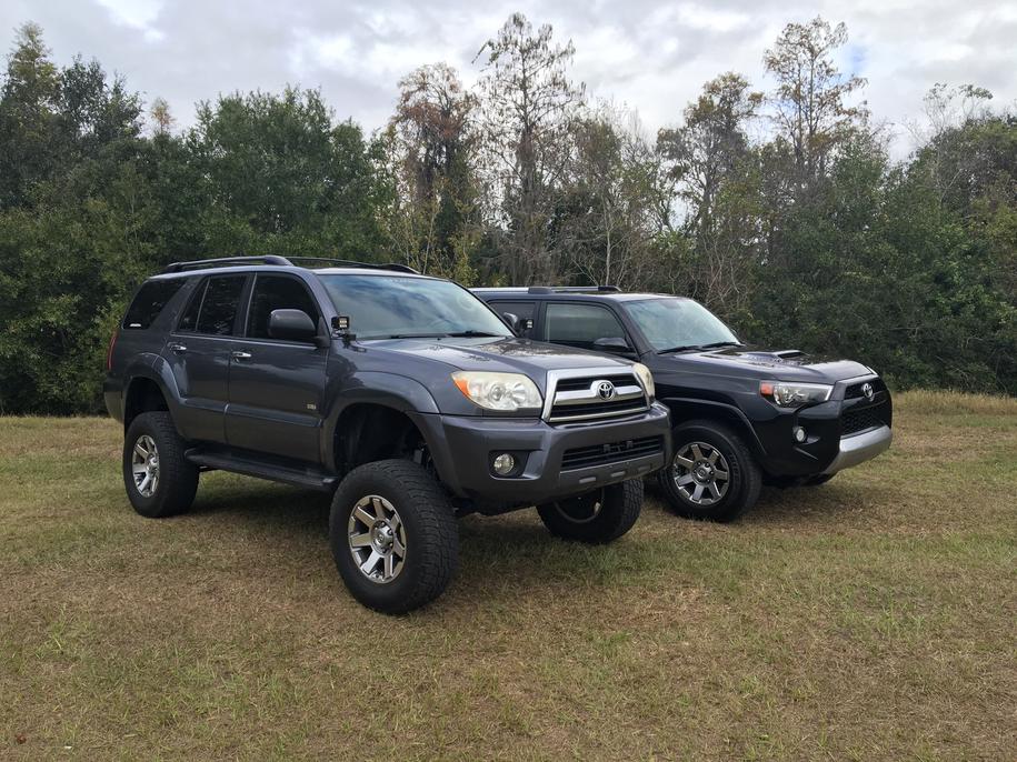

Well this first pic is with 255 bfgs and I don't think it looks bad or out of proportion...the second pic is with my new wheels and some bald 285s for test fitting..I just would like a bit more clearance hence the body lift if I'm gonna run the 285s. Or like I said leave it the height it is and go with 265s

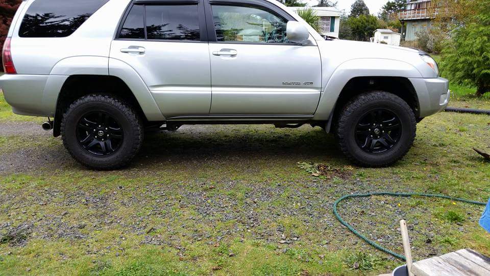

Here's the 4Runner after I installed the 1.5" body lift with my old 33's (LT285/70R17 Nitto Terra Grapplers), note that this is before I had the adjusted front bumper brackets so you see the gap there. It's running a 3" suspension lift.
This is after the bumper bracket and 35's were thrown on.

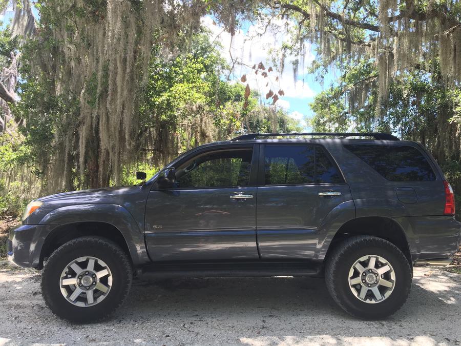

3 inch spacer lift in front, Daystar spacers in back. 1.5" body lift. 285/70 Terra Grapplers.

That looks good cloudrunner! That's what I was after I'm sure that's pretty much exactly the look I could expect with the lift I've got...what did the body lift cost you? Also how is the rubbing?
I ordered the BL from Roger Brown a few years ago. I think it was around $140 and it only took a few hours to install.
The rubbing was pretty bad at full lock, which is why I recently upgraded to spindles and an Icon Stage 2 lift with 3" overland springs in the rear.

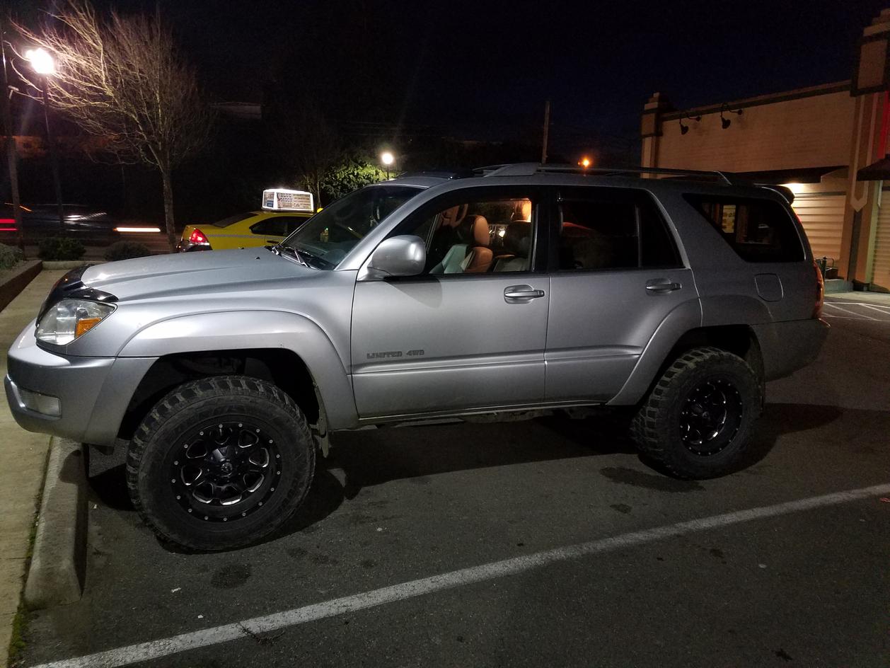

bummer I was hoping it would help the rubbing considerably...I appreciate the info man.. out of curiosity what's the offset on your wheels? wondering what kinda role that was playing in the rubbing
