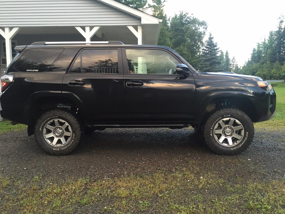

I gave my coilovers a tiny raise in the front, aiming for 2.5", so that they would be a good match for the icon 2" springs I purchased for the rear. It's a nice level stance with good rake. I am very pleased with the icon 2" springs.

Do you have any pictures of how it sits with those rear springs? Also what did you go with boots? On the bright side it's only like $75 for the shafts if you pit them up.
Here's an older pic, but it's a good example of the 2" rear springs
for boots, I just use the cheap procomp ones. I cut the bottoms off
