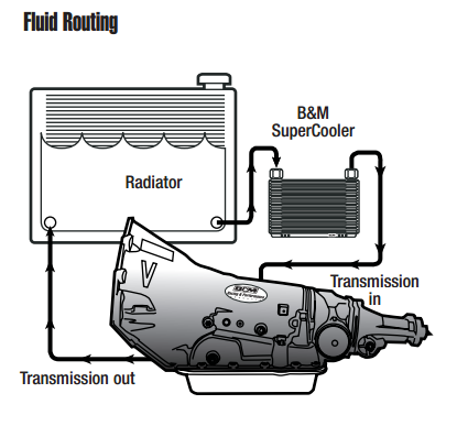

I am about to install a transmission cooler and am requesting help identifying the inlet and outlet to/from the transmission and radiator. I have tried the method of starting the vehicle and shifting through gears and feeling the hoses, but living in Phoenix, both feel the same temp to me, which is hot. I have searched the forum and cannot come to a definite conclusion which line is the inlet and which line is the outlet. If anyone has some first hand experience I would greatly appreciate the advice. Thank you.

The photo I am attaching shows the idea of the route but not necessarily the location of the inlet and outlet on the radiator

Found a definitive answer
After much digging I came across this diagram attached. If you follow the hoses and look up part numbers you can determine the driver side nipple is the outlet (return line) and the passenger side nipple is the inlet (send line). I hope this helps anyone else looking for this information.
