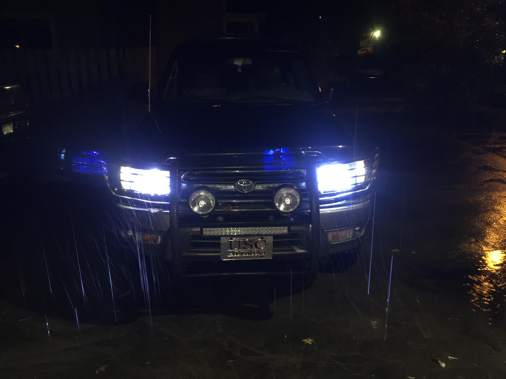

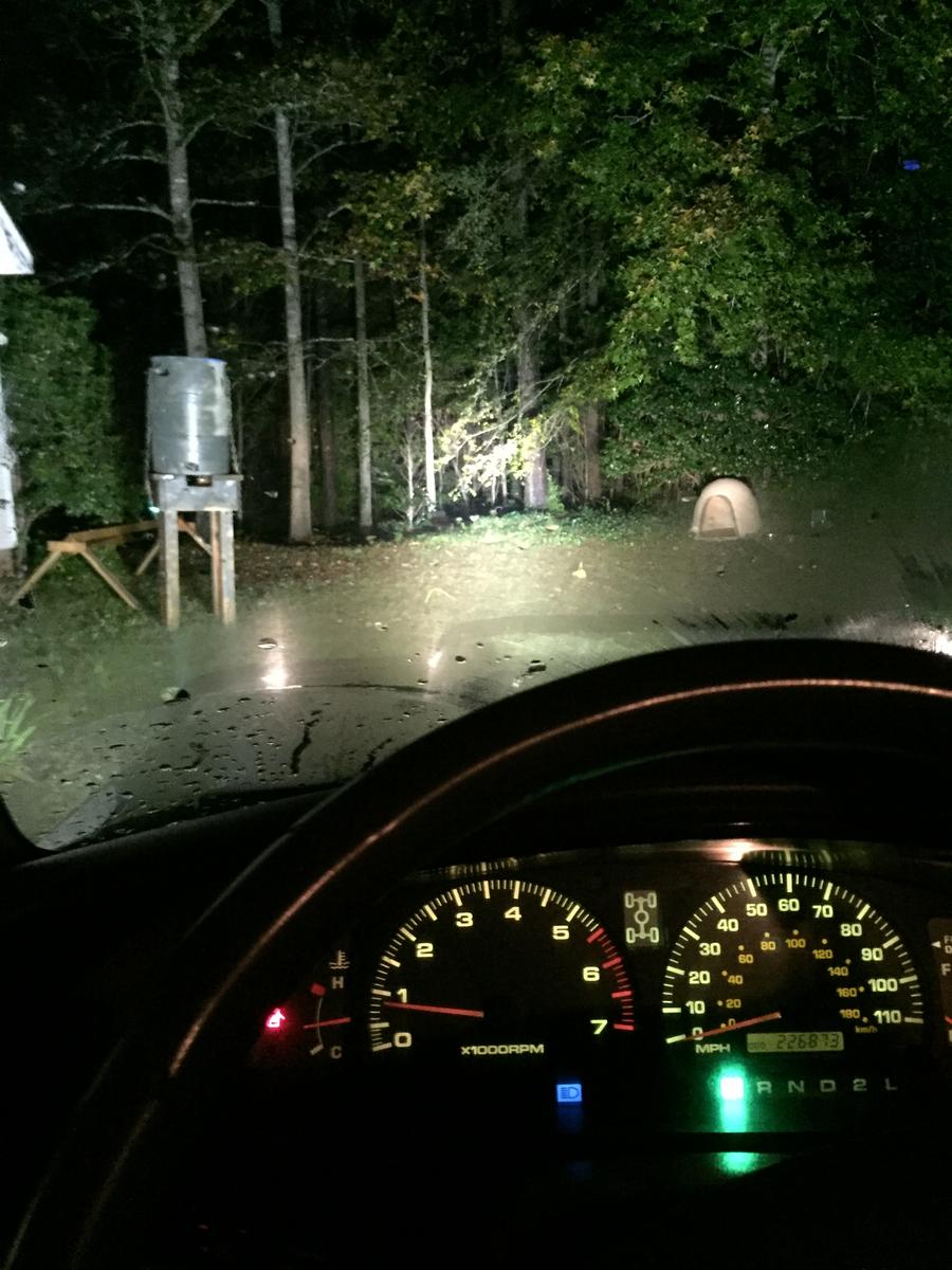

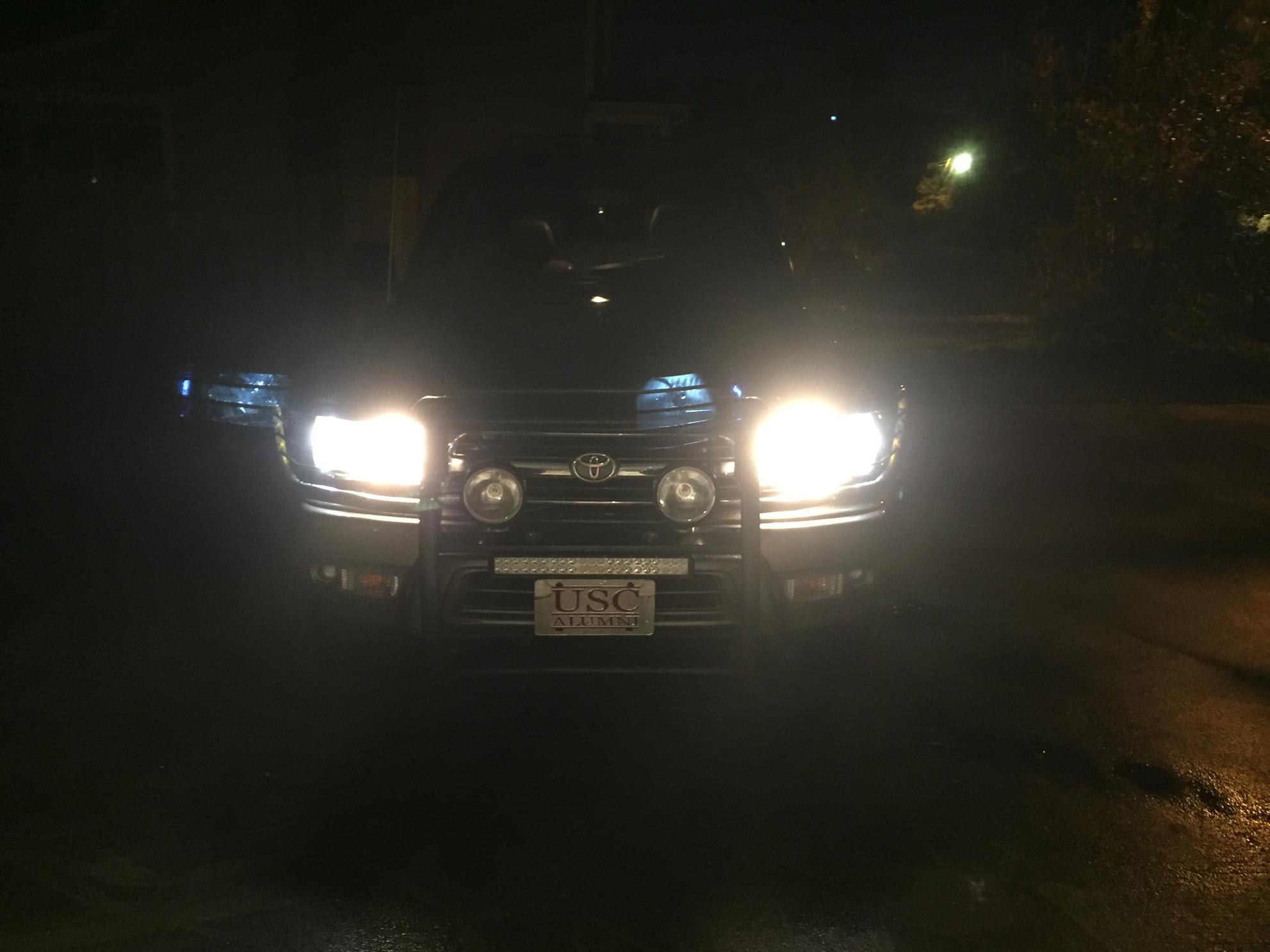

I wanted to upgraded my bulbs in my stock head light housing. I read all the forums on this website and didn't find much current information about upgrading wire harness so I thought I would join so I can share my experience.
I tried out some HID's that had halogens for the high beam.:frusty: I installed them into my stock head light housing and got some crazy reflection pattern and was not bright at all, I went with 8000k. I returned them and started looking for a high wattage bulbs but I knew I would have to upgrade my wiring harness. I couldn't find a wire harness for my 4runner, I know it has to be a ground state harness for the high beam indicator. I ended up just taking a swing at one and had to do a little modification but it worked. My high beam indicator on my dash still works too. I plan on posting a thread about it when I can, put here is the links for now:
The wiring harness is:
Headlight Relay Wiring Harness H4/9003 With High Heat Ceramic Plugs Dual High Low Beam
Amazon.com: Headlight Relay Wiring Harness H4/9003 With High Heat Ceramic Plugs Dual High Low Beam: Automotive
Bulbs:
HELLA H4 130/90W Series 130/90 Watt 12 V Halogen Bulb
Amazon.com: HELLA H4 130/90W Series 130/90 Watt 12 V Halogen Bulb: Automotive
The top picture is low beam with the HELLA's, the middle pic. is the HID's, and the last pic is my high beams showing my indicator still works.
