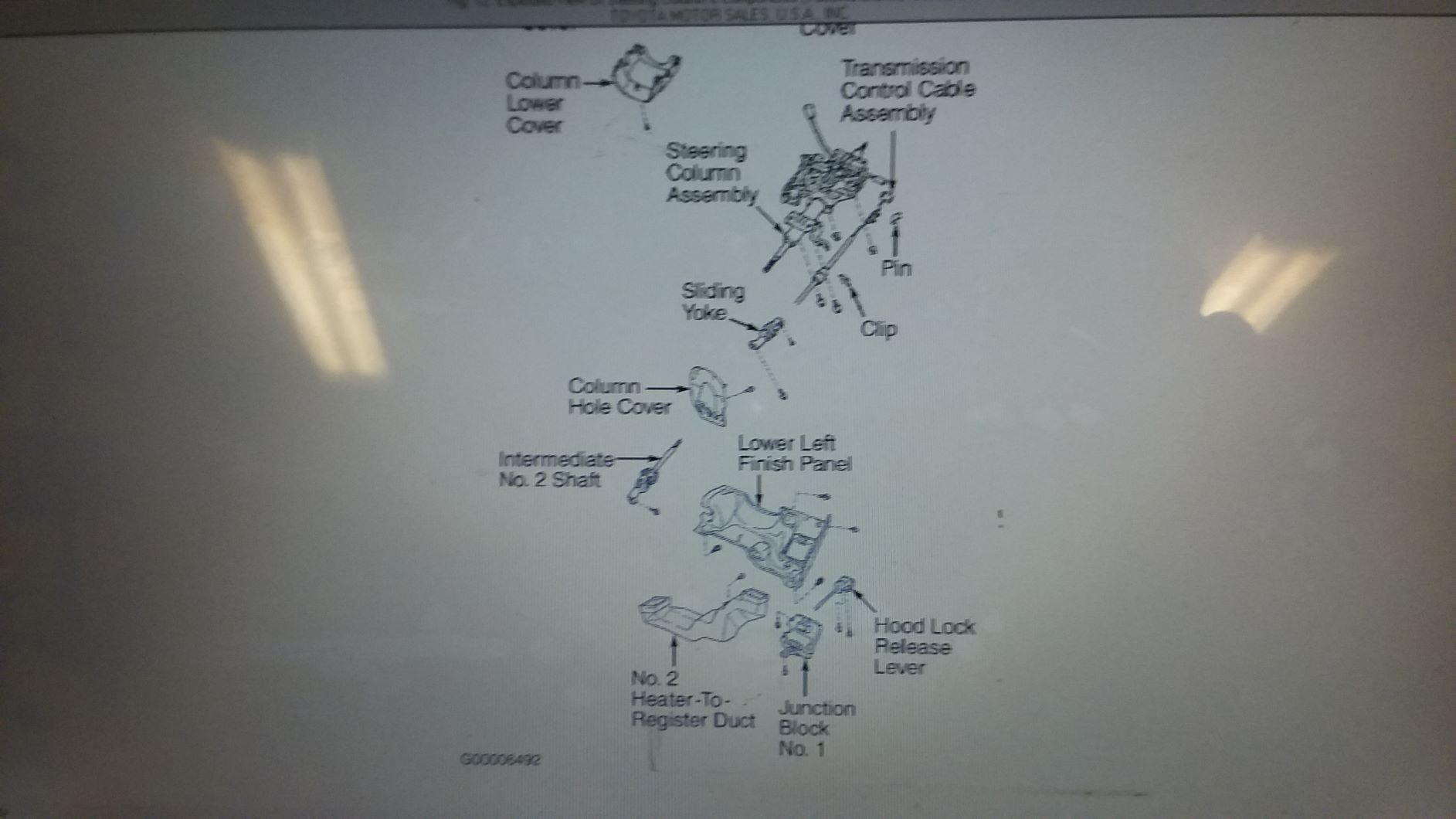

I 2nd the worn CAB but thought i would add it mite not hurt to look at the intermediate NO.2 shaft and sliding yokes and make sure everything is tight working correctly. I just replaced my intermediate NO.2 and yoke, as it was worn, because my runner had started wondering like urs.
