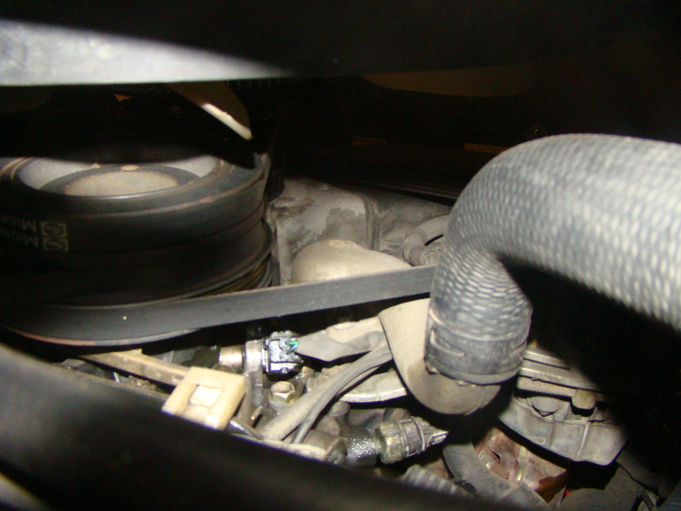

Waterpump/timing belt ever been done? Sometimes you can peer down with a light to the right hand side of the water pump shaft and see a build up of dried coolant coming from the weephole.

I replaced the radiator 6 months ago when I added an external transmission cooler. Never had the strawberry milkshake but didn't want to mess around. The ATF looks good. Oil looks good. What little coolant is left in the overflow appears to have a little dirt. No oil. The leak looks to be coming from the area where the lower radiator hose is connected to the engine block. No leak from the hose. Picture attached. This is a pic from below showing the bottom hose connected to the block. The leak looks like it comes from above and to the left of the connection.

Just saw the 2 responses for the water pump / timing belt. They were both done at ~100,000 miles. I have 185,000 now. I will take a look. Thanks for the replies.
