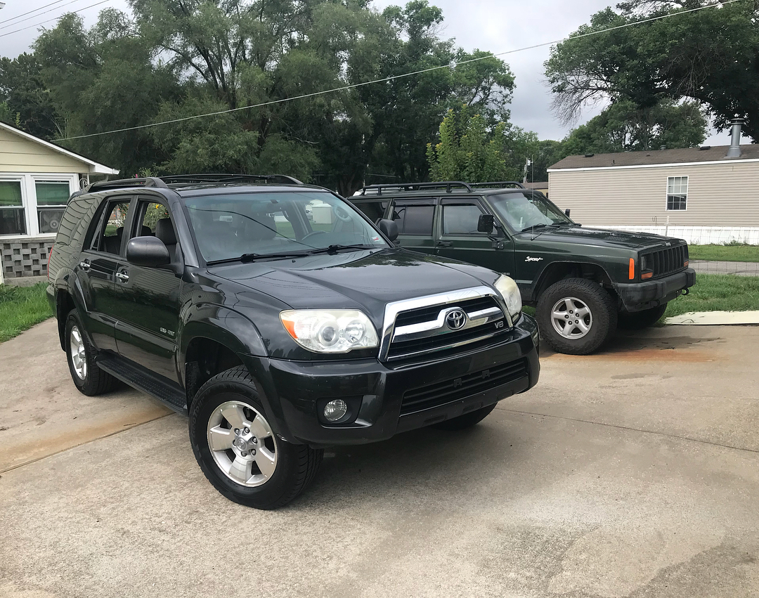

A few days ago I bought a '08 SR5 v8 4x4 w/ 162,000 miles. I love it! It is awesome! This is replacing my '97 Jeep Cherokee XJ that has been a nightmare to maintain.

Rant: I only have 1 key for my 4Runner so I went to the dealership on Saturday to get a new one made with the chip in it. They were too busy so I reluctantly agreed to come back on Monday (it's all the way on the other side of town). I went back today, but drove my old Jeep so I could drop of the Toyota key and do some shopping while they make the new key. Well that apparently was a bad idea because they needed the vehicle itself it make the key. :rant:
end rant
But while driving back irritated that its so much of a pain just to get a key made for these new dang-o-confangled vehicles, the Jeep started to run hot and got close to being in danger of overheating. And its a cold rainy day! So that reminded why I bought a new vehicle in the first place and, oddly enough, I'm actually happy that the Jeep was having problems because it made it a lot easier to appretiate my expensive new Toyota.
You see, I'm (or I was) pretty attached to that old Jeep. Driving it today, I was reminded how nimble and maneuverable it is. And sitting in it today, it's literally like an old leather glove that perfectly fits. I know right where to rest my elbows to hold the steering wheel. And I know how to quickly flip the windshield wipers to just the right setting. On the new 4runner though, I have to fiddle with them for a second and I always mess it up at first. And I'm still trying to adjust the electric seat to get the same position I had in the Jeep but it's not quite right.
Maybe its just a matter of "breaking it in," and soon it will feel like that old leather glove, and all the controls will become muscle memory. But, most importantly, the engine will run like it should without giving me so many problems.
